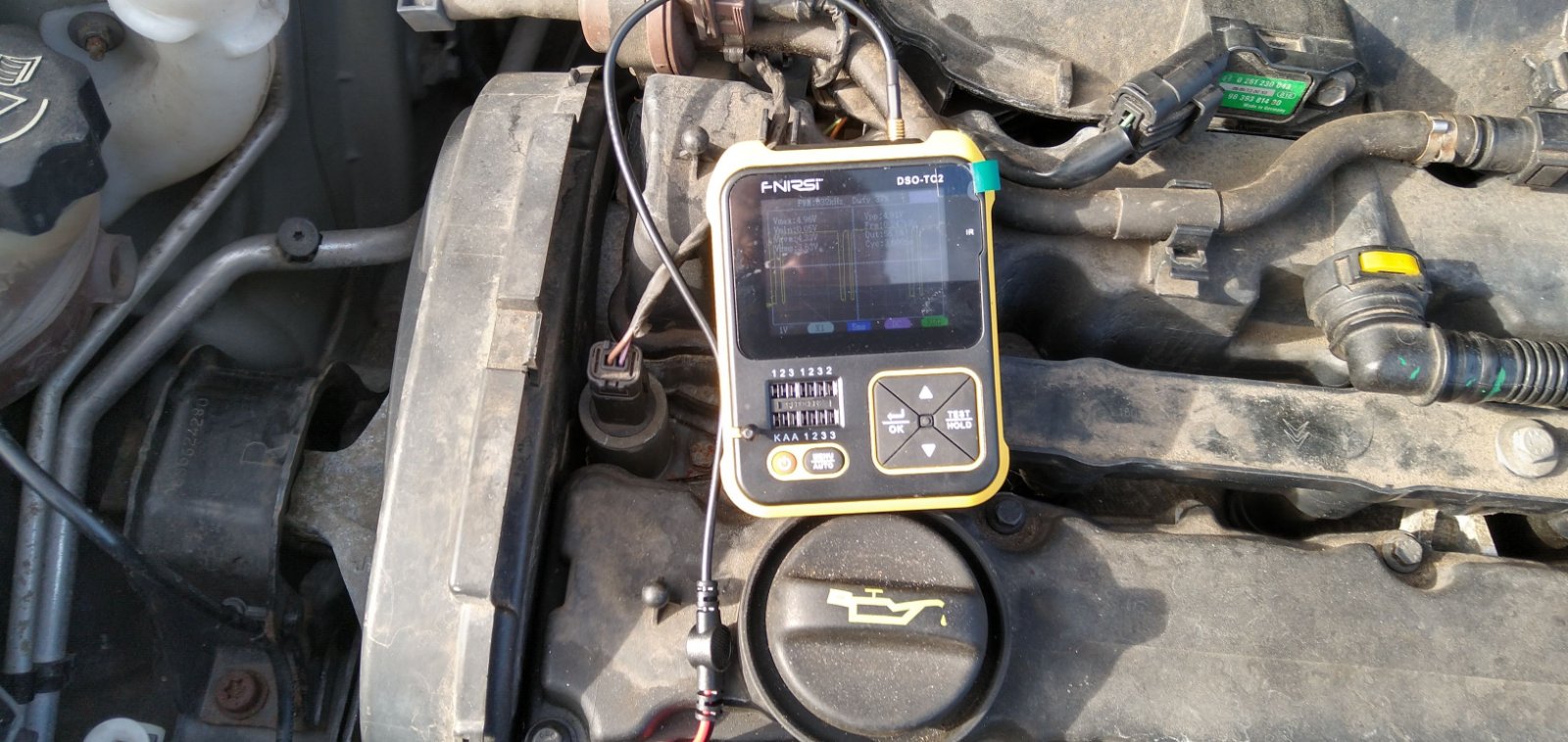

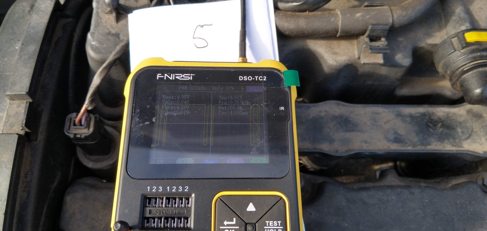

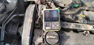

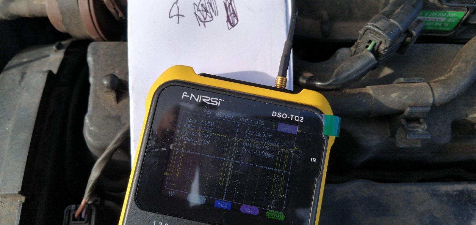

Edit: Sat 1500hrs
I did get the scope on the sensor pins and fixed the plug so it holds in firmly, cleared all faults:
Got the car started with my retro starter and took some readings.
Sensor pin3
Sensor pin 4
Sensor pin 5
I took a video too but cant seem to add it here - it doesnt show anything different from the photos though.

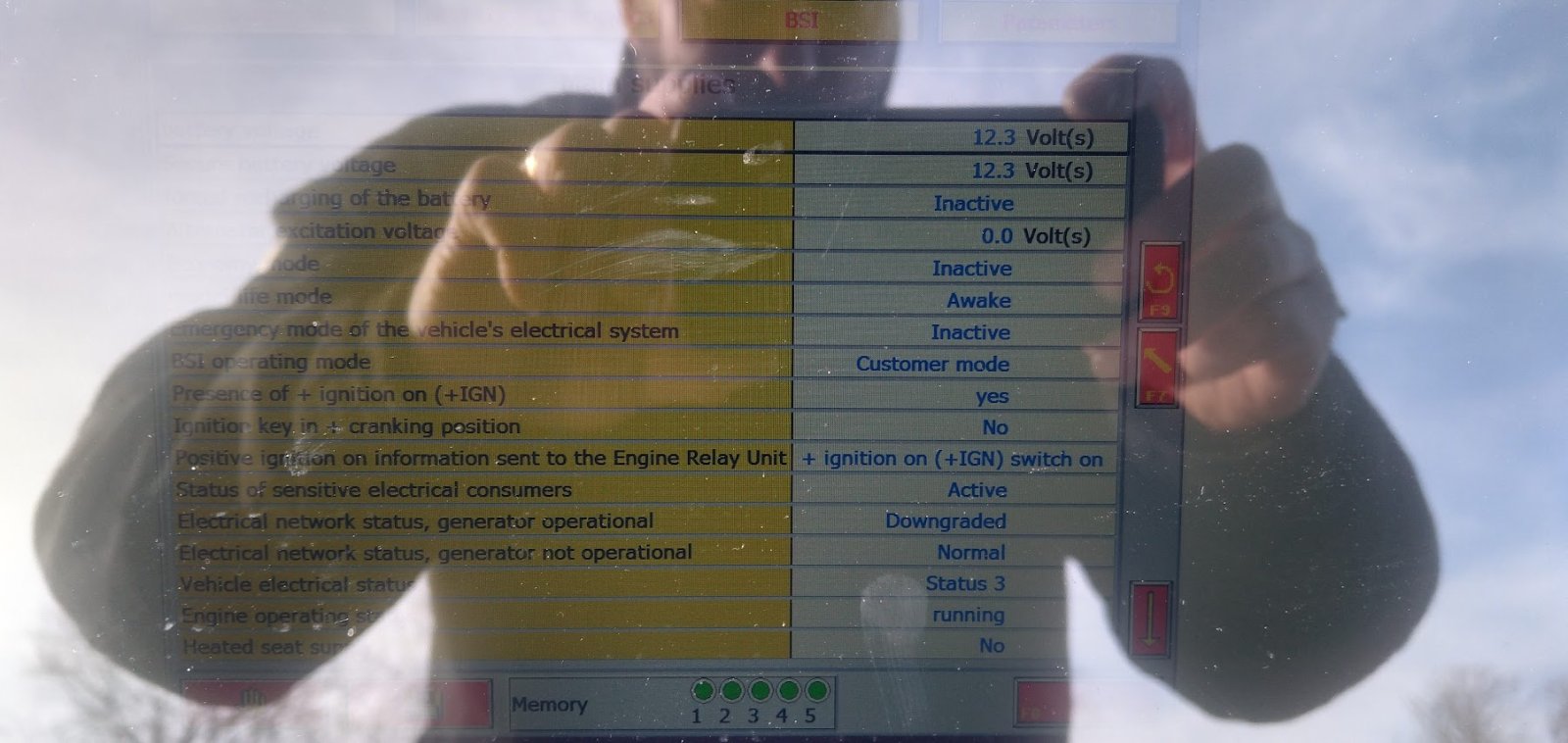

I also got Lexia watching the voltage supplies screen and the exciter voltage shows 0V (which is probably the smoking gun now)
I checked with the car running and stopped, exciter voltage was 0V either way. So the Stop Start ECU is clearly lulling me into false hopes with a 2.6v DC on the wires until its plugged into the alternator. Any more ideas on that front are very welcome

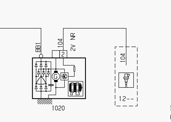

I will persevere a bit more but in the mean time I want to get my 'simple' scrappy alternator put in and prove that it can charge the battery - from the 'non stop start' wiring diagram Marc kindly put up at the start of this thread (page 1) I see that it uses pin2 to control the alternator output
Do you (or anyone) know if that is a simple 12V from some point furthest from the battery or is it a PWM feed from an ECU somewhere (basically i am looking to see where to attach that wire given I have a wiring loom for a Stop-Start car, not the normal layout (my engine is the 1.4 ET3J4 KFU petrol 90hp seen in a few different models -c2,c3,207 etc shows as Injection ET3J4 in sedre) - My SEDRE wiring diagrams doesn't display anything for this C3 though (rpo 11680) but it does display wiring fine for my other cars.
If i left that pin 2 off, what would be the consequences for a short test of charging (will it destroy the battery?) Is that pin 2 actually the exciter voltage (it doesn't look like it from the diagram but I'd prefer someone with more experience to confirm that please).
Cheers.

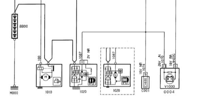

On a 206 (same age and engine and same component for alternator according to DocBackup) the wiring is:
On that one, pin 1 is coming from the battery light indication (or so it seems as i followed it back to the ignition key switch in the diagram) - Am I being daft or does that suggest, the scrappy alternator is self exciting, and the pin 1 just controls the battery light on the dash, pin 2 can be used by the Engine ECU to control output but not entirely essential?

kingjafad wrote: 11 Mar 2023, 07:49 Edit:
The single wire is only for a "charge fault"(alternator fail). Pin 1 is for an "old school" lamp. Pin 2 sends a fault signal to the engine ECU and the engine ECU sends out a "fault message" on the CAN BUS. The alternator on the right is the old school version, left is the new version. However I'd like to get my hands on the Valeo electrical engineer who signed off on a charge fault circuit that doesn't detect a charge fault!! :lol: Or the lazy SOAB that couldn't even put in 1 extra LED for ECO mode??!! Lets just confuse every body and have the battery light flash!! Um..sorry...rant over.
Bummer. Looks like all three rotation detectors are working. The two pulses might be because of the change in polarity of the magnetic flux. It doesn't matter, it still looks good to me.
So why is the ECU complaining about a failed detector? Did you back probe the stop-start ECU end of the loom? Inspect the connectors at the ECU end?
