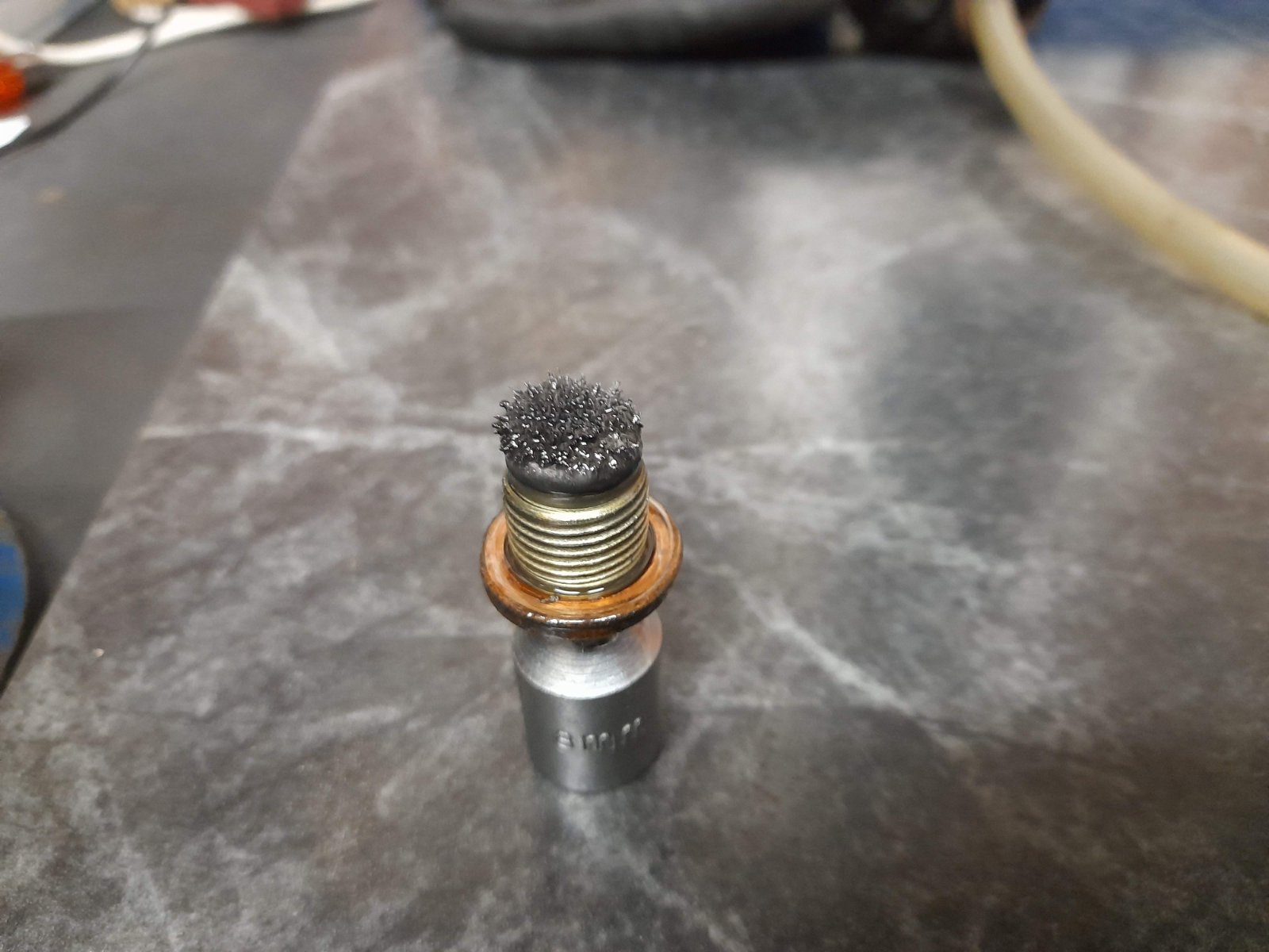

Wow, that would worry me! How many miles covered when that taken?
Have you had need to drain it again since, any more seen second time round?
- Posts: 55172
- x 8437
Re: Time to change gearbox oil?
No idea Matt but knowing the history of the car, likely at least a decade... I changed the oil as I could hear a low whine in 5th and wanted to exclude the oil. Bluebell is currently on nearly 91,000 miles... Looking at the driveshafts and so on for clues, I'd say the old oil had likely done a good proportion of that...MattBLancs wrote: 15 Feb 2023, 09:01 Wow, that would worry me! How many miles covered when that taken?
As it happened, a change of fresh oil made no immediate difference but it has since reduced although not gone completely... Whether new oil is a factor I don't know
The old oil looked, felt and smelt good and fresh...
Not yet. In my experience, that's about a normal amount of swarf...MattBLancs wrote: 15 Feb 2023, 09:01 Have you had need to drain it again since, any more seen second time round?
Back in the day when I ran transverse engined gearbox-in-sump BMC Minis, 1300s and Metros I used to see more swarf than that on the sump plug magnet at every oil change and I used to change it frequently...
