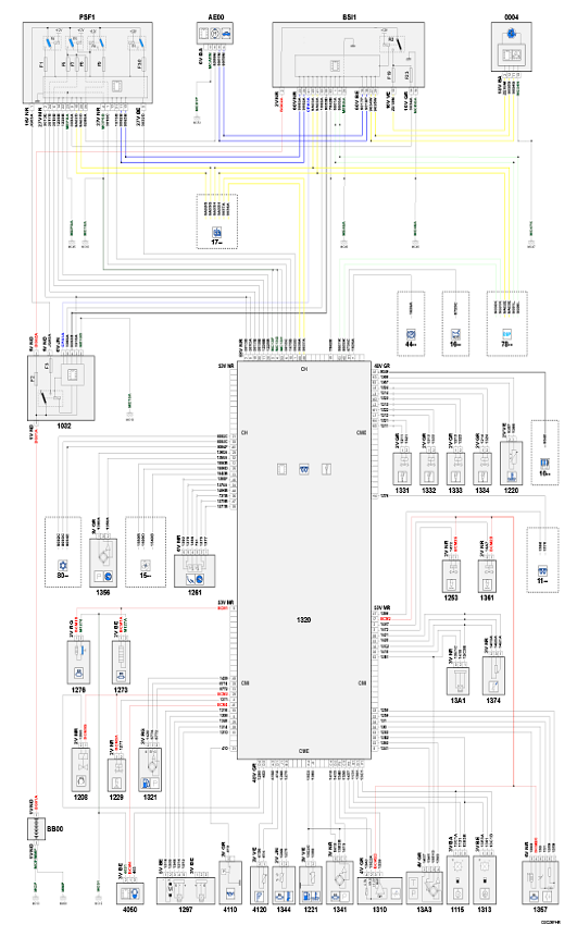

I don't have a high resolution one for the Electronic Injection Circuit for this Vehicle, sorry. I can only provide a poor image on this occasion, but you can magnify it up slightly by clicking the image.
DS5 engine is stopping with main relay errors
- x 6954

Re: DS5 engine is stopping with main relay errors
Thank you, I will try to zoom in. I need to find the supply connections and to follow their route.GiveMeABreak wrote: 20 Feb 2023, 10:04 I don't have a high resolution one for the Electronic Injection Circuit for this Vehicle, sorry. I can only provide a poor image on this occasion, but you can magnify it up slightly by clicking the image.
