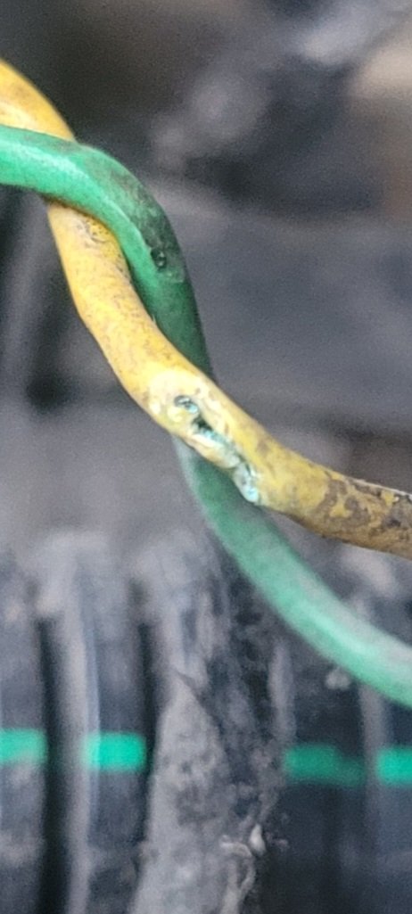

Could this be giving the car all these gremlins?
This is just as the cable trunking goes over the rear axle. My mext question is.... Where can I find this section of wire new?

Absolutely it can!
Well found. For these sorts of issues, Citroen just recommend an in-place repair. This looks like it has been rubbing and worn away the insulation. I would make a decent secure repair and then afterwards encase it in some of this protective tubing which can be had in various sizes that you can just pop over it to protect it.

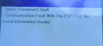

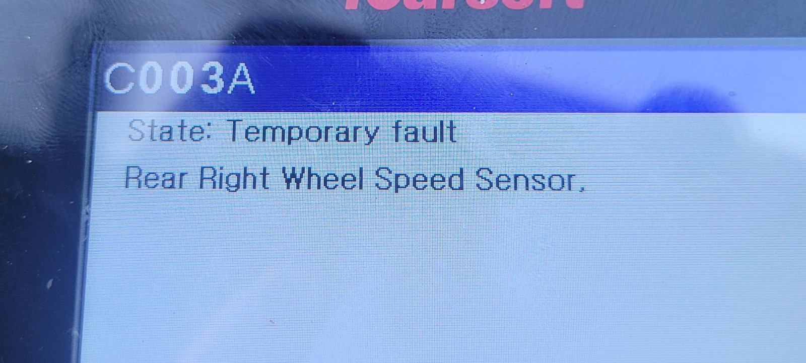

The ABS module still points to the rear right speed sensor and non confirmationof engine torque, with one difference. It comes up as a temporary fault that I can clear now. I wasn't able to before! (Picture attached)
The same with the comunication fault in the Engine ECU I am able to clear it, but not before the repair.

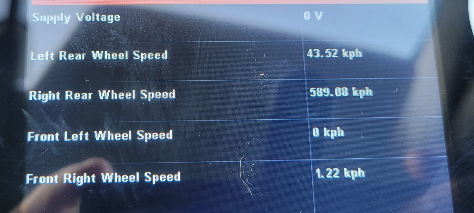

The sensors are still showing different speeds when stationary. (Picture attached)

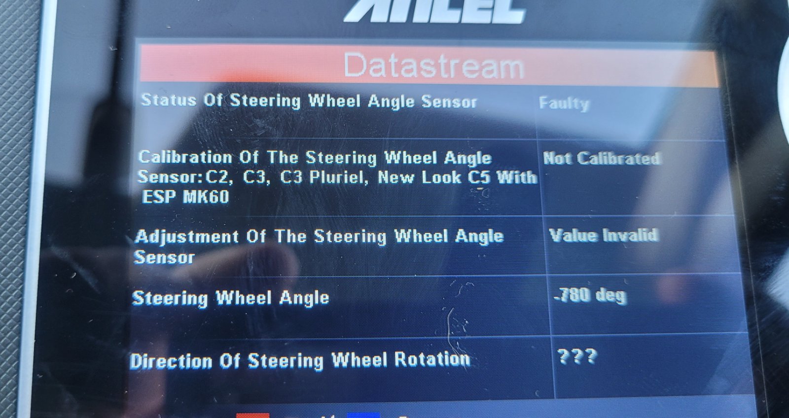

The steering angle sensor is still wrong too. (Picture attached)

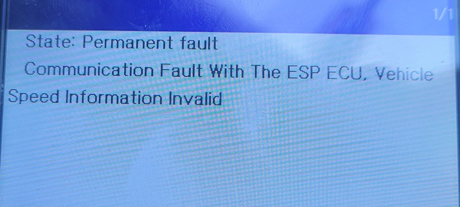

Took the middle seat out to gain access to the wiring under the carpet. Tested continuity between plugs, all fine! no further brakes in this section anyway! Other than changing the sensor again and the hub, I have gone as far as I can with this myself.
The diagnostic says for ABS. C003A. Rear right speed sensor. Temporary fault. C2391 Engine torque not cleared. Temporary fault. I can clear both these. I cannot clear the invalid speed information code in the steering ECU.

I thought that with the abs being on it’s all linked hopefully, new hub fitted and repair to wiring slough maybe not the best as I’ve just looked at that myself,
C003A rear right wheel speed sensor
Permanent
U029D fault in communication with DeNox system
U1213 fault in communication with the abs/esp ecu
U3FFF high pressure fuel circuit
