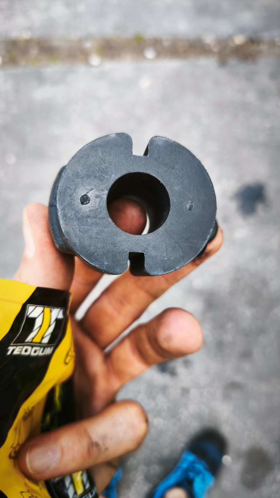

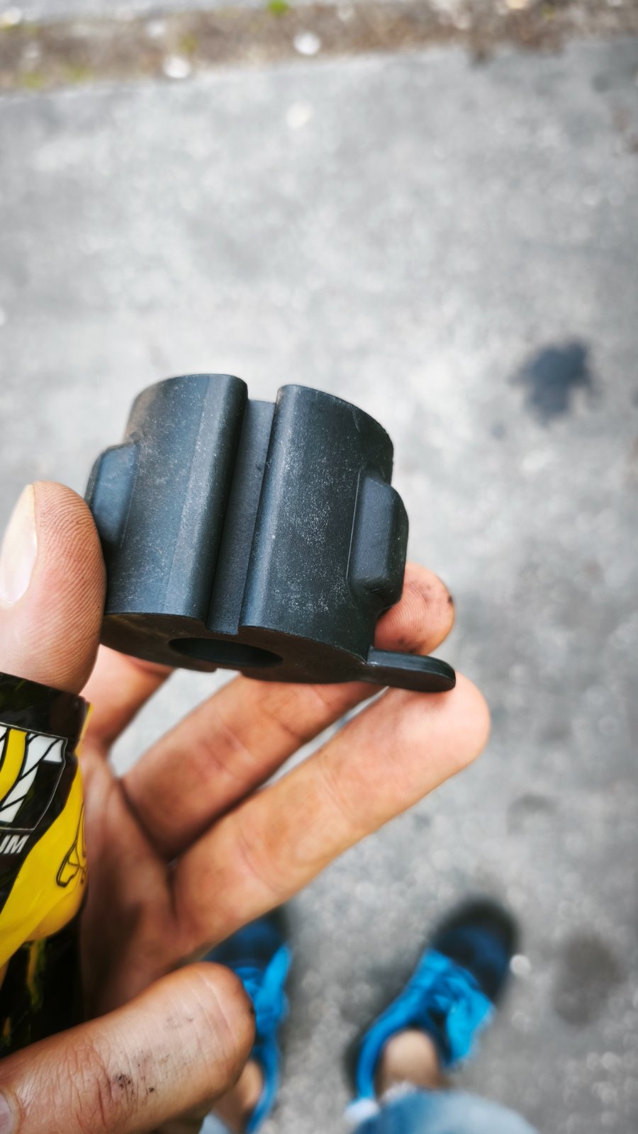

Quick update
Sadly the bushings are not the correct ones. The inner diameter is 29mm and they are too big for the anti roll bar - in my case 21.5mm.
Probably the best route for now is to research for custom poly bushes.

Re: C5 X7 Rear Anti Roll Bar Bushings
Thanks for feeding back and sorry to hear it's bad news. I will check mine before ordering anything (Have to say 29mm sounded very thick, but not measured mine yet so was unable to confirm or deny it was correct)Loopebg96 wrote: 20 Jan 2023, 18:59 Quick update
Is the outer form of the new bushes correct? If so then is potential it could be sleeved down from 29 to 21.5, perhaps with a piece of nylon turned to suit then a slot cut in it for fitting. If really lucky maybe something commonly available could provide the raw materials.
21.5mm is outside diameter of plastic overflow pipework. I'll see if I have any solvent weld overflow fittings and measure what their outside diameter is. 29-21.5 = 7.5mm difference in diameter, 3.75mm thickness = may be more than could be hoped for this route, but will check (likely tomorrow morning, need to remember where I might have buried that stuff in the garage!)
The outer form is also not the correct one and I’m not sure if it could be trimmed. As for the original ones they are one piece and you have cut them off to be replaced.MattBLancs wrote: 20 Jan 2023, 20:27Thanks for feeding back and sorry to hear it's bad news. I will check mine before ordering anything (Have to say 29mm sounded very thick, but not measured mine yet so was unable to confirm or deny it was correct)Loopebg96 wrote: 20 Jan 2023, 18:59 Quick update
One idea I got is to take measures of the current ones and to cross reference to find a close replacement via this website -
https://size.name/en/catalog/vtulki-stabilizatora
Will update promptly if I find a suitable solution!
Cheers!
Ah ok, if wrong on inside and outside then as you say they're not worth persisting with.
That's a cracking website, love stuff that lets you cross reference.
On the polyurethane bushes front, am sure Powerflex website, "universal" range was quite good at search by dimensions. Will try and dig out a link.
