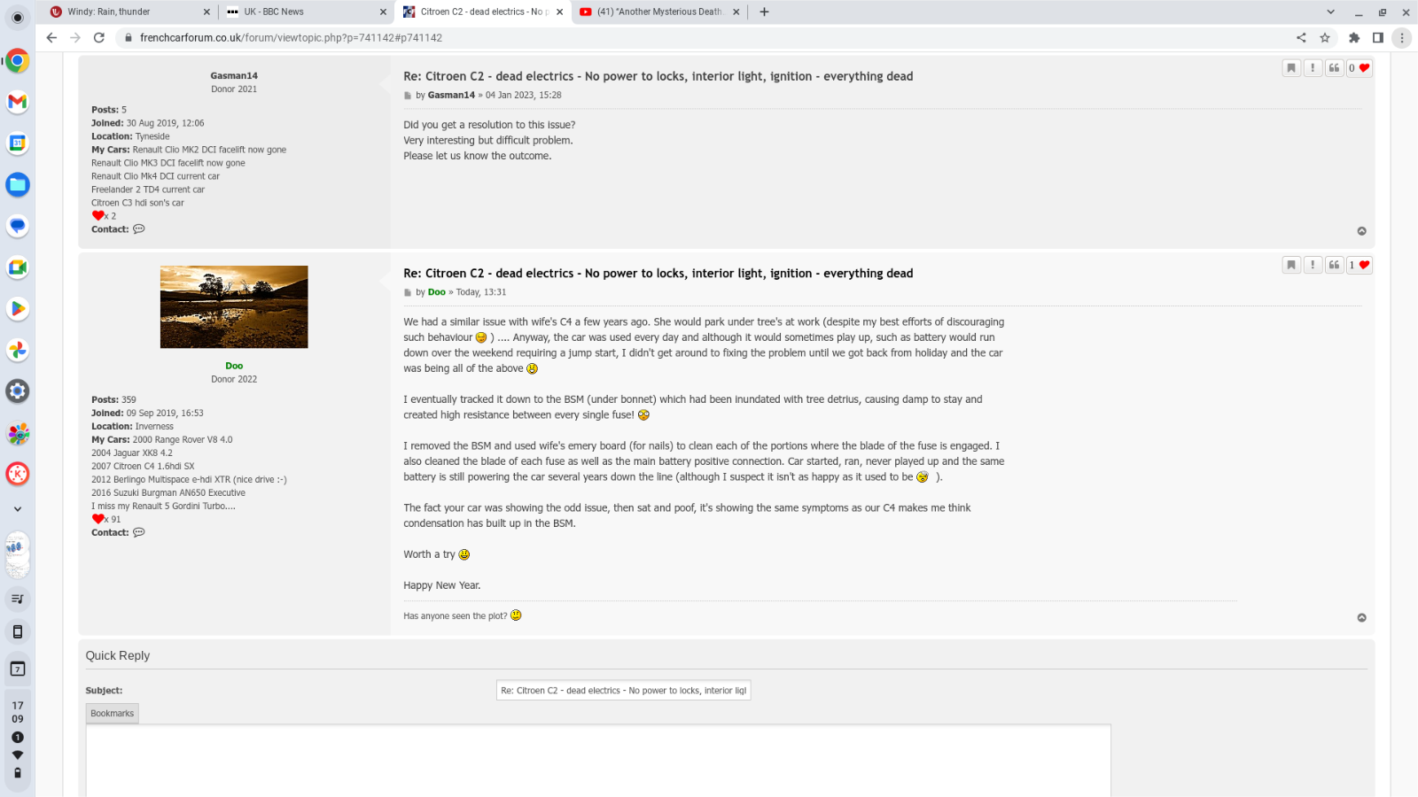

Dormouse
Posts: 2145
Joined: 15 Apr 2021, 14:32
x 696
Re: Battery Light on C4
Unread post by Dormouse »
I found this interesting

Hi I will have to get some of that emery boards and try it thanks.

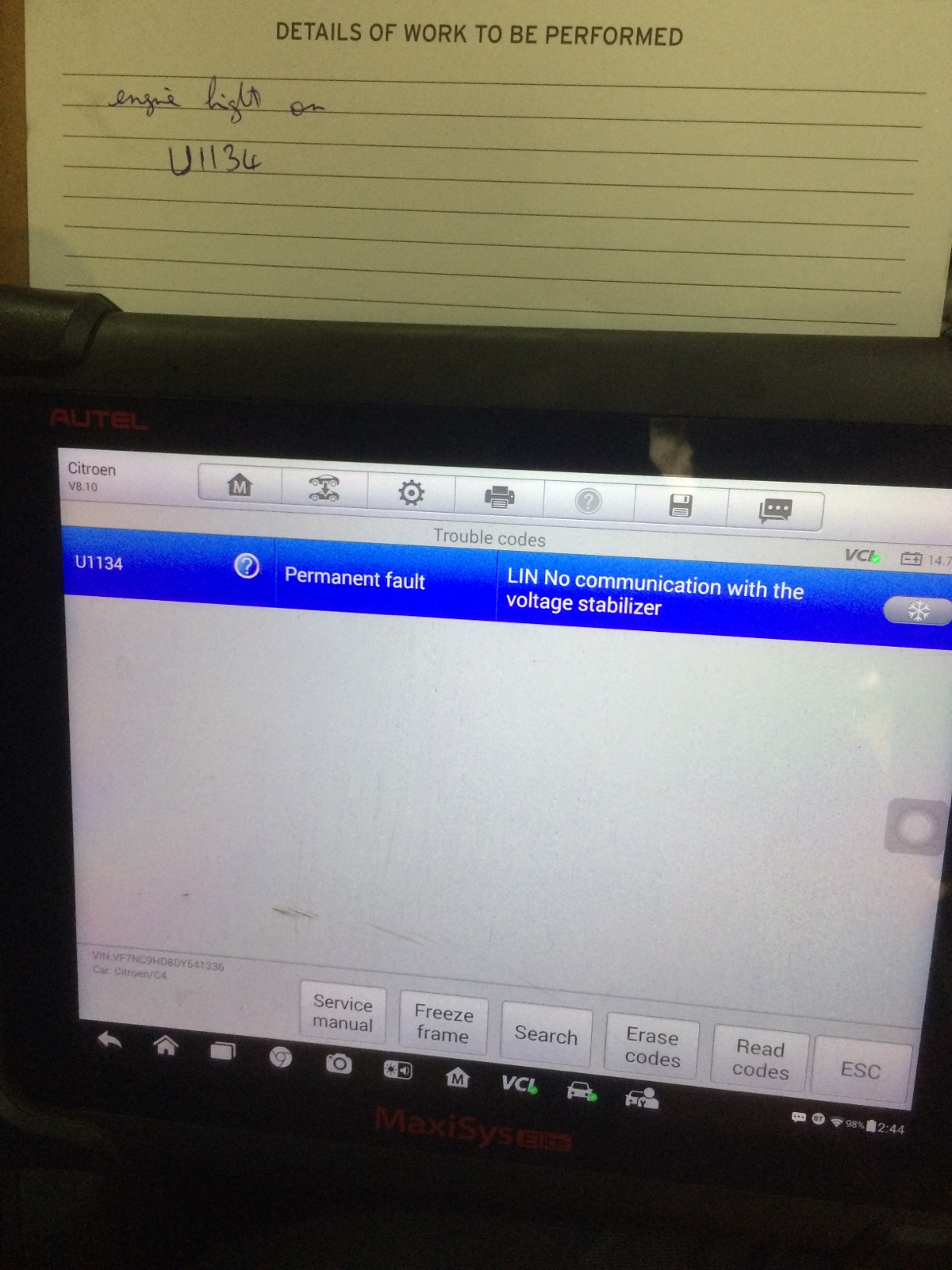

Unread post by MelC4 »
Hi after cleaning the alternator 5 pin plug and connections on ECU 10pin black connector of the stop/start ECU I have only 1 error U1134 as in the scan photo below can this be due to my replacement stop start capacitor not being added or registered as a new part correctly everything else checks ok or can it be the voltage retention ECU is faulty.
