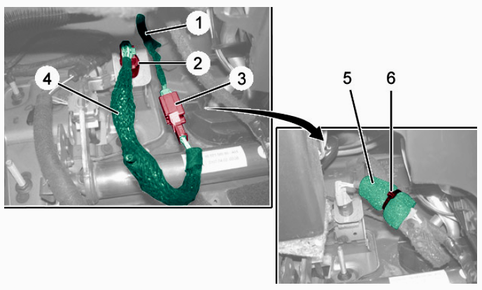

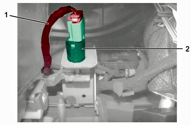

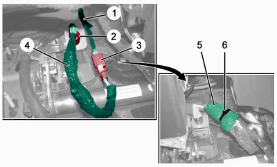

Be aware that there is a technical bulletin regarding stop lamp malfunction / ABS / ESP warning lamps on braking, which I just remembered from years ago that may be relevant Colin:
Origin of Fault: Brake Light Switch
Action:
  • Install an intermediate electrical harness.
  • Replacement of the brake lamp switch.
Parts Required:
  • 1 Switch kit (See part no. in replacement parts system).
  • 1 Plastic clip (Packaging of 50 - Part number 6980 A1).
  • 1 Foam (Packaging of 20 - Part number 9365 72).
Repair:
Disconnect: The electrical harness (1).
Replace: The brake lamp connector (2).
Position: The intermediate electrical harness (1):
  • Connect the intermediate electrical harness (1) to the stop lamp switch (2)
  • Connect the other end of the intermediate electrical harness (4) to the electrical harness (1)
  • Wrap the connector (3) linking the intermediate electrical harness (4) to the electrical harness (1) with the foam (5)
  • Attach the 2 electrical harnesses (1), (4) together ; Using a plastic clip (6) (Moderately tighten)
  • Cut the excess length from the plastic collar (6)
Check that there is no interference between the electrical harnesses and the pedal gear.
