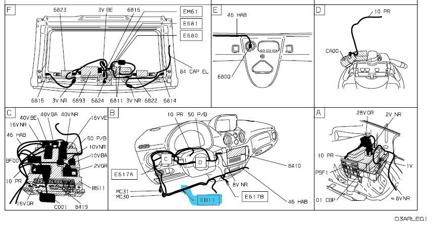

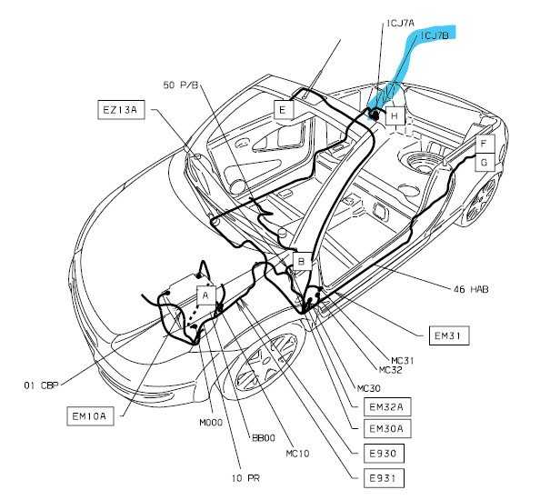

It wont reset the ECU, it will give it power. If you have checked this correctly & there is power at fuse 40 but not at pins 4 & 5 of the brown connector on the roof ECU then i would say this is your problem. There is a splice (EB11) where the output from the fusebox splits into 2 wires to go to the ECU, I'd check this splice.
From there It goes through pins 3 & 4 of connector ICJ7B (6 way black connector), also check you have power here.

thank you good sir after checking pins 4 and 5 via the battery, the trunk magically started working even when I removed the voltage. but everything else doesn't work. I checked the wire link from the picture in detail and everything seems to be in the best order. when I try the rear lock on the glass, the famous click of the relay is still heard.

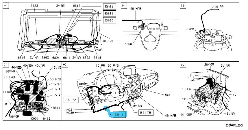

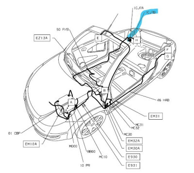

wheeler wrote: 06 Dec 2022, 08:15 It wont reset the ECU, it will give it power. If you have checked this correctly & there is power at fuse 40 but not at pins 4 & 5 of the brown connector on the roof ECU then i would say this is your problem. There is a splice (EB11) where the output from the fusebox splits into 2 wires to go to the ECU, I'd check this splice.
