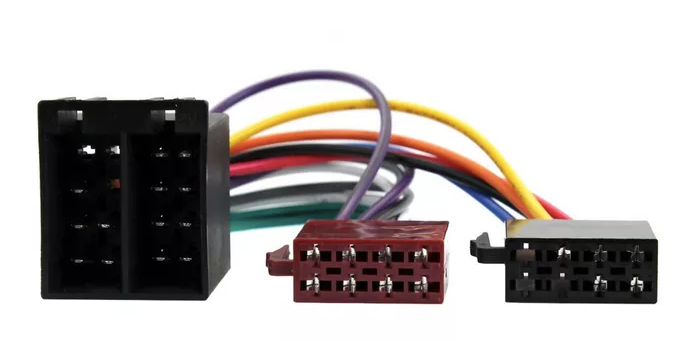

Ross_K wrote: 22 Nov 2022, 18:09
On the cable going in the back of your radio, you need to find the "ignition" 12V wire (use a multimeter to figure out which this is), cut it and solder in the feed from the lighter.
You probably don't want to cut the factory-installed wire, so buy a sacrificial ISO -> ISO adapter cable and cut that instead:
I'm gonna check that out, pal. But, is there any way to fix the cord if it is broken as you explain?

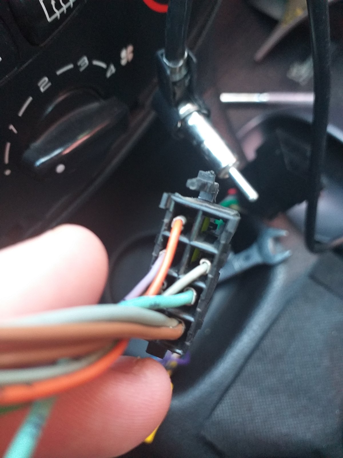

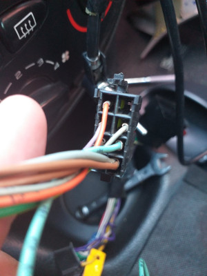

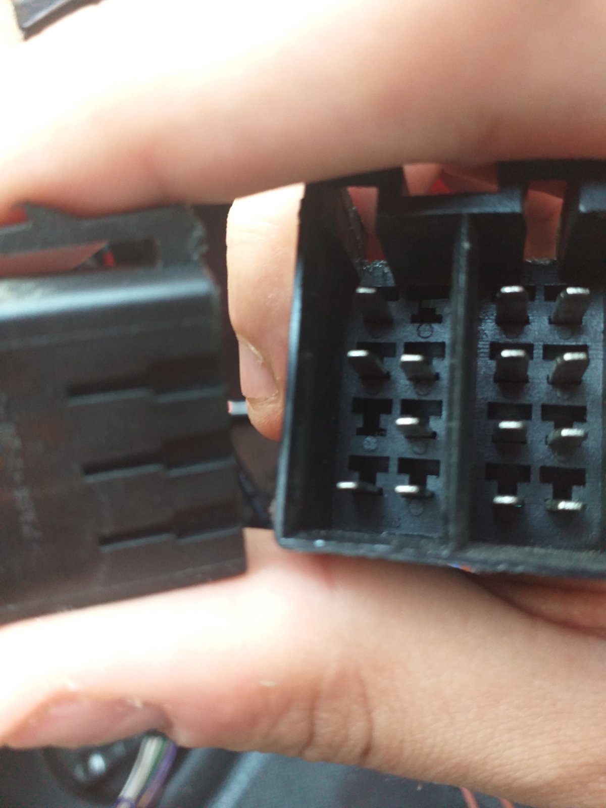

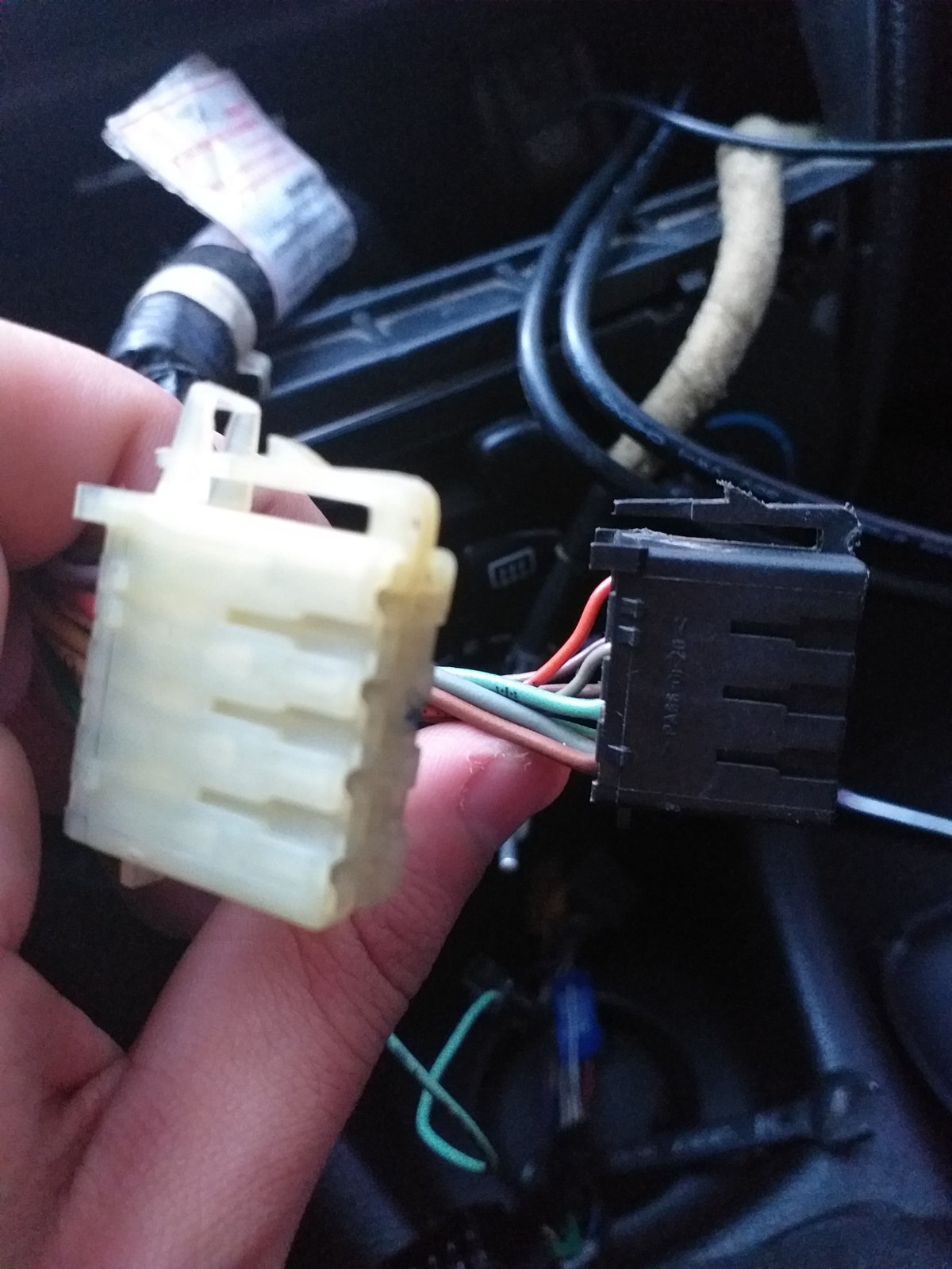

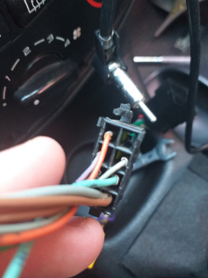

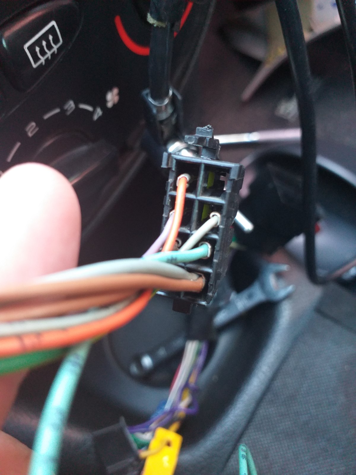

I have these 2 plugs from the car i have attached an image).
What should i do in order to "verify" what you told me?

Re: Chinese Android Multimedia Panel on Peugeot 206 not working properly
Unread post by wheeler »
Do you have a wiring diagram for the Android unit? and a link to the unit you bought?

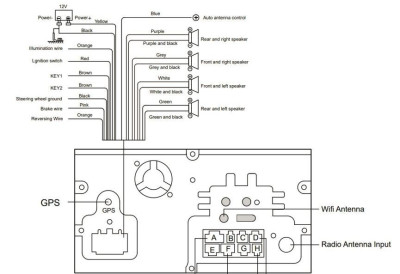

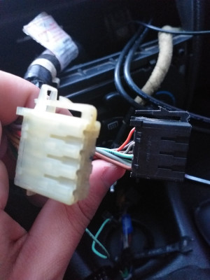

Take a look at these images (based on the diagram upload in this thread). What do you think?
x 6955
UserFromInternet wrote: 24 Nov 2022, 12:25
GiveMeABreak wrote: 23 Nov 2022, 15:35 I'm not sure what else I can do to help you further - you need to contact the supplier with the pin designations on the connector they have supplied you.
Your existing connector will have wiring codes on the wiring sheaths. Look at my wiring diagram in the main forum and you should see these matching up - which will tell you which wire is on which pin.

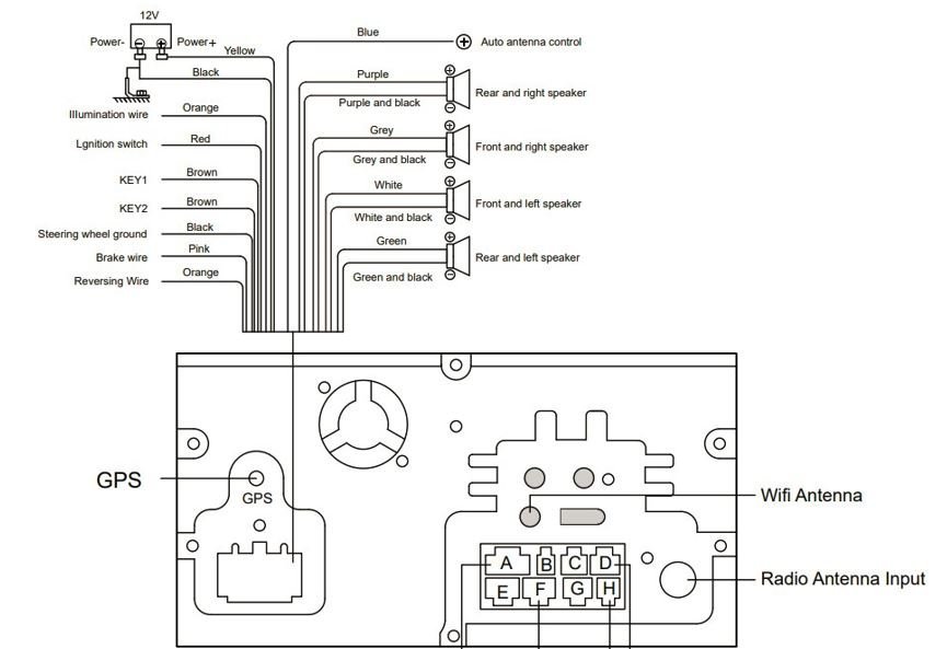

Pal, the seller sent me this diagram from the Android Multimedia Panel
Well that Android unit doesn't seem to have any multiplexed connections at all. Your factory system was supplied without speakers, so even if you can even get this to work, you can forget about any fancy features working.
The other issue you have even if the android radio is CAN compatible is that your original radio is on a VAN network, the 206 never used a CAN radio.
VAN is a PSA specific protocol.
Just came to say it worked for me!. I used a piggyback fuse :)
