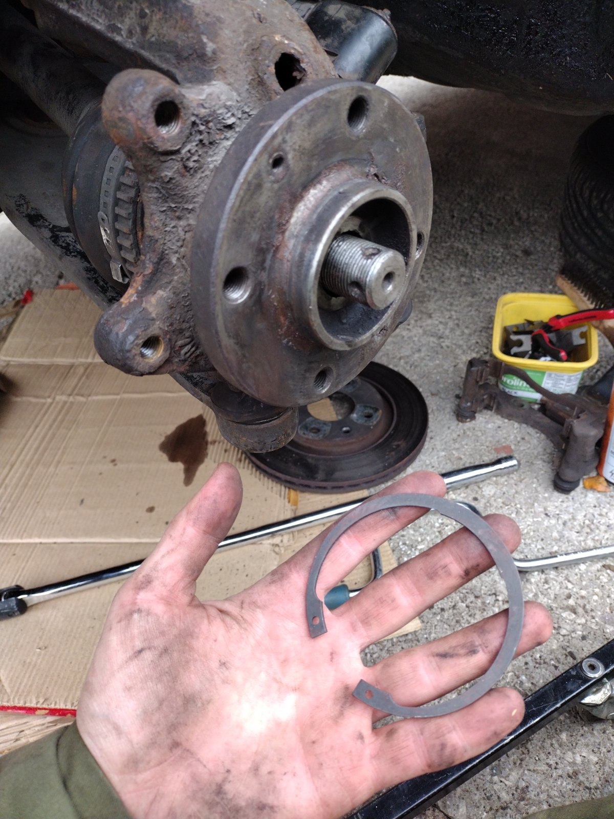

Found the blinking horrible circlip off but am eyeing up some big circlip pliers for this job in future.

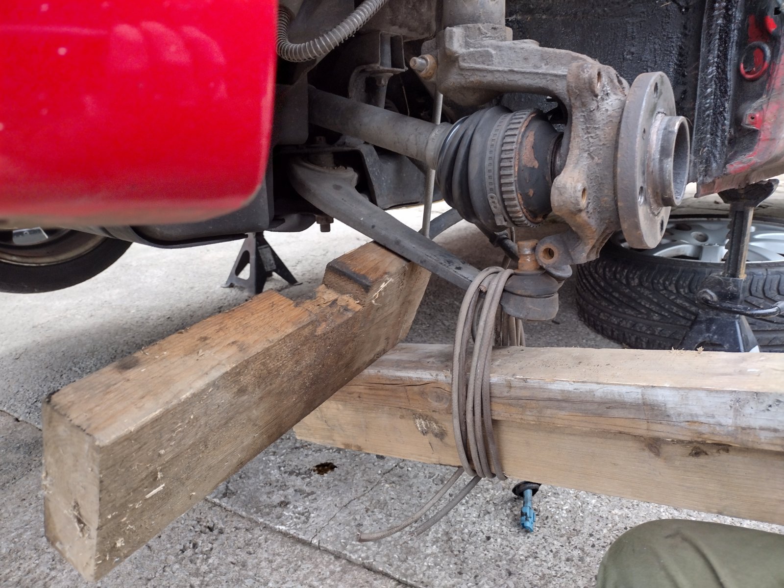

Bottom ball joint removal aid in action (bits of timber and some scrap coaxial aerial cable)

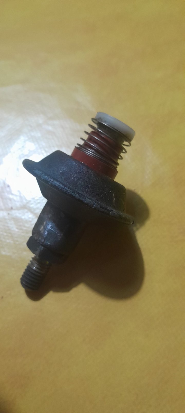

Yeah can be slightly distorted hub, if it fails again i will replace the hub aswell. As for the engine juddering i narrowed it down to a faulty diesel pump throttle damper. It is sticking and retracting erraticaly exactly as the juddering i experience when driving uphill or under load especially. Any idea where i can find one for the bosch diesel pump? I dont know how to send a picture on this forum... this is like a solenoid that the throttle lever rests on.

Full editor and preview, then click Also, que the swearing, yes that is the new circlip that was hiding in the bottom of the box!

That is a funny little thing, don't recall seeing one of those before. My dad's 206 DW8 had a throttle return damper but looked like a mini boot gas strut. Lucas pump on that.
Had a previous 306 XUD9TE with a Bosch pump, don't remember something looking like that.
I'd post on the "part numbers request" thread as the part number would give you something to search for,

Found the part number on google. 1563.F9 but i read that its not necessary to run with. Car runs fine without it, throttle returns instantly back thats the only difference without it

Can't confirm the number - Marc would be able to I'd you're a Donor.Jonathancilia wrote: 01 Dec 2022, 14:23 Found the part number on google. 1563.F9 but i read that its not necessary to run with. Car runs fine without it, throttle returns instantly back thats the only difference without it
Couldn't work out what benefit the one on my Dad's gave either, strange thing. But removing it has cured the juddering problem you described?

I have a big pair that are great for installing new circlips but it's not up to initially freeing off ones held fast with a bit of corrosion...MattBLancs wrote: 01 Dec 2022, 13:08 Found the blinking horrible circlip off but am eyeing up some big circlip pliers for this job in future.
I use a punch to get it moving and once free, a slim cold chisel specially ground for the job to lift an end and flip it out of the groove...
They usually end up flying across the workshop! Wear eye protection

It's an anti-stall device... It slows down the return of the throttle arm when you lift your foot off the accelerator pedal. The 'gas strut' device also fitted to some pumps was to do the opposite and prevent a snap opening of the throttle by slowing its movement to fully open... It was to cut emissions and reduce black smoke...
Th latter is not needed and as long as you know the function of the former it's not essential...
