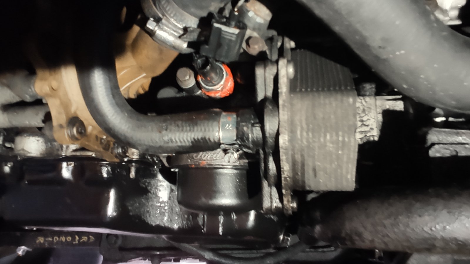

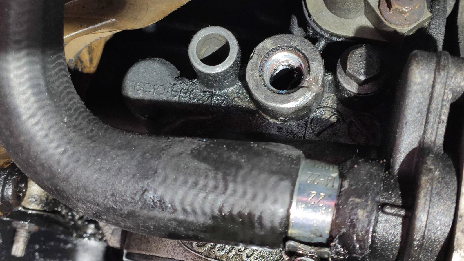

Re: Oil leaking from Pressure Switch stub

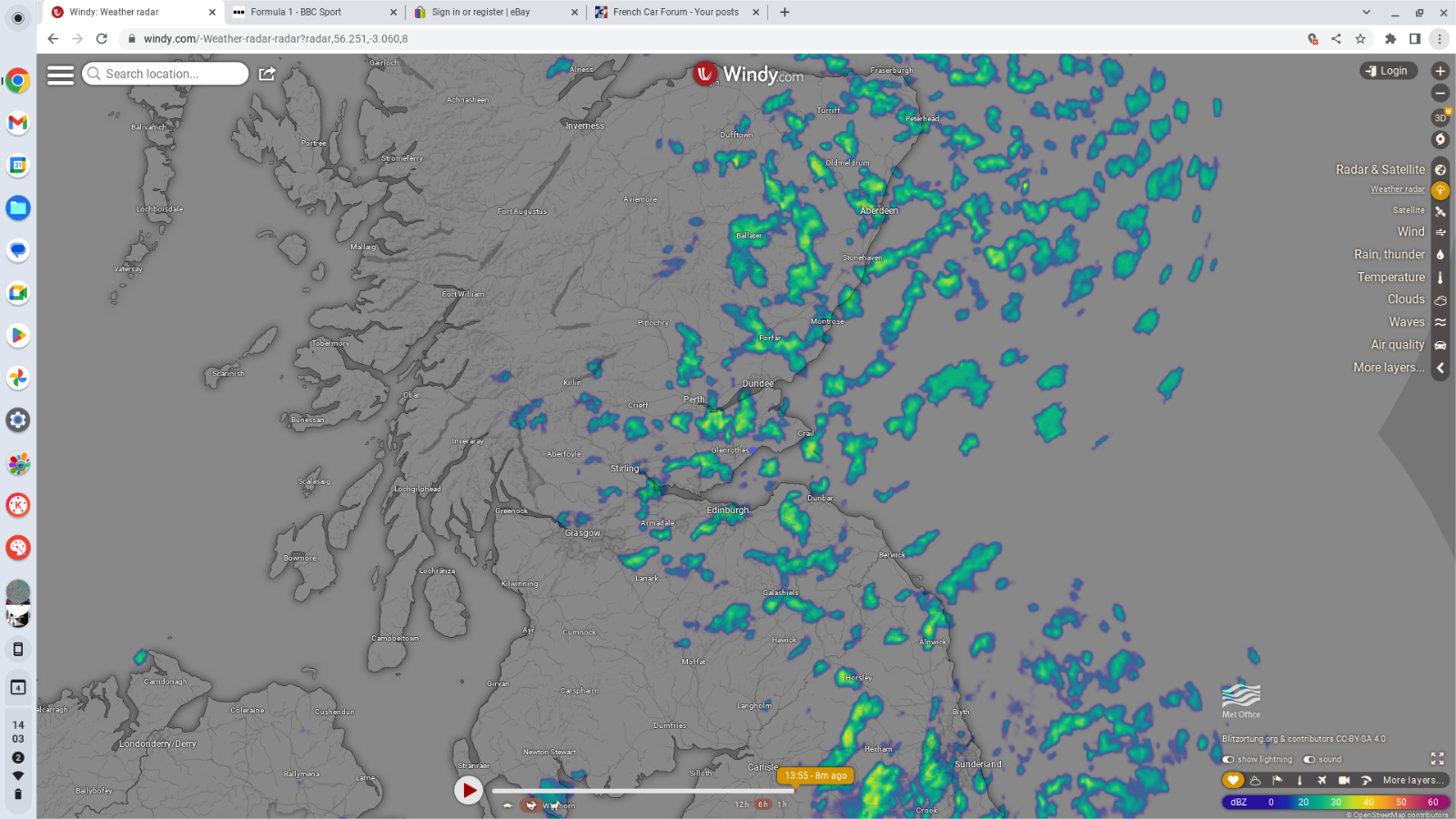

Today's weather
So, lying on as much cushioning as I could find
I removed all the grime and scraped and picked at the stub until
The eagle eyed should notice two things:-
there is a crack
AND
I had to pick out what appears to be Araldite in the notch around the crack
Then rain stopped play - again.
Yes!
Someone at some time went to a fair bit of effort to make that look neat and round and hacked a groove out to get the Araldite in. The B###### probably took longer to do that than undo 3 easy bolts and two easy water pipes to replace it!
One extra plus about being underneath today is that I have also confirmed a leak from the power steering hose.
Happy Days.
Happy Days.
