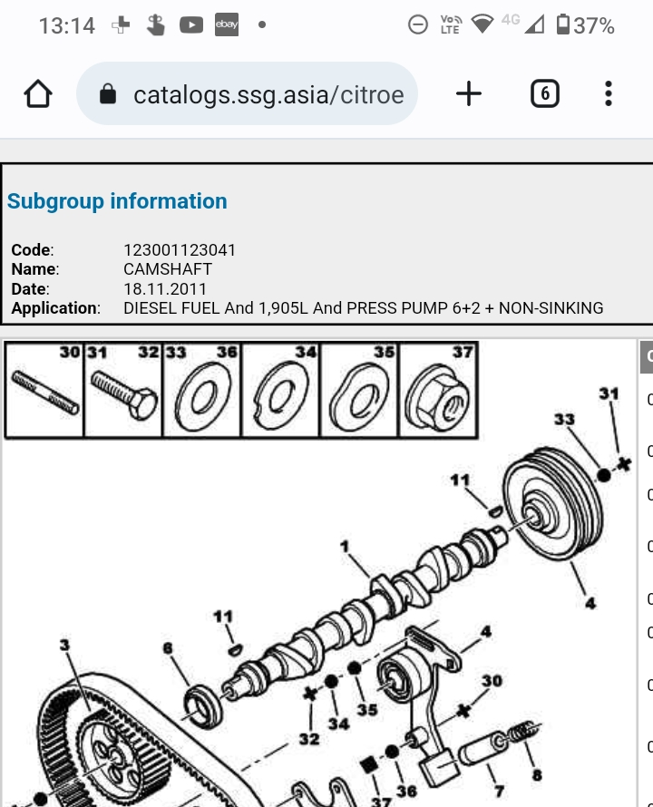

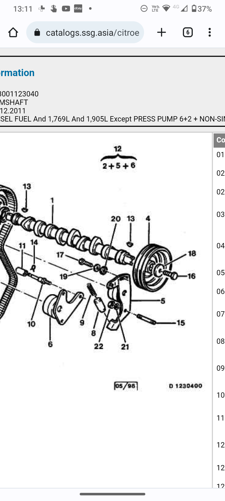

Oh, think I have found a diagram:
Camshaft pulley
Camshaft pulley
https://catalogs.ssg.asia/citroen/?lang ... aWVyPT0%3D

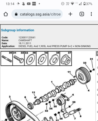

XUD9TE in a BX also has pulley bolted on with Woodruff key:

Good finds Matt :D
