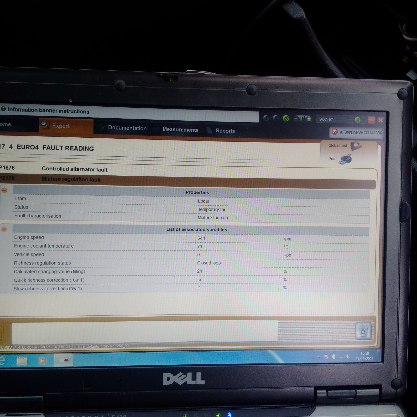

Do you have a screenshot that shows the values at the right of the screen?

Regarding the MAP or the alternator fault?

The MAP sensor. I don't think it likely that the fault is caused by that sensor, but the trim values may give a clue.

All I can say is that the car is a different vehicle to drive. Its now a pleasure to drive. Before the map change it used to just cut out at traffic light and tye idle was erratic. The map trims the mixture values and if not working correctly can have a knock on effect on other things. It is French. I have cleared the fault to the archives but diagbox can recall these. I will take a full photo of the full screen of the fault record. If you look inside the censor electric connection there are 4 pins numbered 1 2 3 4. The ohms resistance between pins 1 and 2 on the new censor was 9.76 ohms. The old one was showing an open circuit. It was definitely done. I will post an archive photo ASAP for you.

Indeed Marc. P2178. Last line of "suspected areas" inlet pressure censor. Right on the button 👍 Going to check out the other fault code today. I haven't fitted a new alternator but it's possible someone prior to myself owning the car has, maybe a second hand one. I have only owned the car for a few weeks and it was laden with faults when I got it. This P1676 is the last fault to tackle.

As promised the full fault reading code photo. Notice the richness regulation status "closed loop" 0
