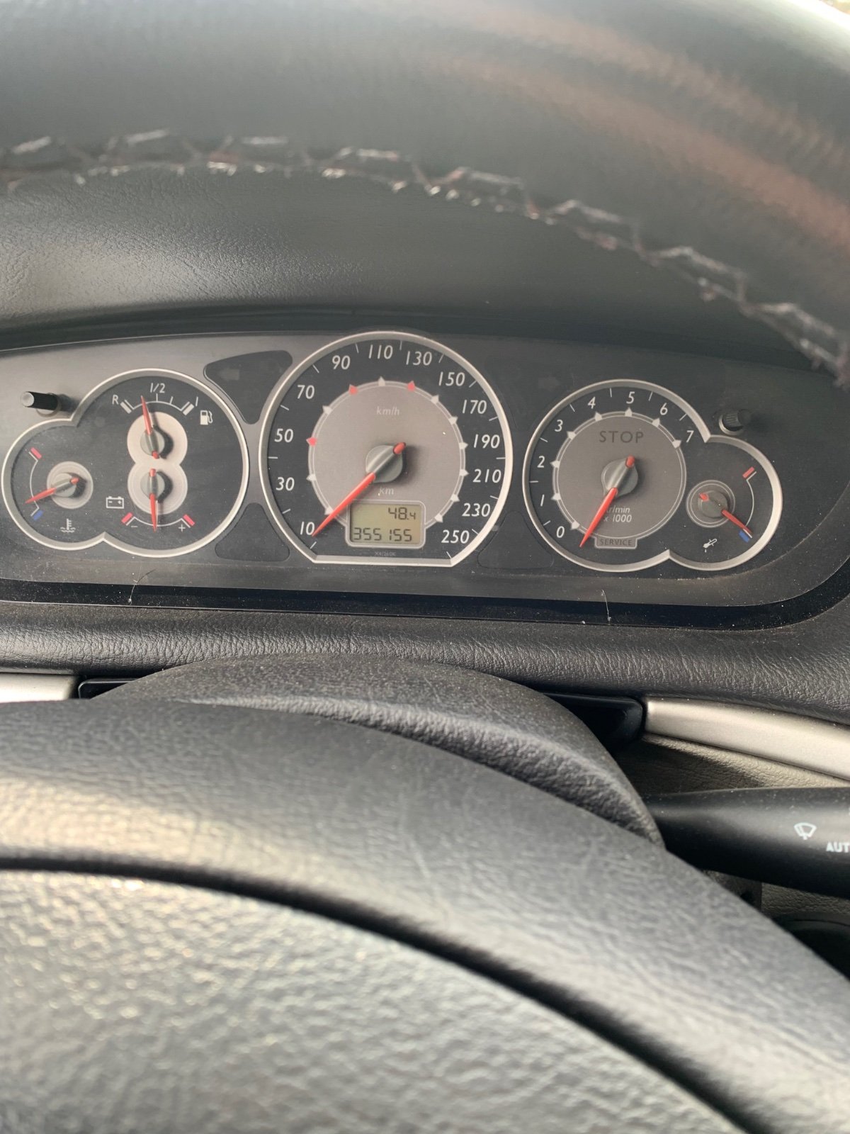

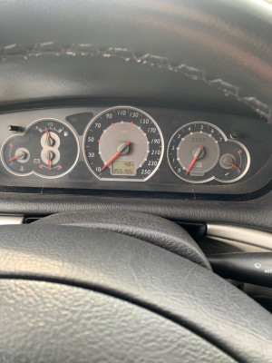

Kayso
Posts: 11
Joined: 04 Feb 2023, 18:27
Re: Citroen C5 no start, no cranking, no clicking starter
Unread post by Kayso »
Takometre problem

Kayso
Posts: 11
Yes
AnthonyKnight
Posts: 32
Joined: 30 Aug 2022, 22:10
x 5
Unread post by AnthonyKnight »
Kayso wrote: 27 Feb 2023, 19:24Yes
So how did you do the coding for the new ABS unit, what diagnostic tool did you use, my lexia wont work on my C5 ?
