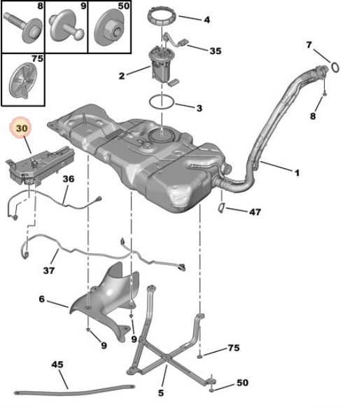

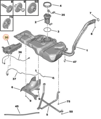

I have come across another site which lists these additional part/reference numbers:
9672419980
9672052280 9672052180
1500PJ 1500.PJ 1500 PJ

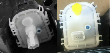

From the look of things all the above have the same connections on the pump, where as 9816296080 mentioned earlier has a slightly different layour and an additional circle. I've attached a reference to see the difference.
So ultimatlely the question is are all these parts interchanable?
Or are the first 4 parts mentioned here interchanable?
Or do I need part number specific.
VIN is VF7**************[VIN obfuscated, can be read by forum staff]
DS5 - additive pump
- x 6945
Re: DS5 - additive pump
Ok, so the correct part is: 9672419980, and is the complete tank and pump assembly (the pump is not sold separately by PSA), cost UK £313.93 inc. VAT
The other part numbers (9672052280 & 9672052180) are not listed for this vehicle.
