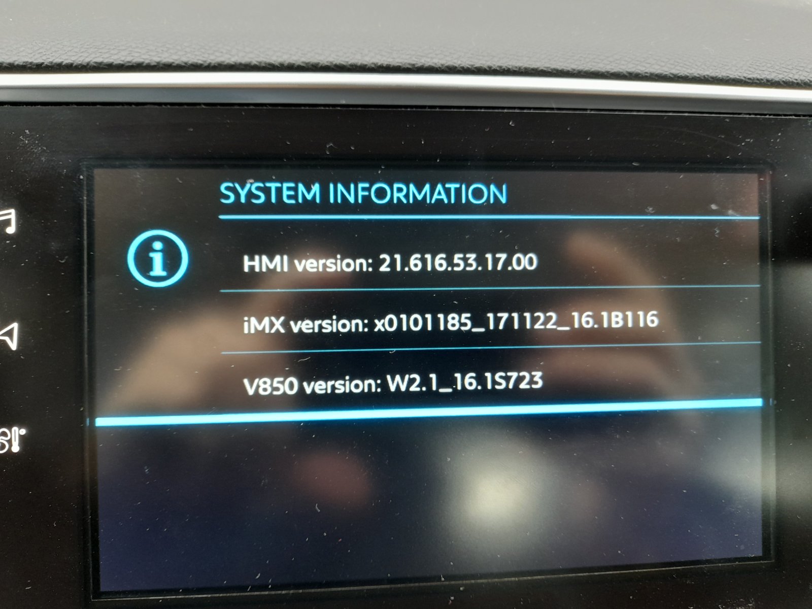

Re: Android Auto option 'missing' from C3 2017 Wave 2.1 RCC
HI
PLEASE SEND ME THE DOWNLOAD LINK FOR MY 208 SYSTEM UPDATE WITH THIS SYSTEM VERSION
HMI version: 21.616.53.17.00
imx version: x0101185_171122_16.1B116
V850 version: W2.1_16.1S723
Hi Marc/GiveMeABreak,
Sorry I am not giving you a break jumping on this thread
Just after some advice, so I purchased a 2016 (66 plate) 308 GTI in January of this year and it has come with Apple play. Looking on other 308 forums and asking other GTI owners I have the RCC unit and these were not installed in these cars this early so it must be fitted after market.
The details I have
IMX version: x01011185_171122_16.1B116
V850 version: W2.1_16. 1S723
I access the mypeugeot app but there are no updates, but reading other threads there are??? I can ony assume my VIN has not been updated to match the unit I have so now updates can be sent through.
Would you know where i can obtain these updates via USB? Overall the unit is good but sometimes it does crash and no sound comes out of the speakers even though the unit is functioning
Thank you in advance
