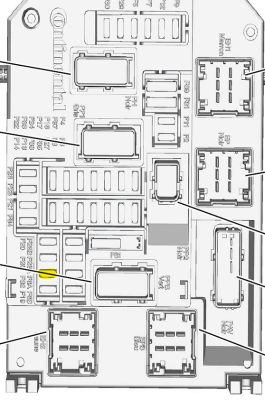

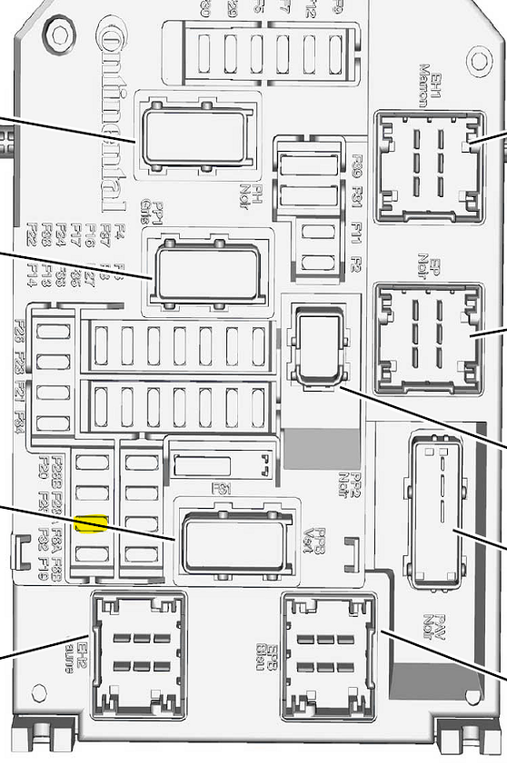

Highly unlikely to be that - but if you want to check, it will be fuse F32, a 10A fuse for the Audio Amplifier (which you don't have) and Panoramic Visual Assistance. Located in one of the fuse arrays in the BSI.
Actually I have a diagram - marked in yellow here:

Great stuff Marc, much appreciated.
I’ll check that fuse just to make sure I’m not missing out on a cheap fix. Otherwise, it’s back to Citroen for the expensive fix.

Hi Marc,
As you suspected, the fuse is grand.
