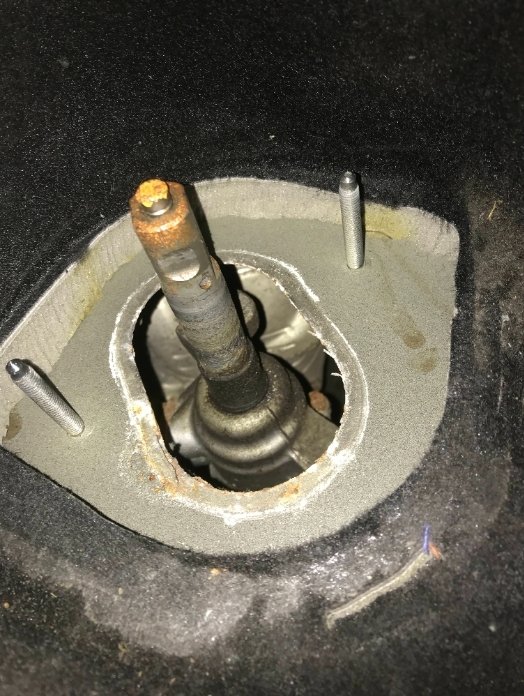

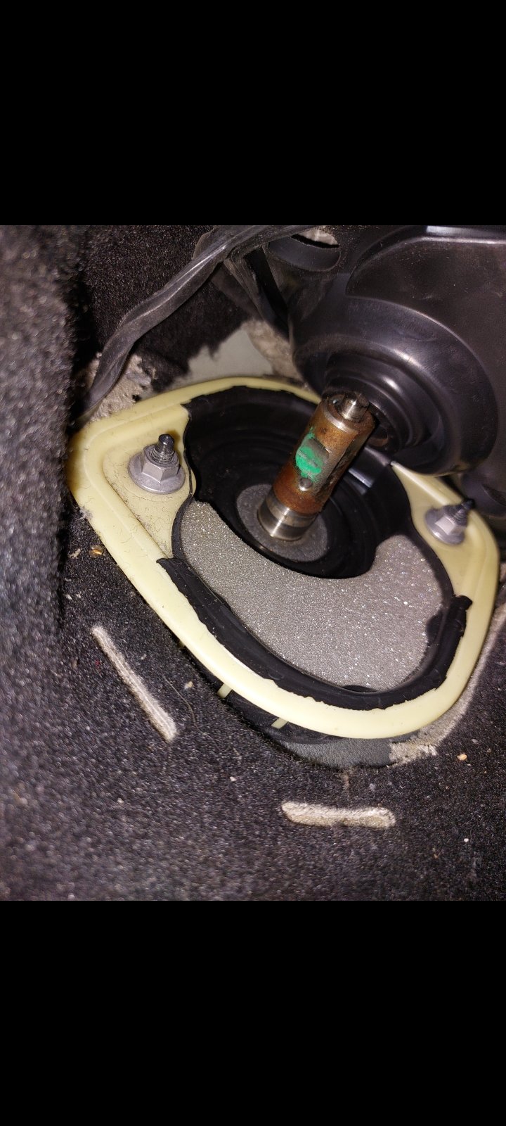

Hi Marc,
I have found some posts on the forum.
Should i check here? Or somewhere else underneath the car?
Thanks!
Thanks!
- x 6945
Re: Air in suspension system c5 x7
Yes, that's the place. This one above looks ok, but many of us when we had the rack replaced used a rubber boot to put over the pinion to help prevent water from sitting in the pinion well, after putting lots of marine grade grease over the pinion.
Okay Marc,
I will check it today or tomorow.
This picture is not mine, I found it on the forum.
I will take a picture and post it here.
Thanks
Thanks

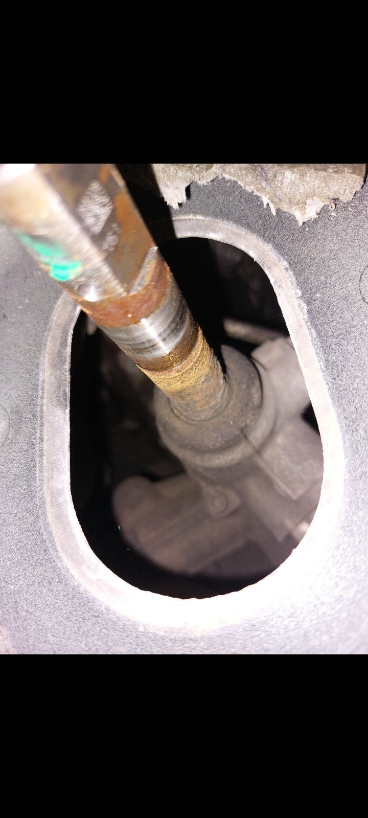

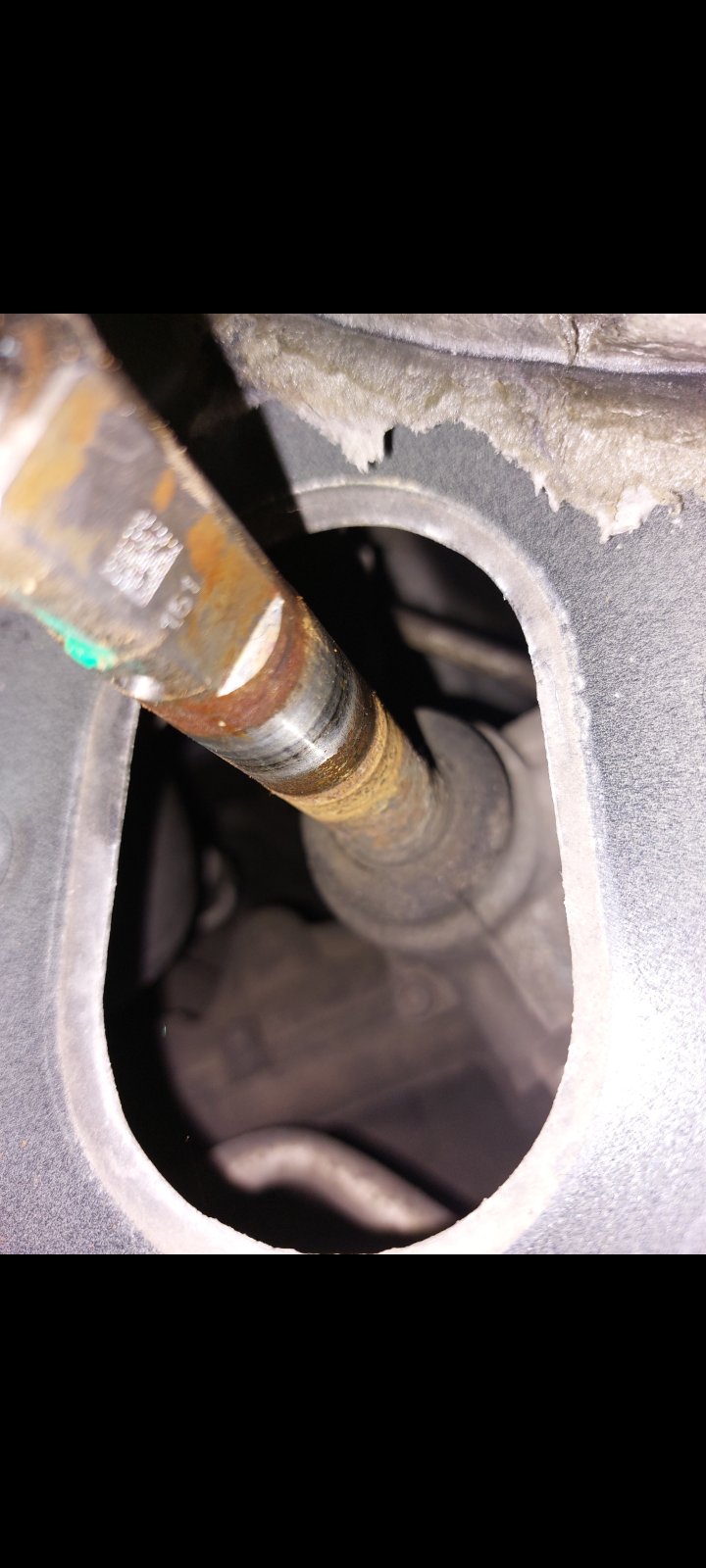

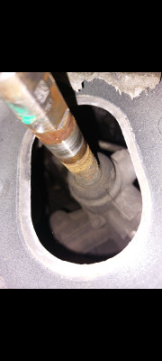

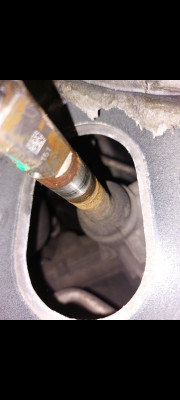

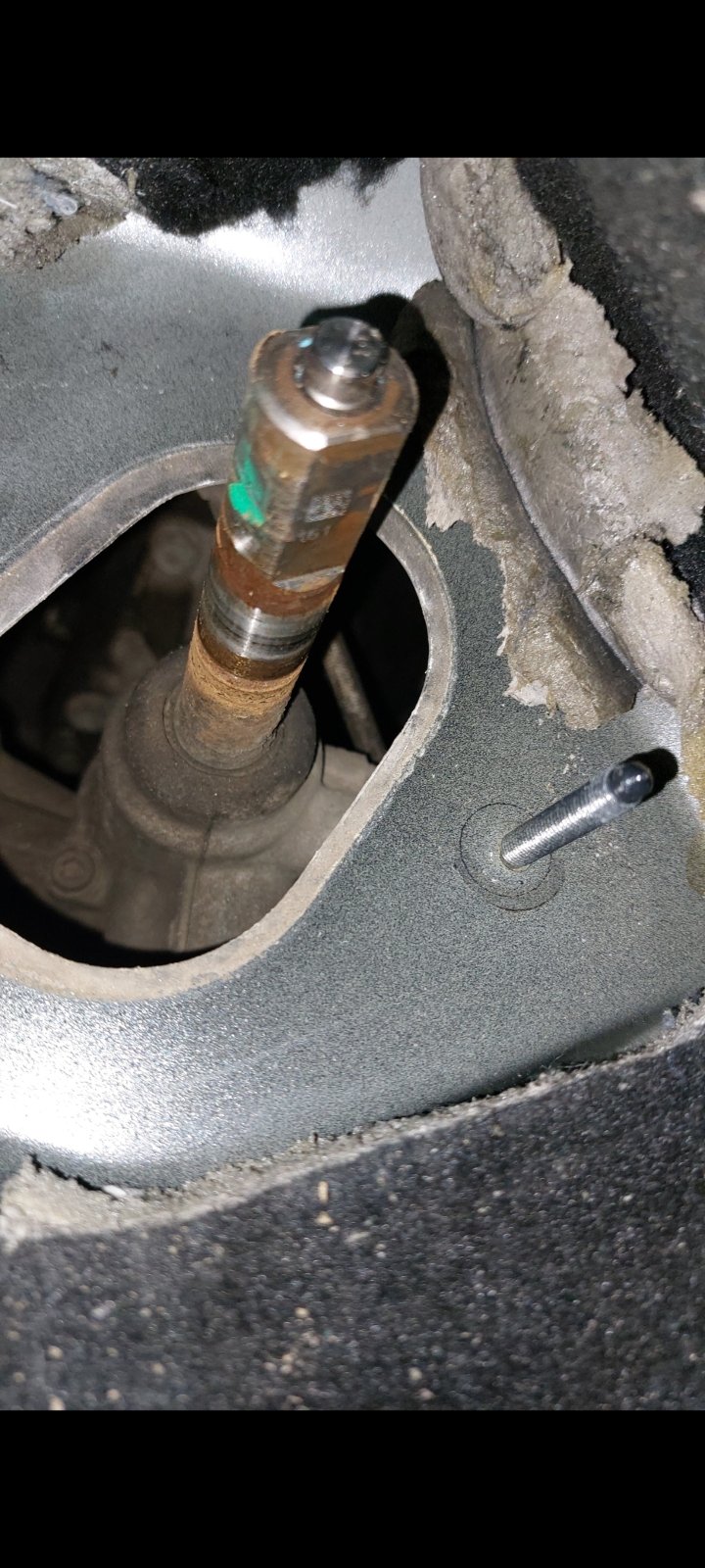

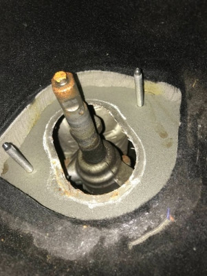

Hi Marc.
Here are the pictures.
There is some rust. Do you think this can brung air in the suspension system?
Thanks
Thanks
- x 6945
You really need to see where the pinion goes into the steering rack. Look at this picture:
viewtopic.php?p=708014#p708014
You should be able to lift the rubber bung up to see where it goes into the rack itself.

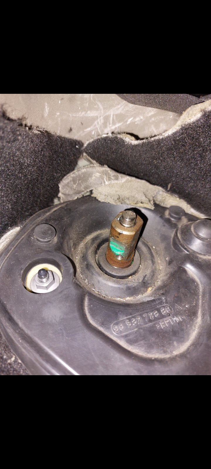

Like this?
KennyW
- Posts: 2615
- Joined: 17 Jan 2006, 21:22
- x 165
There is no HF leak at the Pinion in those photos. But I don't know how you can tell if air is entering.
Nothing obvious
Kenny
Nothing obvious
Kenny
