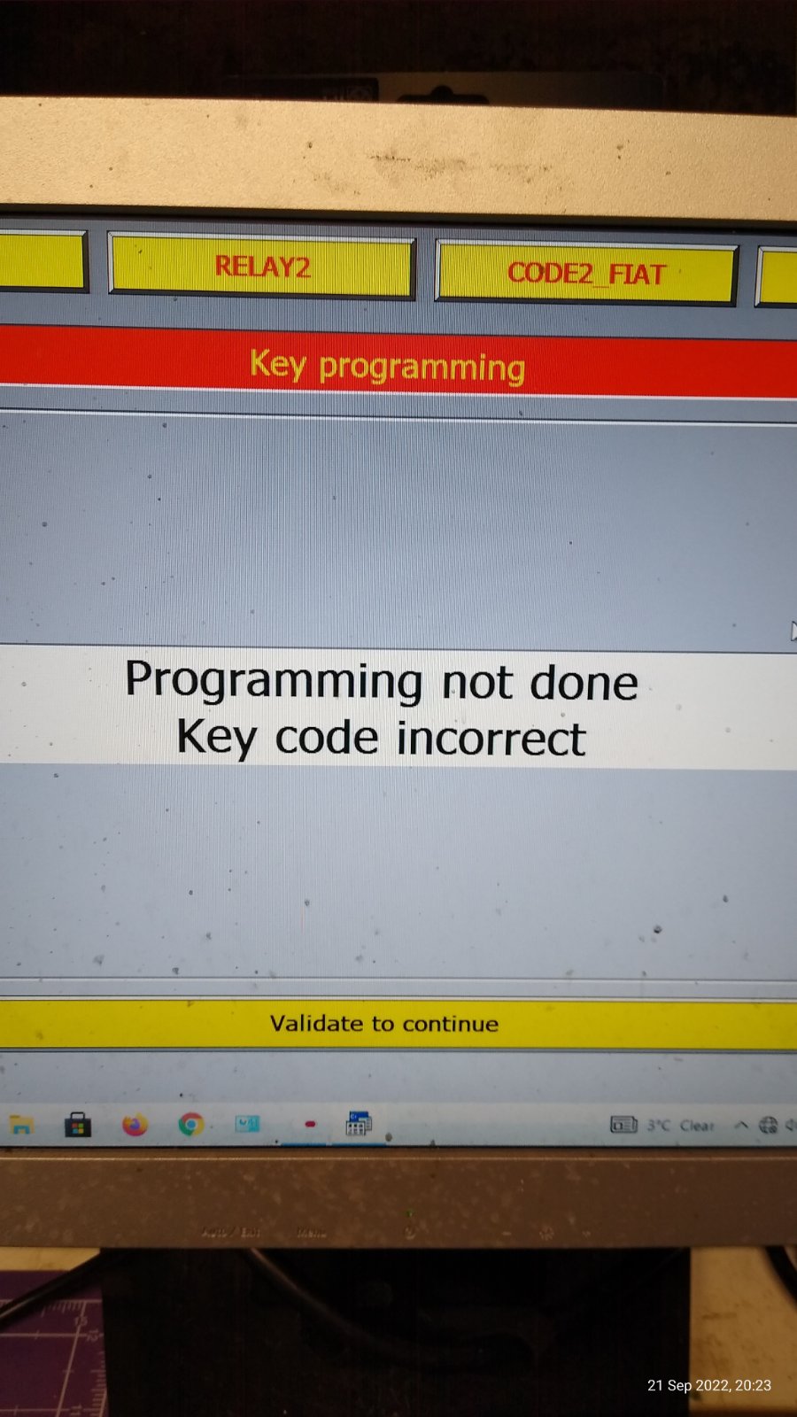

I've just tried to program with the id48 which arrived today. Not really successful. It tells me the secret key code is incorrect. Is this what you mean by the need to precode? I was disappointed as I thought everything would be possible just with my immo pin code.

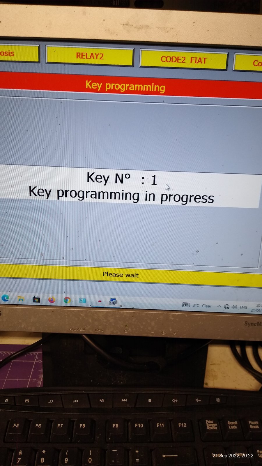

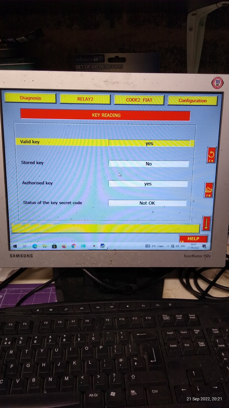

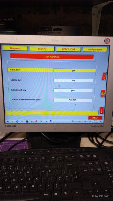

I managed to get as far as the programming stage and the new chip is "partially" recognised (see screenshots).
I suspect the pre-coding needed is beyond the scope of Lexia/PP - if so, it might be a showstopper for me! I have no means of interrogating/coding the ID48 itself.

Firstly are you doing this on the bench or on the car?
Is the engine ECU now matched to the car? If I remember right the Fiat systems auto match when the ignition is switched on however im not sure if this will happen if the immo box is blank & no programed key?
There are a few possibilities here
1. A dodgy ID48 chip.
2. It needs pre coding first.
3. Something in the immo box is corrupted or incorrect after messing around with it.
Im not sure getting the original code will help here.
If you want to send me your dump file from the immo box i can confirm the stored pin code & i can also produce a transponder that is already programmed & ready to start the van. Well I would be able to do this under normal circumstances but not sure if it will work due to the immo box file being altered. I can certainly try it if you wish?
