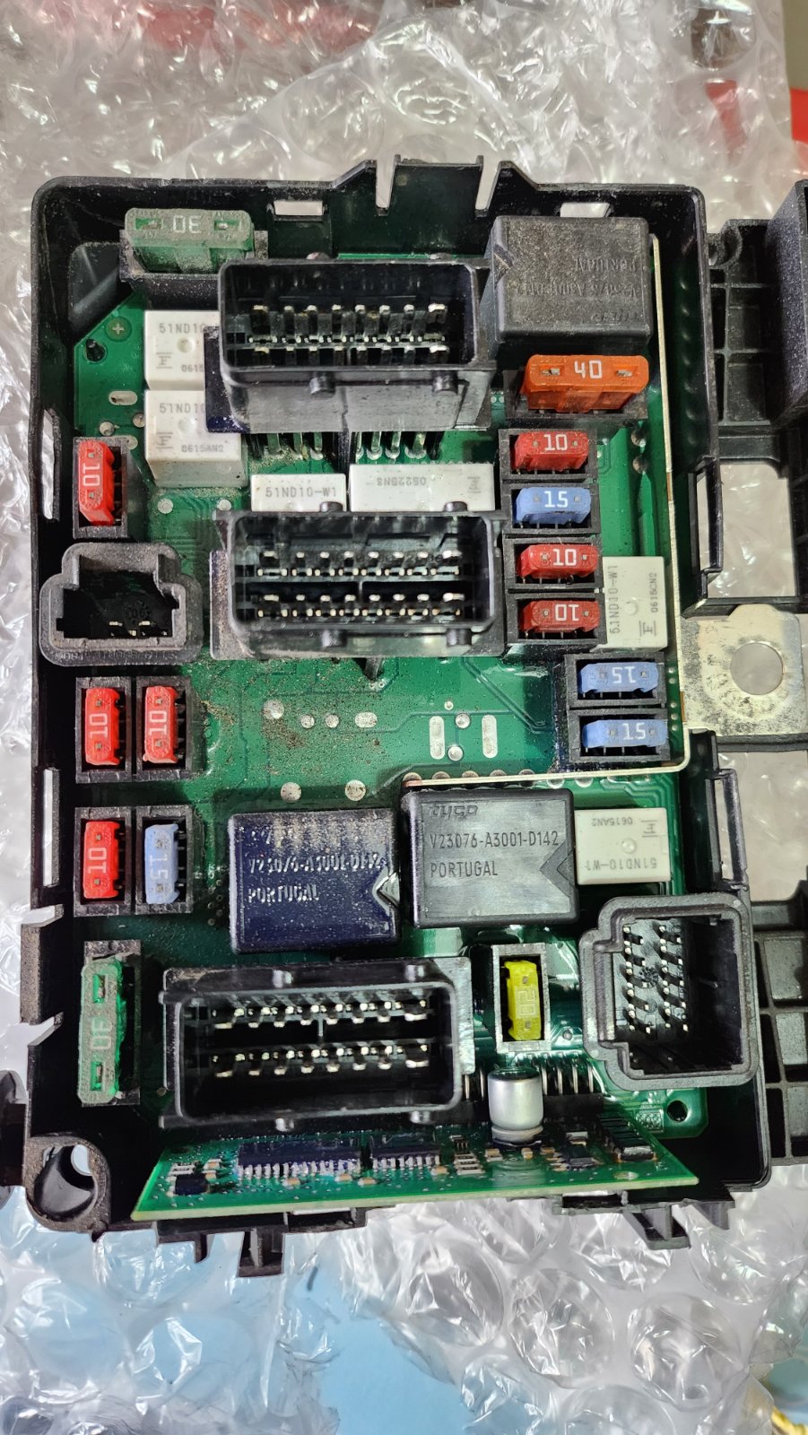

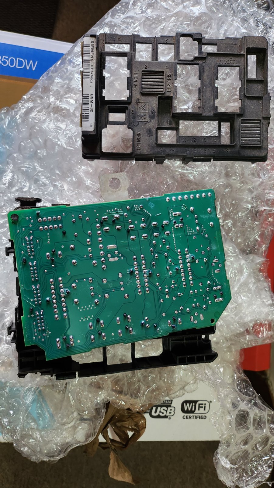

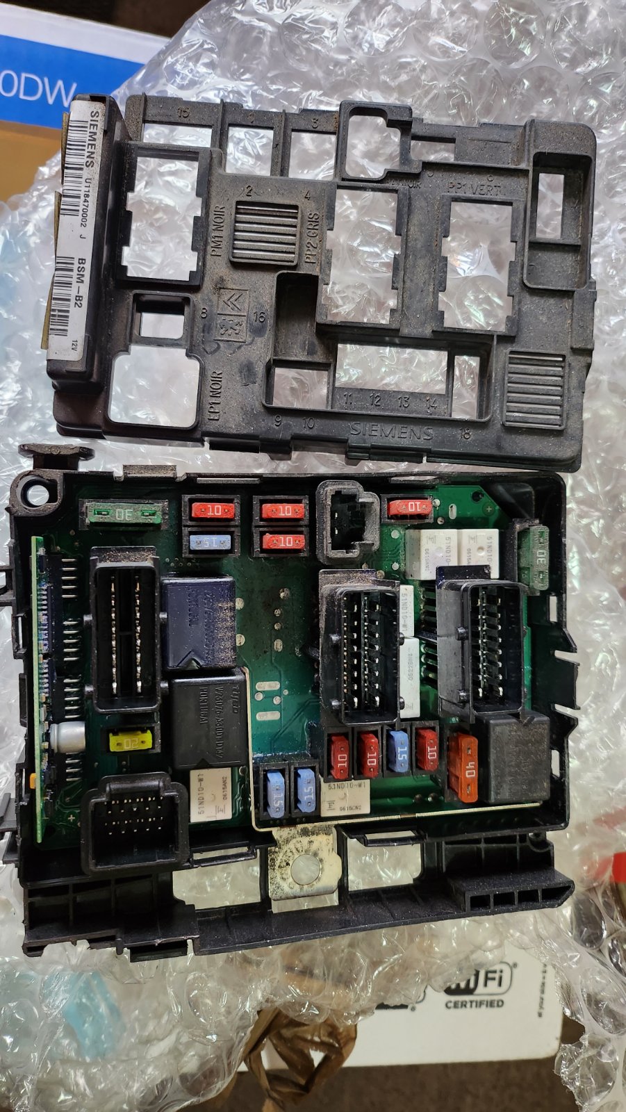

I took old BSM apart to have a look for water damage signs but board is in fairly good condition therefore It had to be damaged relay.
I will attach pictures of taken apart BSM as maybe someone in future will find it useful.
BSM number for 2.0HDI Berlingo from 2006:
9650618580 made by Siemens
