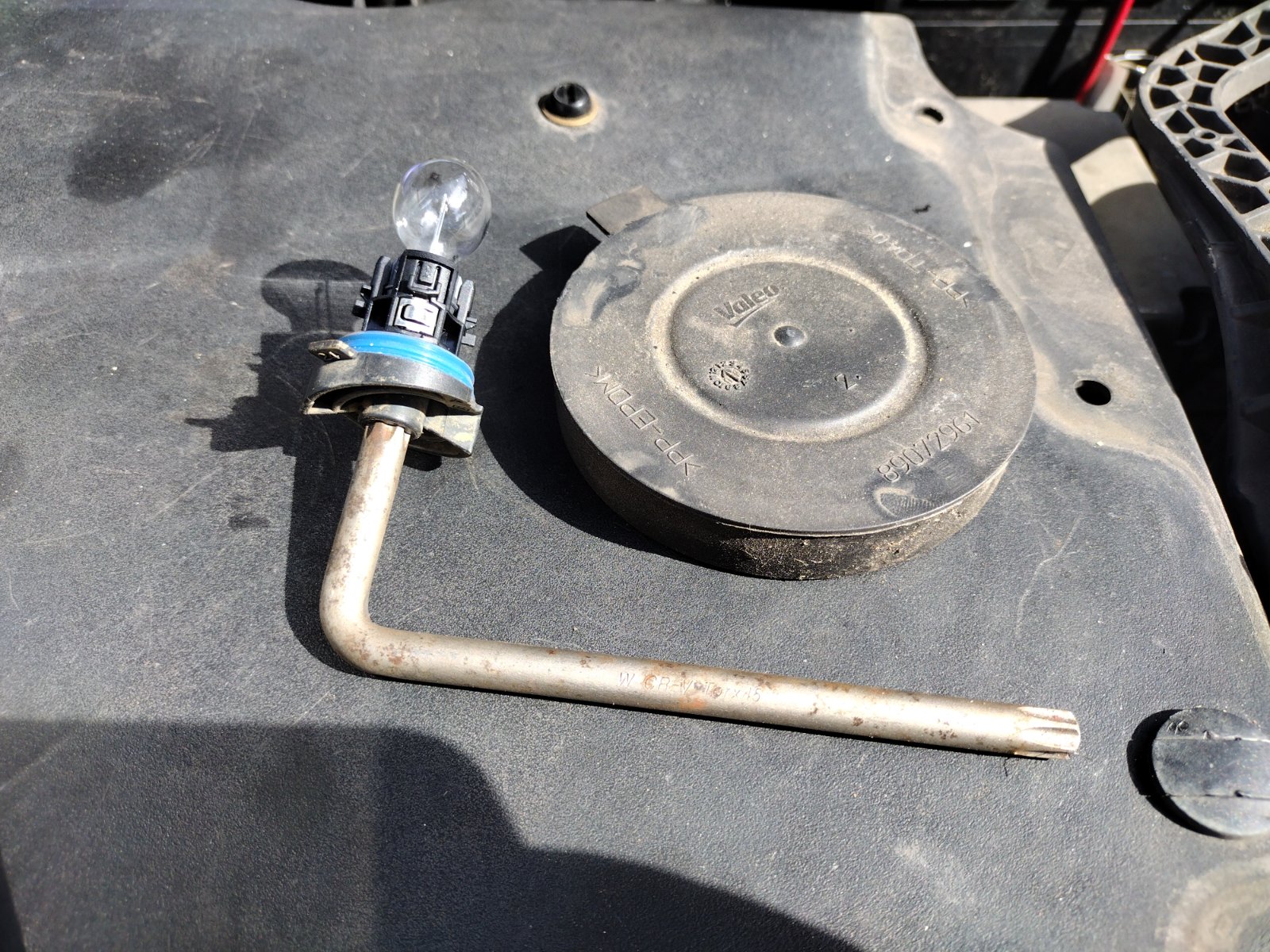

For future reference it's a T45 rather than T40 as listed above.
Got the passenger side (front left) with this "Allen Key type" Torx spanner. Not tried the drivers side yet.
Matt

As my X7 has the later LEDs and is not affected I'm curious. Does the bulb assembly in the above photo disassemble further? For instance, can you pull the glass envelope out of its plastic holder?
x 6945
Re: C5 X7 DRL lamps
The are not meant to be no - but they can be modified which is what I did on my thread to change these to LEDs. One has to carefully prise the bulb out from the black holder and the plastic clips holding it, which are very brittle. Depending on what you are fitting (I used some Cree LEDs) the black housing plastic may need to be cut out to allow the new LED to fit in as they can have a larger base - and to then hold them firmly in accounting for road use and vibration. The Pin wires may also need trimming.

Good question Paul and was my thoughts (and reason for removing it today) I had a tentative wiggle at it and didn't seem like it would come apart readily. But seems I'm wrong, will have a read of Marc's post above.
Just to add. It is possible on a hydraulic X7 C5 to reach the drivers side (right) bulb holder with the above tool and without disassembly beyond removal of the top plastic flap above the headlamp unit. The LDS tank ridges around its circumference leave red marks just below your elbow.
So I'd say it's not so much a question of large / small hands, but "do you have slim arms?" (I'm, fortunately for this job, on the scrawny weakling end of the spectrum!)
