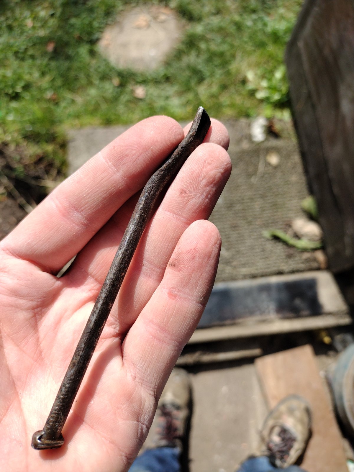

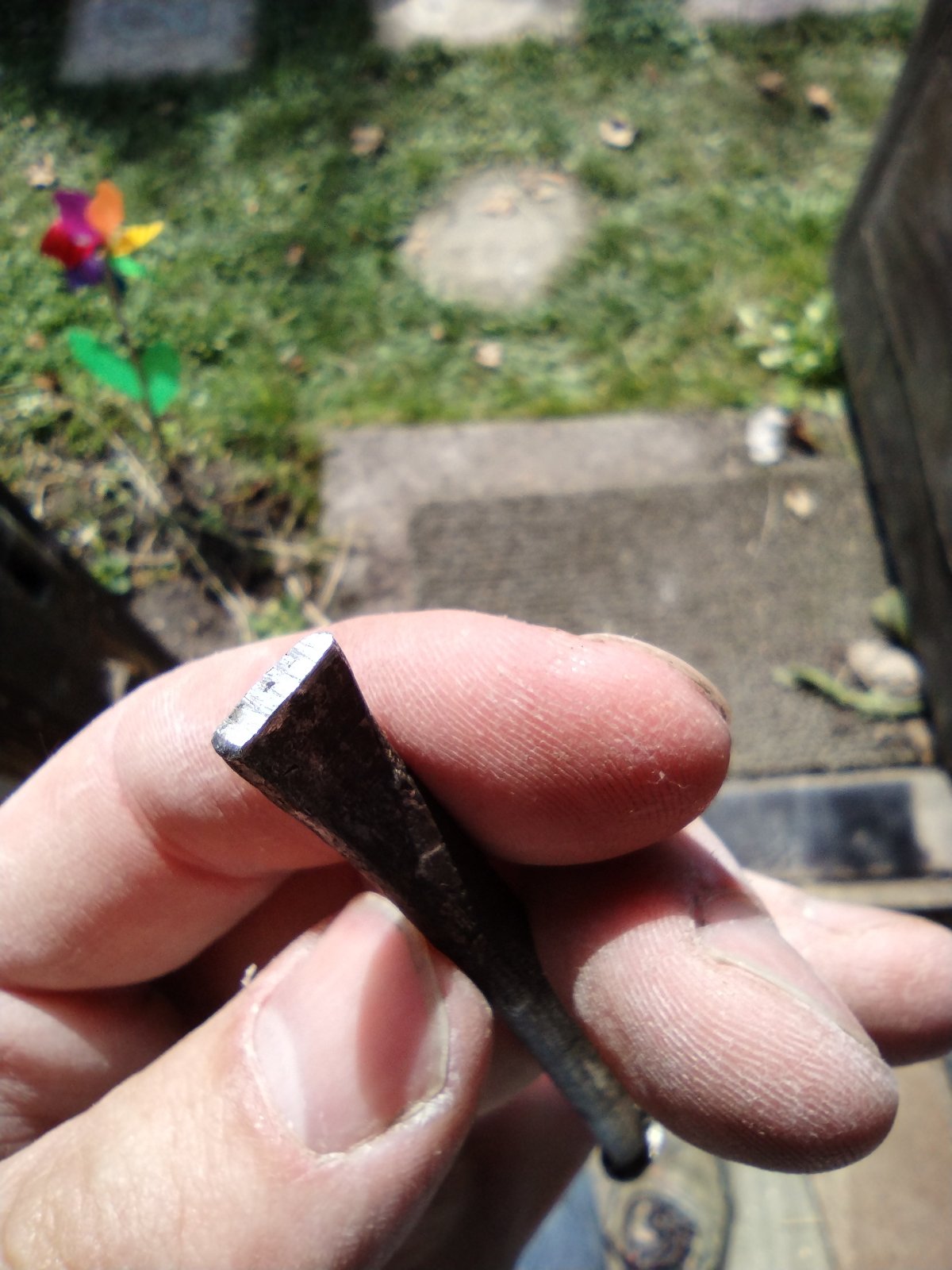

Thought I'd add a picture of the ring tapping tool. 6 inch nail, point cut off, flattened out slightly and flat, blunt end created. Offset helps keep business end fairly in line with ring's raised edges
