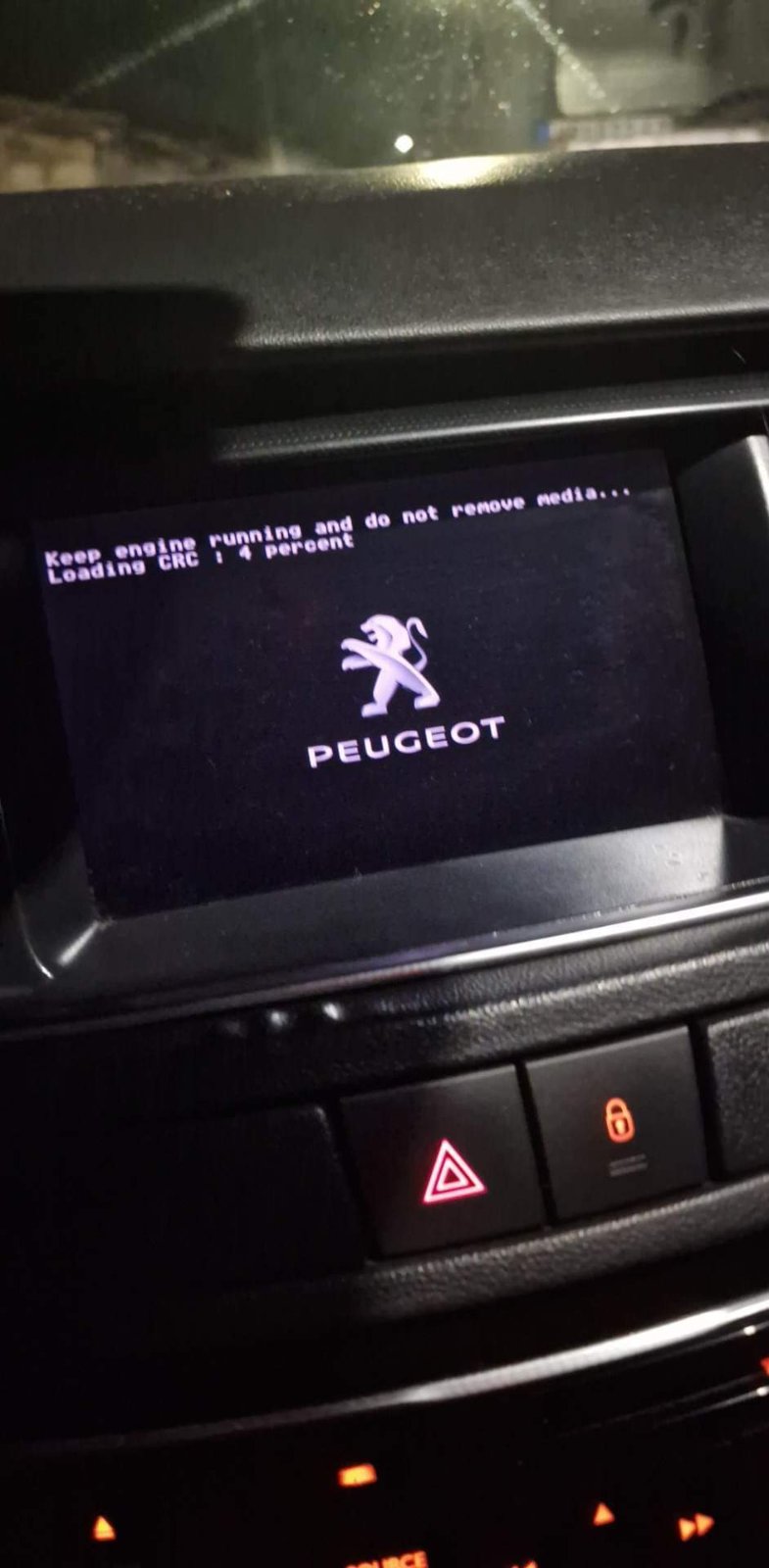

Re: Peugeot 508 RT6 repair
Unread post by Zn1 »
Im back again, it died again, but now i think problem is firmware because it asked in mid ride for Navi CD then after shutting down car it wont show anything on screen just black screen and you can hear CD mechanism every minute or so...
Zn1
Posts: 20
Joined: 21 Jun 2022, 12:12
x 3
As i said problem was with firmware i override it with new one and now it works. Process was simple, on Linux machine i formated USB to FAT32 with erase option (oposite of quick format) then opened ISO with image mounter on linux and copied all data from image disc to USB stick, pluged into car and voila, it started updating firmware after couple minutes, 2-3. I didnt touch other settings it was beeping at first for vin number but after restart beep was gone, i assume that settings were still stored on SD card.
Fault was black screen with background lights on and CD mechanism repeating every half minute or so
