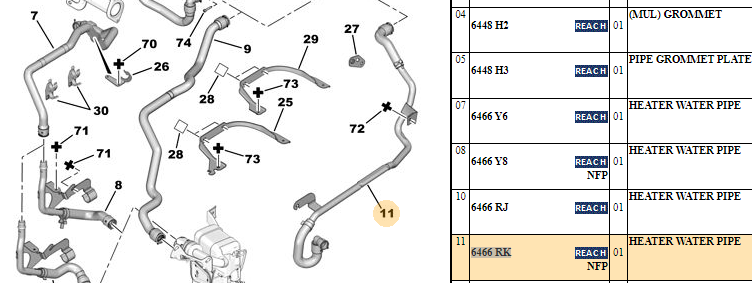

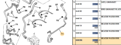

GiveMeABreak wrote: 23 Oct 2023, 15:34 According to my live data that part IS still available from Citroen, using their own live parts database. It is not marked as NFP, which indicates it is available.
https://peugeotcitroendsparts.com/produ ... 466rk.html
Sadly, their listing of the part as available was an error. They got back to me after i placed an order and replied:
I'm very sorry but due to a mistake in the manufacturer system that populates our site, we have listed the part you have purchased as available but they are currently out of stock. I'm not able to source it from any of our alternative sources.
:( oh my, i was finally hoping this could be fixed. I have used the Fortè additive as mentioned here, it worked for a while keeping the leak at bay but now it is steadily leaking again.
There is, of course a possibility of used parts- I haven't found any parts in Norway but are there perhaps other resources out there?
x 6955
Re: 2010 C5 Coolant leak
Yes, checking today the part is now marked as NFP, so no longer available!

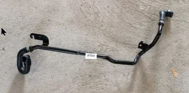

After several attempts at getting this heater pipe used from various scrap dealers in both sweden and norway, I remembered suddenly a website I used to frequent when I had disposable cash: EBAY! - I searced for it there, but no match- but put in an automated search. A few months went by, and voila:
I got mail... It turned out to be a NOS original part heater pipe from an Italian merchant. A little over a week and €180 later, I got it delivered to my local post office. Looks great! (not so great picture, but...)
Now the challenge will be dismounting and mounting this thing. The local Citroen dealer won't take it on, and my local indie garage is hesitant- lacking the proper documentation for the procedure...
