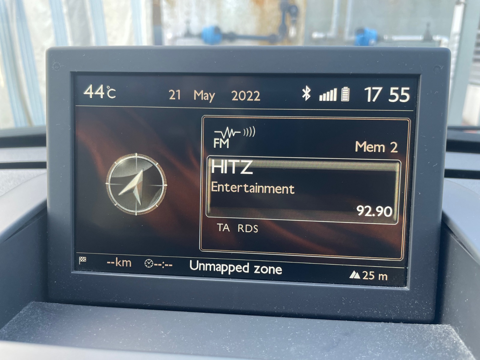

Hi Marc,
After cloning the old SD card, I go through the files in the copied folder. Saw the logs in the SPY/UPG/UPG_logs.txt stating ConfigSystemVersionError : RNEG2009_EUR_2_70 != RNEG2010_EUR_2_70.
Seems like the version in this RT6 is RNEG2009 and not RNEG2010?
After digging through the upgrade scripts in the ISO, I found out that the update did not proceed due to the System Version is RNEG2009_EUR_2_70, and this can only work with RNEG2009 only. From the Config.ini, I found out that the ISO of the 2.77 firmware is for system version RNEG2010_2_70
If you have that version (CD8653), I would like to have that to reflash the fresh card.

Just want to thanks Marc and update on my progress.
I have successfully cloned the old faulty SD card into a fresh 32Gb SD card, copy some missing files into the new SD, installed in the unit, and it boots like new!
Just a precaution notice, as per advised and warned by Marc, everytime you connect the SD card to a Windows PC, Windows will write a folder to your SD card. So, before ejecting the card, make sure to perform the “delete System Volume Files folder” as described in another thread here.
What I did was;
1. Remove old card from unit
2. Mount old card on Windows
3. Mount new card on Windows
4. Launch EaseUs Partition
5. Clone all partitions as is, except for MAPPE partition, let EaseUs auto set the space
6. (This is optional. I did this because the old card has a lot of bad sectors. Do this only if you totally understand what you are doing!) Mount the firmware ISO and copy the missing files into the new card.
7. Install the new card into the unit and install into the car
Thank you again to Marc and others who have contributed a lot in recovering my faulty unit.

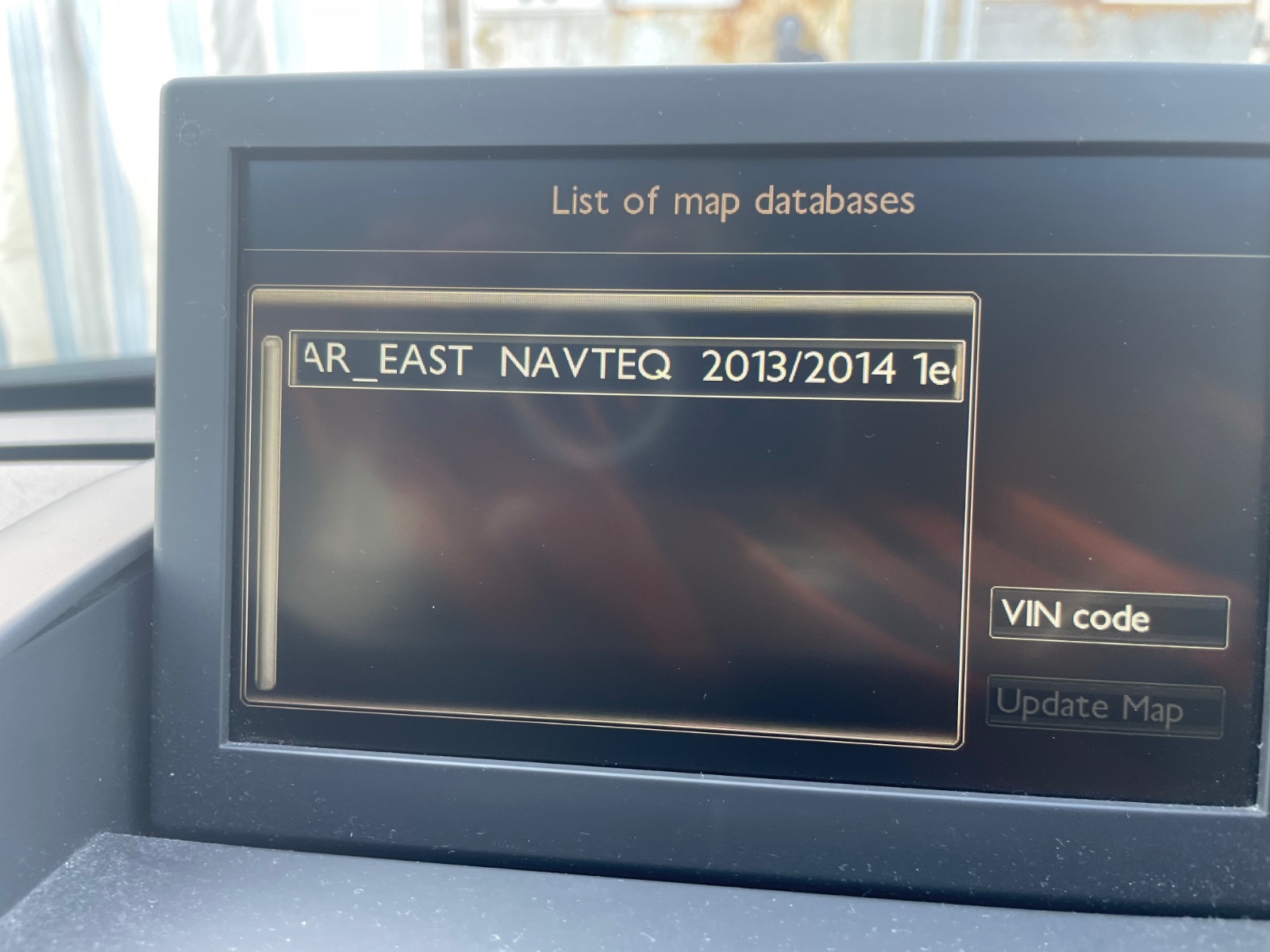

Next is looking for the latest FAR_EAST map to update my outdated 2014 map. My current house is not even in the map

As of now, my unit is still running on the old firmware 2.75 but the theme looks slightly different, maybe because I copied the whole Graphics folder from 2.80. Apart from that, everything else worked (maybe) as intended. As for the functionality available for my car settings, I assume it's the correct one, because it looks like the menu are there and I haven't restored the backed-up user_data files back into the unit yet. Only that I'm not sure if the DRL on/off menu is missing, or maybe it's not even there in the first place. If you're free Marc, maybe I can get a list of available options for my car so that I can compare what are missing from the menu.
Next, I'll make another backup from this newly installed SD, and then restore the old user_data file back into the unit. Then maybe updating to 2.80 after that. I'm still looking for the updated FAR_EAST maps to update my unit. Not sure if the new SMEG maps are compatible to be used in this RT6, because if it's compatible, I can copy from my friend's car and load it into my unit
