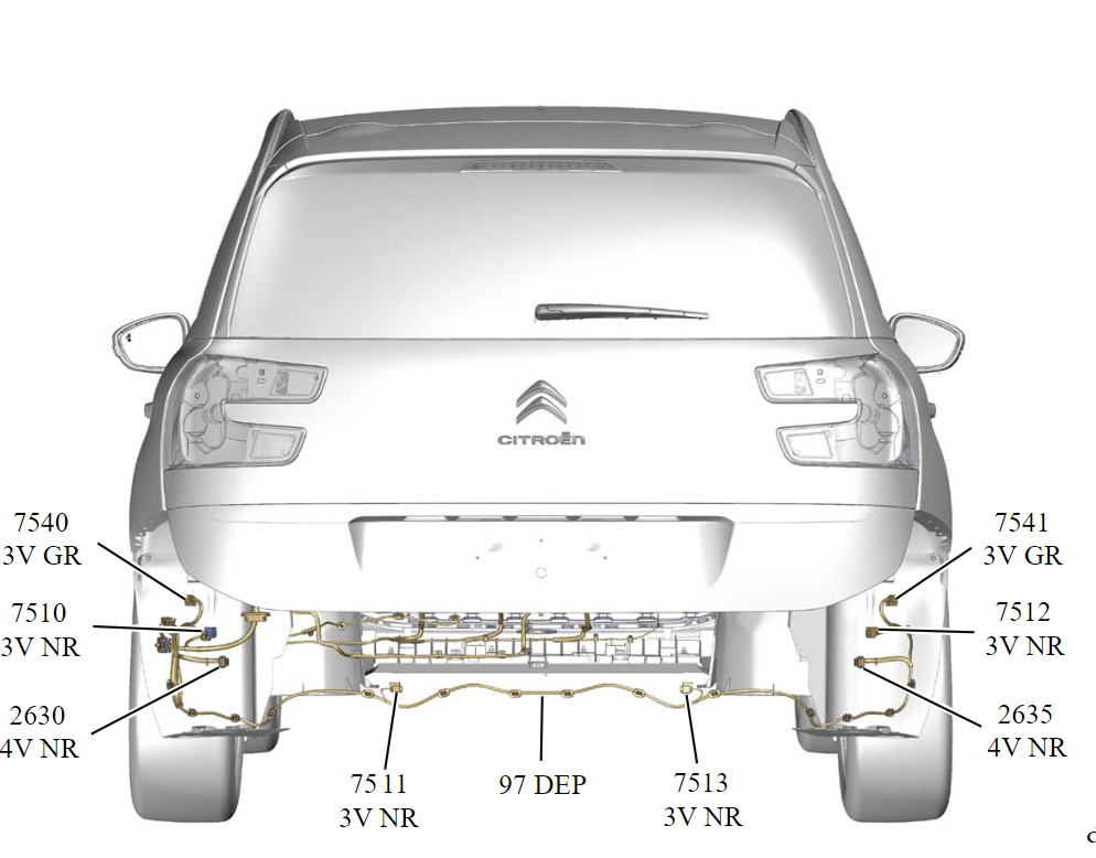

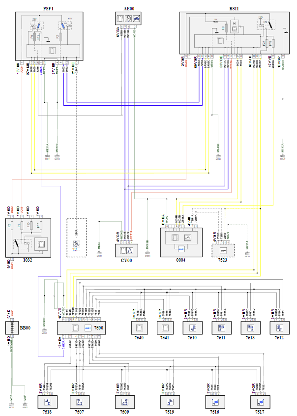

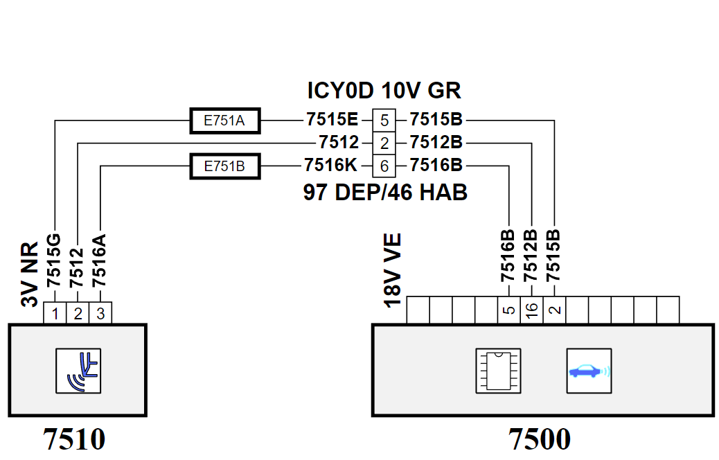

You may need to click on the images to magnify. Thought the loom may be a help as well as the connections for the sensor, then there's the overall diagram.
7510 is sensor 13 on my diagram.
