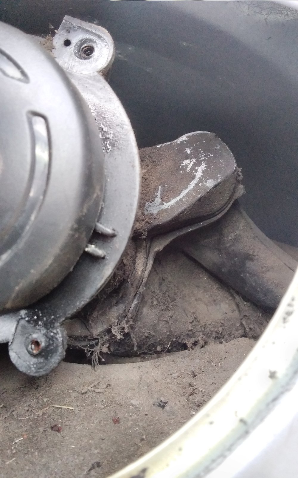

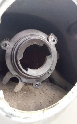

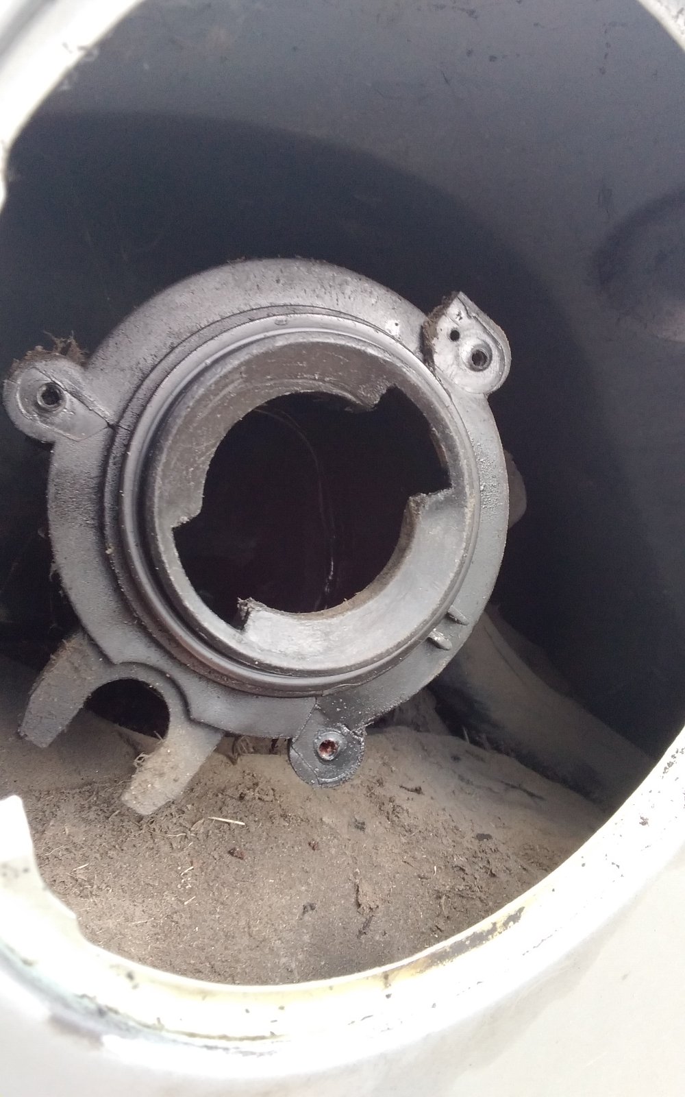

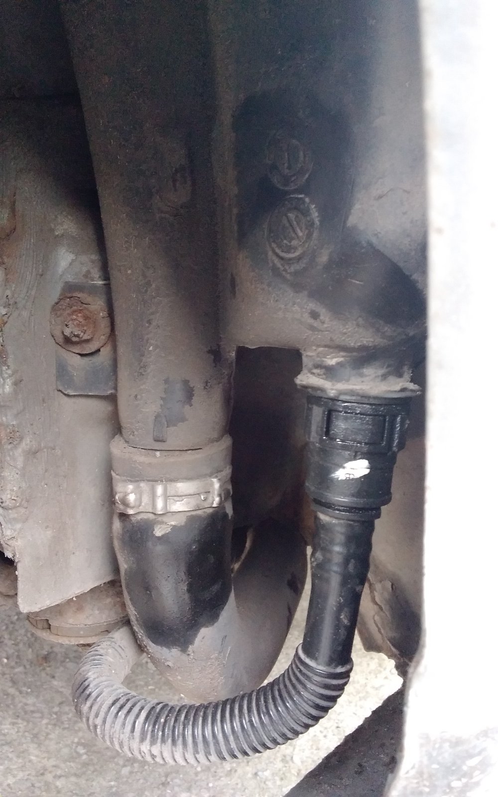

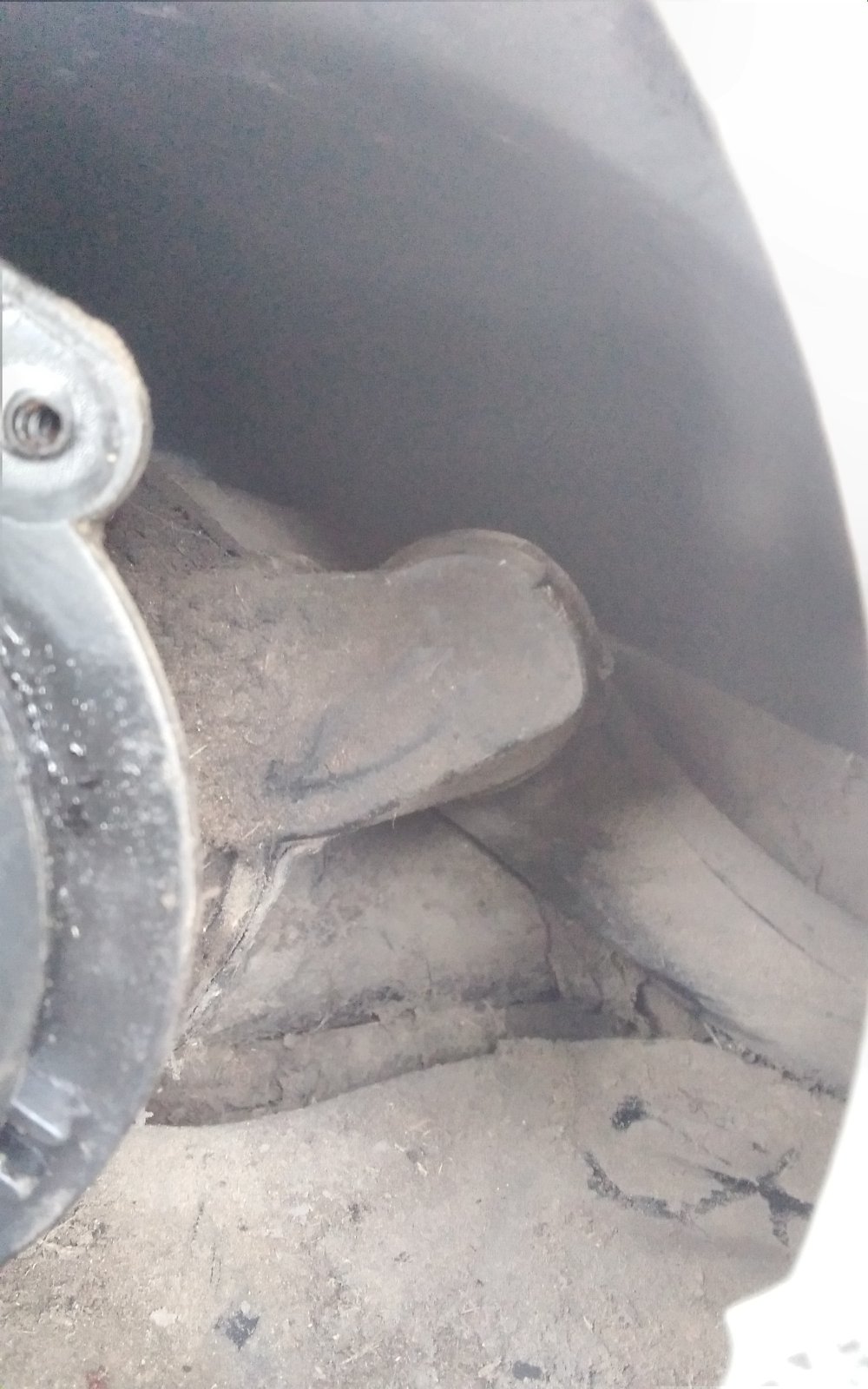

Took off the surround , give me a better view of things
Jacked up car took wheel off moved liner out of the way
Inner fuel kneck has a square type hole which is moulded with the filler kneck inlet pipe bit is seperate ,this then goes from 2inch width down to an inch it has a quick release pipe at the bottom which i disconnected and lowered the pipe and some diesel came out about 1 0z.. then stopped i wasnt brave enough to blow
The surround has a small hole but this is for rain water to drain away
As for the cap no hole either

Re: Xsara picasso tick over issue
16 mile test run . Car was normal . What ever came out the overflow/breather pipe seems to have sorted the problem .
