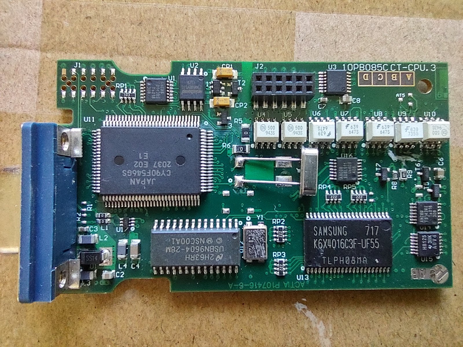

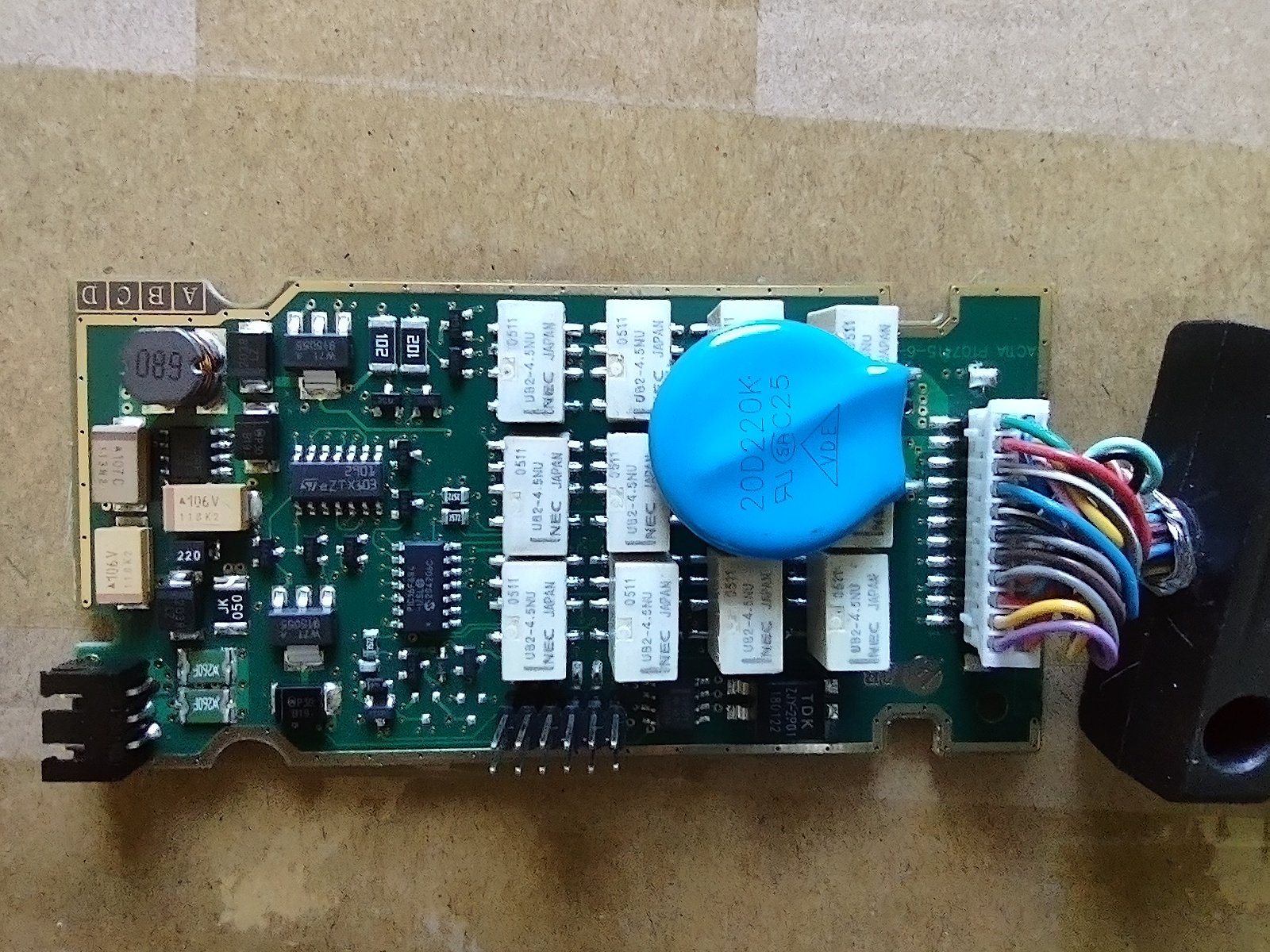

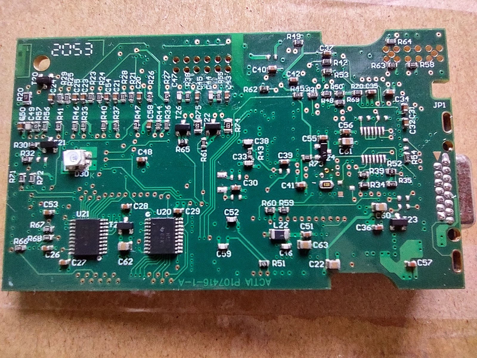

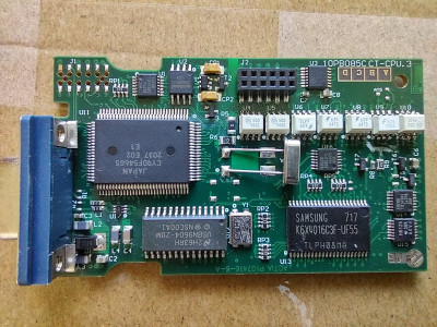

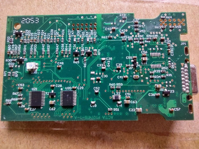

I'm happy to fix that problem but my VCI is not working fully. When I do a global scan I get the message "The ECU has not replied" for the BSI, Multifunction Display, CD Player, Instrument Panel, Airbag ECU, Radio. I'm pretty sure the car has all of those components. I found a post about a missing 10kohm pull-up resistor on the CAN circuit so I checked my board and the resistor was missing so I soldered one on but it made no difference. It still comes back with "The ECU has not replied". I also check for continuity between the board and the obd2 pins and they were all good. Any ideas what else to do?

Then it's likely they've sold you a substandard board. The giveaway is the price! A decent board from the UK will be about £100. The resistor is important otherwise you may have issues with the CAN networks. There may also be other components missing, substandard chips and missing optocouplers.

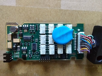

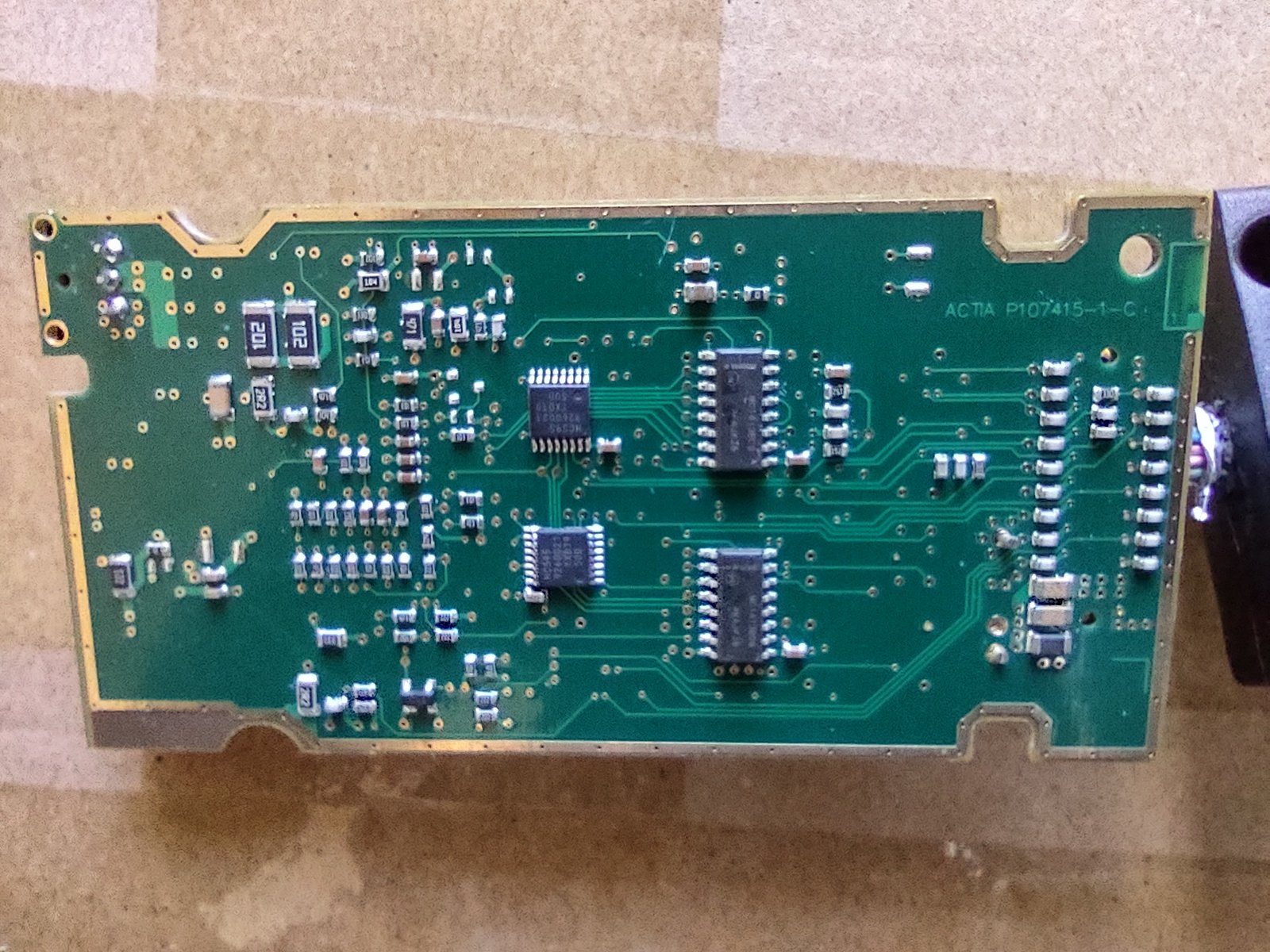

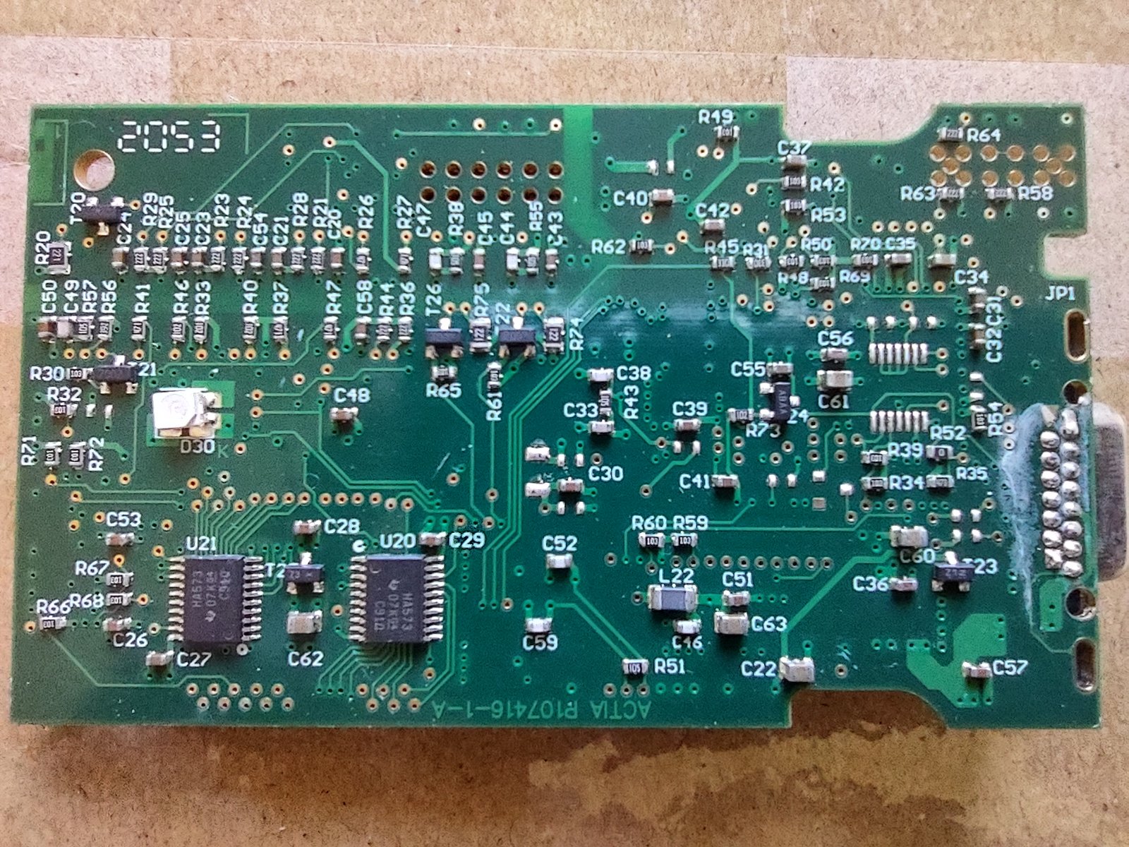

Re: Diagbox or Planet Peugeot
I attached a few pictures of the boards. I did a bit of reading and it seems this year 206 has multiplex, VAN and CAN. The tool read the engine, gearbox and ABS ECU. Maybe they are on CAN and the other things that can't be read are on VAN?
