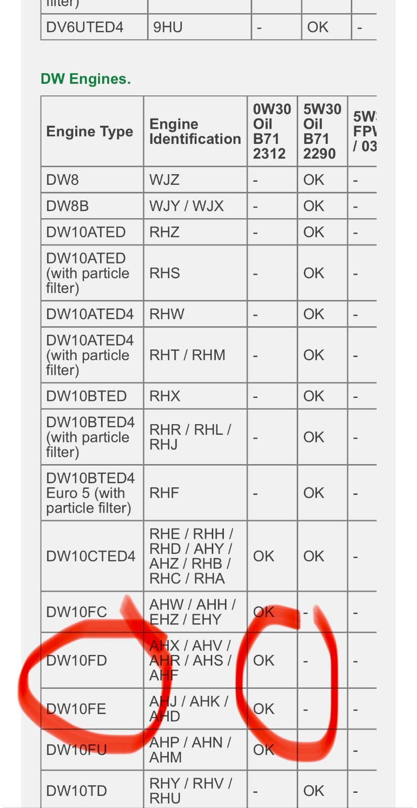

Here is the latest bulletin for it from Stellantis....
But once again it does not show my engine ID
EHT
I’m stumped
https://www.clubopel.com/revizie/files/ ... _clean.pdf
EHT
I’m stumped

The oil spec for our 1.5 hdi 308 changed from 0w/30 to 5w/30 a couple of years ago to the spec in the bulletin. Since then it rattles a bit on start up, a bit like worn tappets. It also had a recall to check it in case the cam shaft chain needed replacing.
In the bulletin against FD engines it has the following codes AHX / AHV / AHR / AHS / AHF. If yours is one of these then some of these letters will be in the vin before the numbers.

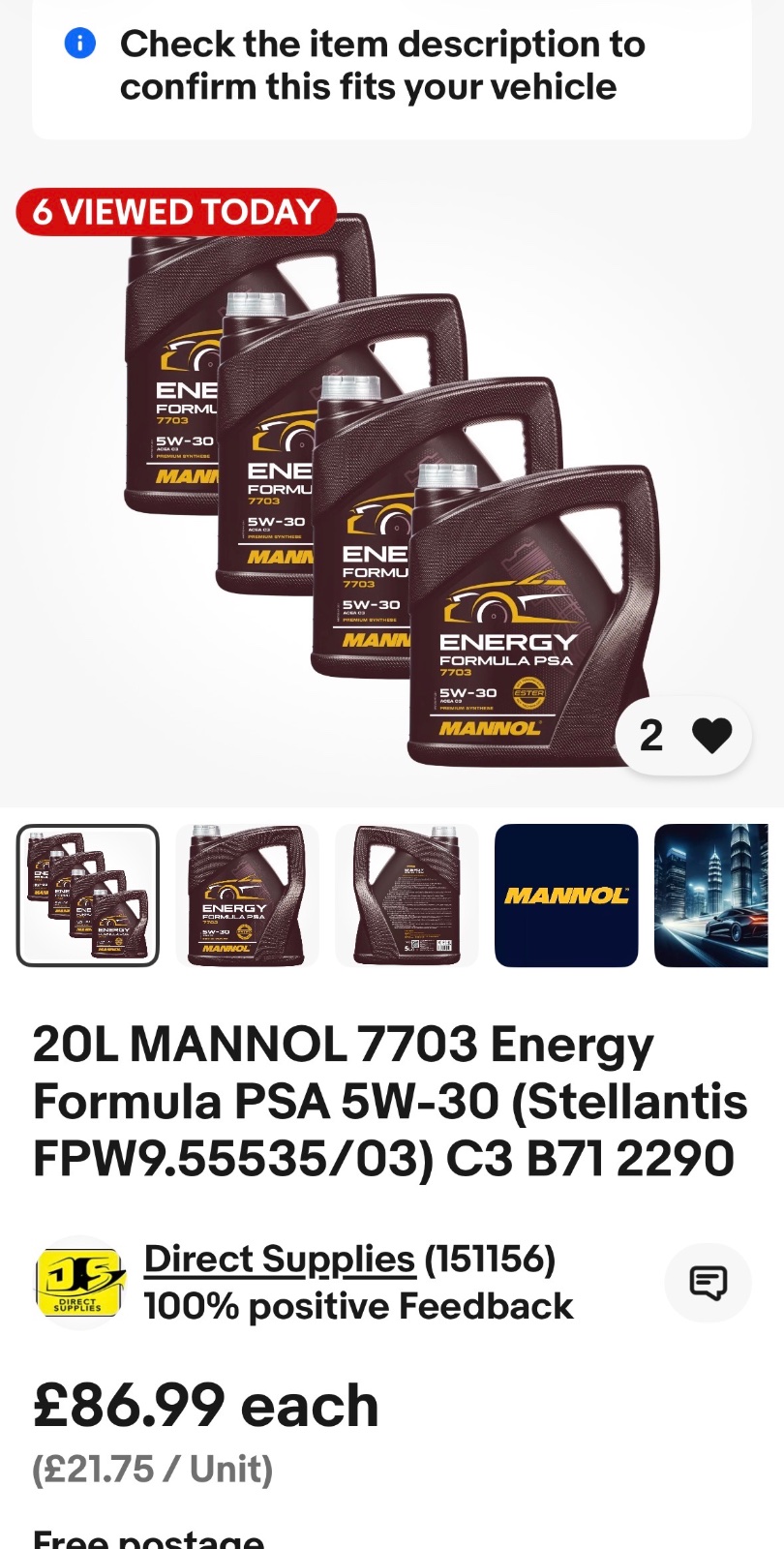

Just bought 20L. OUCH
5w30 STL
Also I believe you need to meet the FPW9.55535/03 specification.
5w30 STL

I have infact bought 20L of the psa spec.
I think I had a good deal at £87 for 4 x5L
