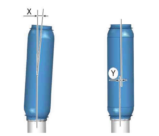

- The front flexible pipe should be protected against any external mechanical interference
- The front flexible pipe should not come into contact with any corrosive products
- Do not deform the front flexible hose by more than 20° angular (X), 20 mm axial and 25 mm in shear (Y)

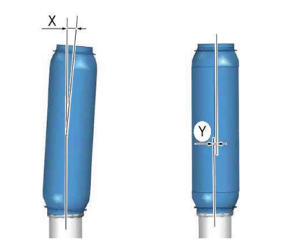

- Do not deform the front flexible hose by more than 3° angular (X), 0 mm axial and 3 mm in shear (Y) (Front flexible pipe in place)
