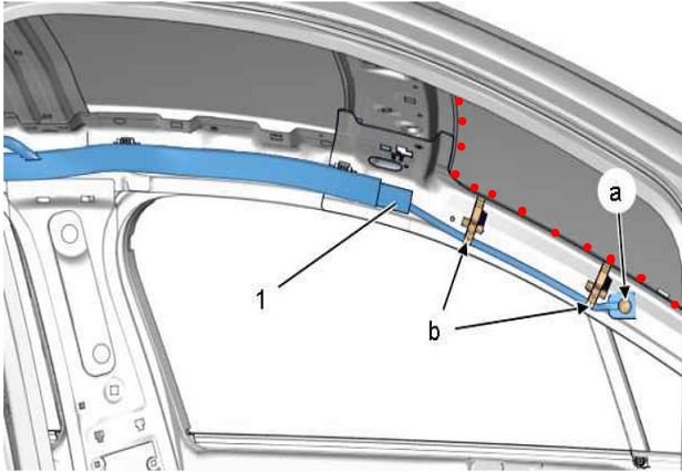

Does anyone know whether the airbags on say a 2012 C5 extend to the A Pillar? From the instructions, it does not appear necessary to route cables under airbag. There is no indication on A Pillar itself that airbag is resident there.GiveMeABreak wrote: 01 Feb 2022, 10:21 See my illustrated post here when I fitted my front and rear cameras Graeme. I cover the fuses too. Mine was a saloon, but same principle.

For the C5, I didn't take the A Pillar off, as I was able to hide the wire along the windscreen side of the A Pillar, and then across the bottom of the A Pillar down to the fuse box.
However, when I fitted a dash cam to my new Aircross, I did partially remove the side of the A Pillar due to the design of the Aircross and secured the wires behind the airbags for safety, using the existing wiring channel in there. The structure on the Aircross is a different design and the tweeter speaker is fitted onto the A Pillar, so I needed to partially remove one side to route the wiring into the existing channel.
viewtopic.php?t=68734&hilit=navitel
Back to the C5 X7, here is a picture of what is behind the A Pillar, so you can see where the side curtain airbag control wires extend to the A Pillar. I have marked in red dots where I tucked my wire behind the headlining and then at the corner, down the A Pillar edge. Note the wires were just tucked in along the edge with no excess - you don't want to tuck in excess cable, so measure and plan accordingly.
