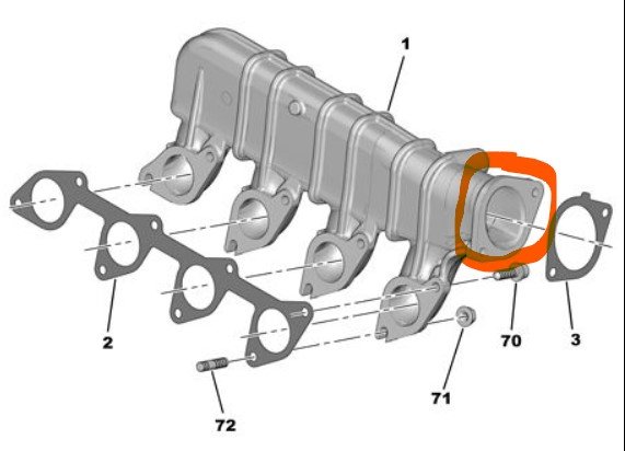

Also the intake manifolds are another suspect. I know Elis cleaned his out as they were really clogged up.
Have a look at his thread here with pics and videos on this engine:
viewtopic.php?p=584453&hilit=manifold#p584453

GiveMeABreak wrote: 28 Jan 2022, 23:42 Also the intake manifolds are another suspect. I know Elis cleaned his out as they were really clogged up.
Yep, a few i had a mk1 C5 (8v HDi) I bought it with a know head gasket fault (cooling system pressurising). When I stripped the head off it & got the inlet manifold off it was that clogged up the opening in the pic below was about the diameter of a 20p piece, the actual ports at the head end were about half there original diameter too. This is what we have EGR to thank for :evil: . It was a nightmare to clean. I scraped the worst of with a screwdriver then left it soaking in petrol overnight, next day used a steam cleaner on it & had to wear disposable overalls it was that messy.

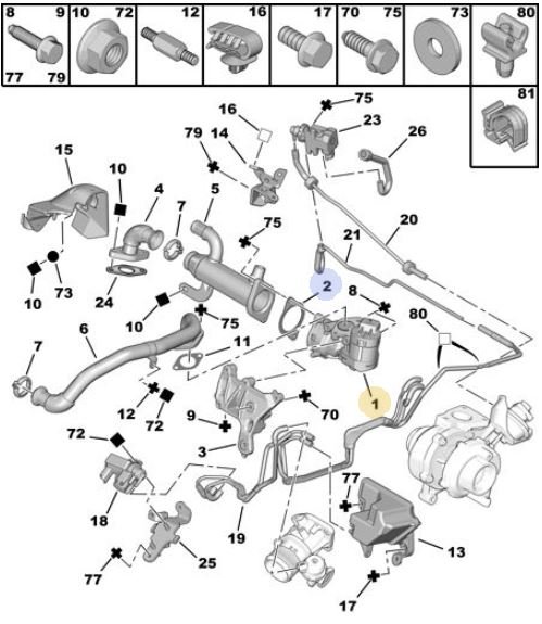

Did you get new gaskets or reused the ones from the egr?
C5 X7 Exclusive 2.0 HDi Auto
Steve Walsh
Posts: 781
Joined: 25 Oct 2019, 07:20
x 521
Re: C5 X7 Emissions
Unread post by Steve Walsh »
replaced all 3 genuine Citroen. 13 euro at local dealer
Numbers 24, 2, 11 in diagram. New clip at number 7 about 7 euro from Auto Doc where I bought my Glow Plugs
