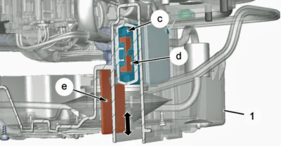

Mine is a Euro 6.2 standard vehicle and so has a stricter emissions control than 6.1 and earlier, so I can't verify the exact system used on the Picasso. On my vehicle there is a gauge contained in the actual pump as you can see:
(1) Urea pump - gauge module.
"c" Float.
"d" Float internal magnet.
"e" Level sensor electronic card.
The gauge part of the urea gauge-pump module consists of a float equipped with a magnet which moves according to the level of urea solution in the urea reservoir.
The float’s internal magnet is detected by the level sensor card which communicates the level information to the engine management ECU.
"c" Float.
