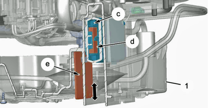

Mine is a Euro 6.2 standard vehicle and so has a stricter emissions control than 6.1 and earlier, so I can't verify the exact system used on the Picasso. On my vehicle there is a gauge contained in the actual pump as you can see:
(1) Urea pump - gauge module.
"c" Float.
"d" Float internal magnet.
"e" Level sensor electronic card.
The gauge part of the urea gauge-pump module consists of a float equipped with a magnet which moves according to the level of urea solution in the urea reservoir.
The float’s internal magnet is detected by the level sensor card which communicates the level information to the engine management ECU.
But despite the Adblue being physically measured, (unlike the DPF additive which is calculated and estimated), see below, specifically about the mileage that a warning light can still be present for:
"c" Float.
So it may be worth waiting a while yet to see if the light does go off.The urea solution consumption varies from 1 to 6 litres depending on the customer’s driving profile and the vehicle type (PSA have not specified over what distance this relates to).
The urea solution reservoir capacity varies from 15 to 22 litres depending on the vehicles.
The warning is triggered at approximately 7.2 litres of urea solution remaining in the urea reservoir, but it is possible to have a warning on the instrument panel at 2000 km (1243 miles) after urea solution filling.
