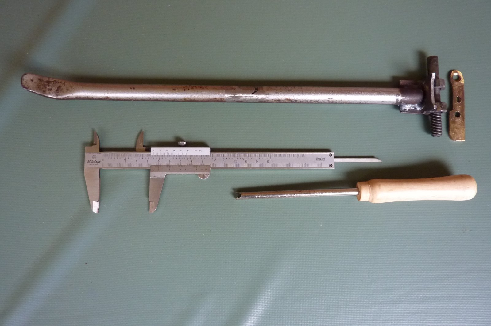

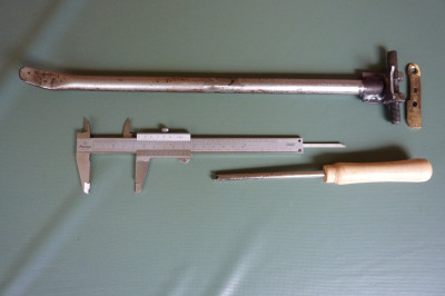

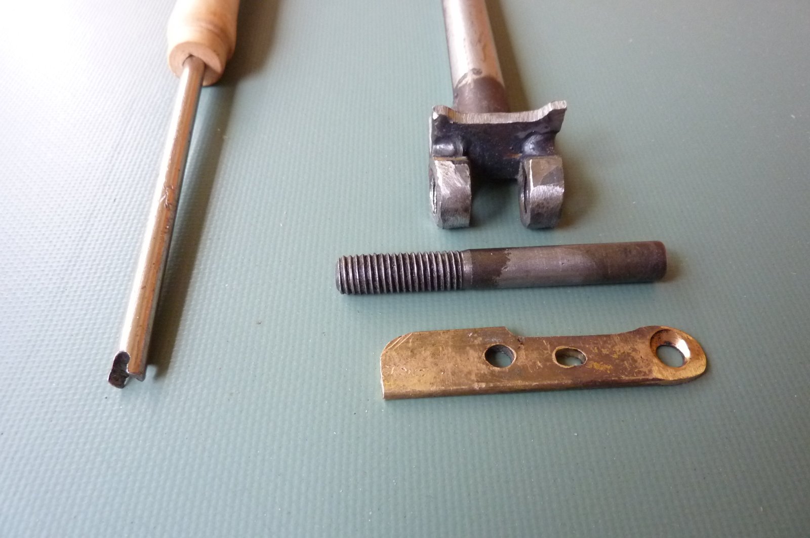

Dannyboy, I'm impressed that you found all the bits and haven't suffered permanent injury! I basically followed the method used in Pete Ledwidge's video but made up a lever like the Russians use. I have one reservation about my tools however and that is they were designed for use on the removed cylinder head. The way PSA tuck the inlet side close to the bulkhead may present problems doing it in situ although you may be able to angle the lever handle to allow for this?
The prong tool is needed to place the end of the spring arm in the correct place on the rocker arm. If you need to do this when you have bolted the spring down it requires considerable force. It's easier to place it when you have taken up about half the tension. Note that the holes in the brass spacer are incidental.

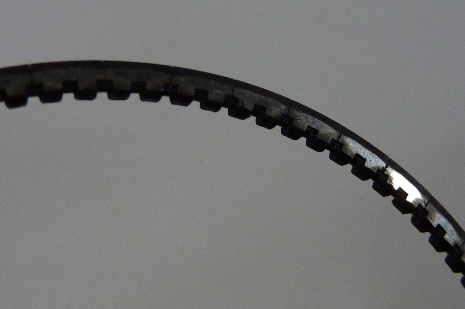

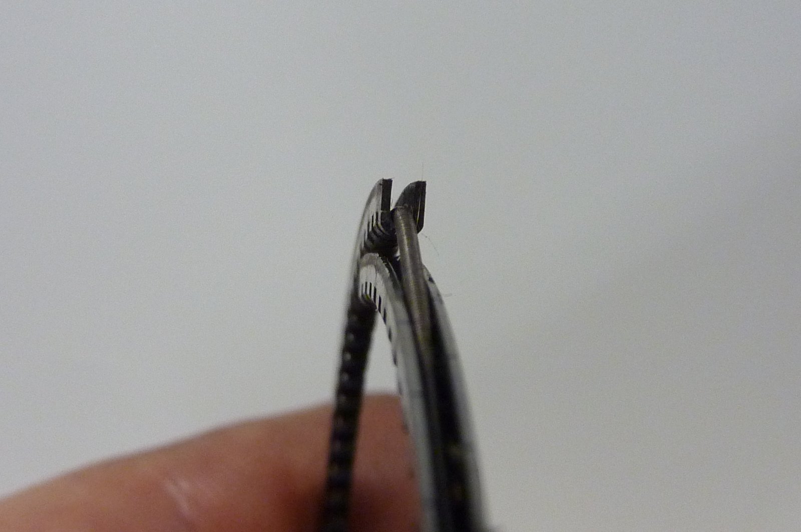

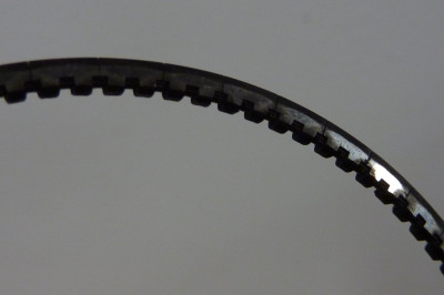

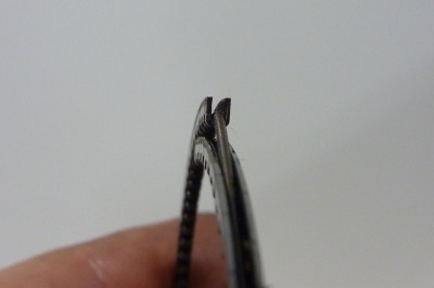

Dannyboy, I recently came to grief with a replacement engine for my 2013 BMW 118i with the 1.6lt N13 Prince engine. When I bought the car the engine had been terminally over-heated. My 2nd hand engine with supposedly 65k km came from a wrecker, but it was so heavily coked that I decided to remove the head to clean the valves and replace the valve seals. Fortunately, the head was flat and the hardness was over 100 Brinell. Also the camshaft and eccentric cam journals and bearing caps were in good condition. When I was reassembling the intake camshaft I had it completely torqued down but the variable lift springs loose so there was no resistance from the valves. I could turn the inlet camshaft easily by hand.
I think what this means is that to diagnose an intake/variable lift problem it would be efficient to slacken the inlet cam sprocket and, with the aid of a special restraining tool, remove the variable lift spring retaining bolts and then see if the inlet camshaft and eccentric camshaft move easily.
When I can make room in my garage I will revisit the cooked engine and test this method. It had a 0.012 "warp in the head and a hardness in the 60-70s so you would think that the camshafts would be under a bit of stress. Admittedly, not the journal-wear induced problem that you encountered and which all high-mileage engines will eventually suffer.
I also discovered something about the oil-rings on these engines that I was not aware of- they are an unusual one-piece design with a coil spring insert to keep them compressed. They have a diameter greater than the bore so there is no end gap, which contradicts the usual specifications given for these engines.
