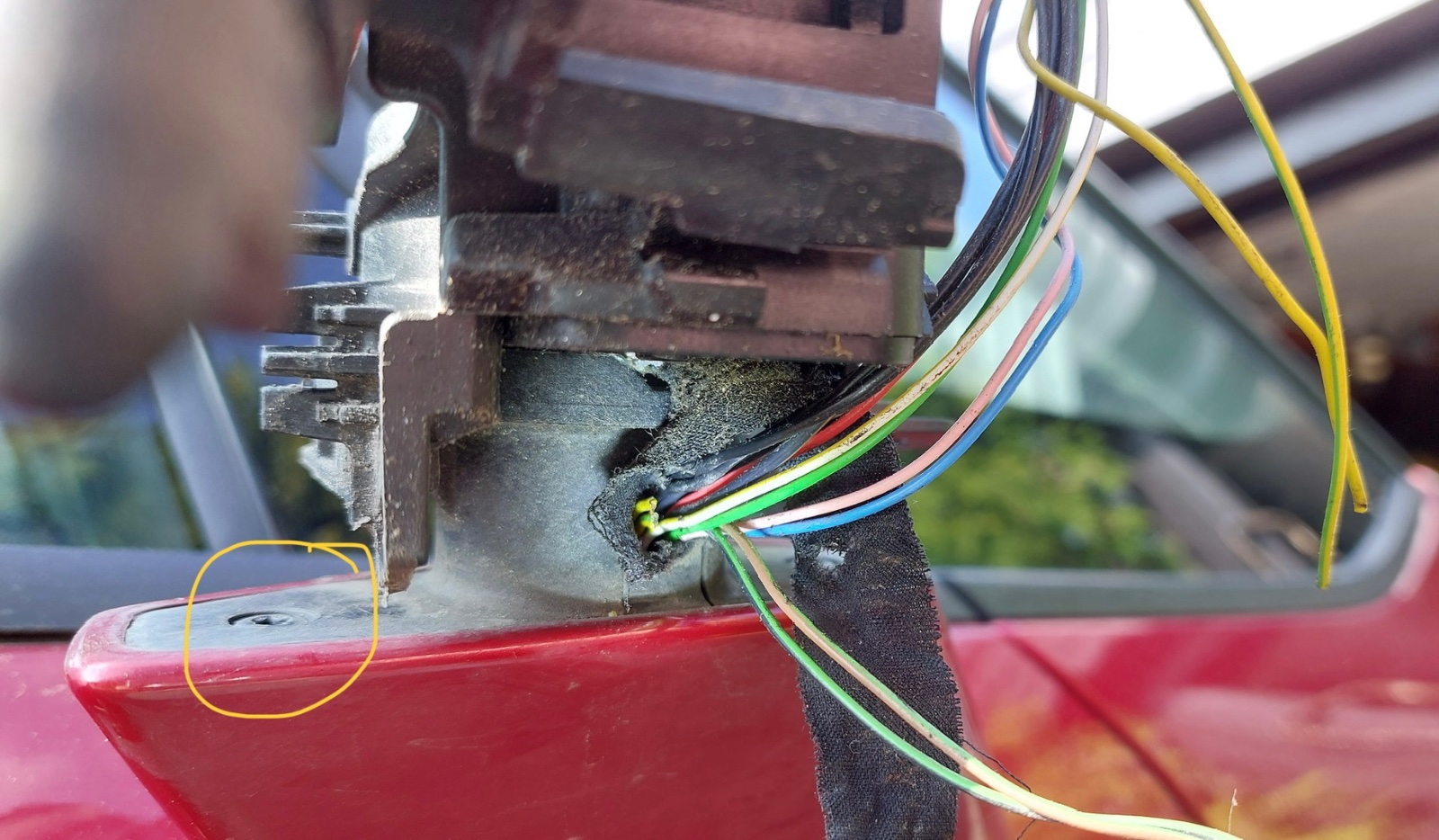

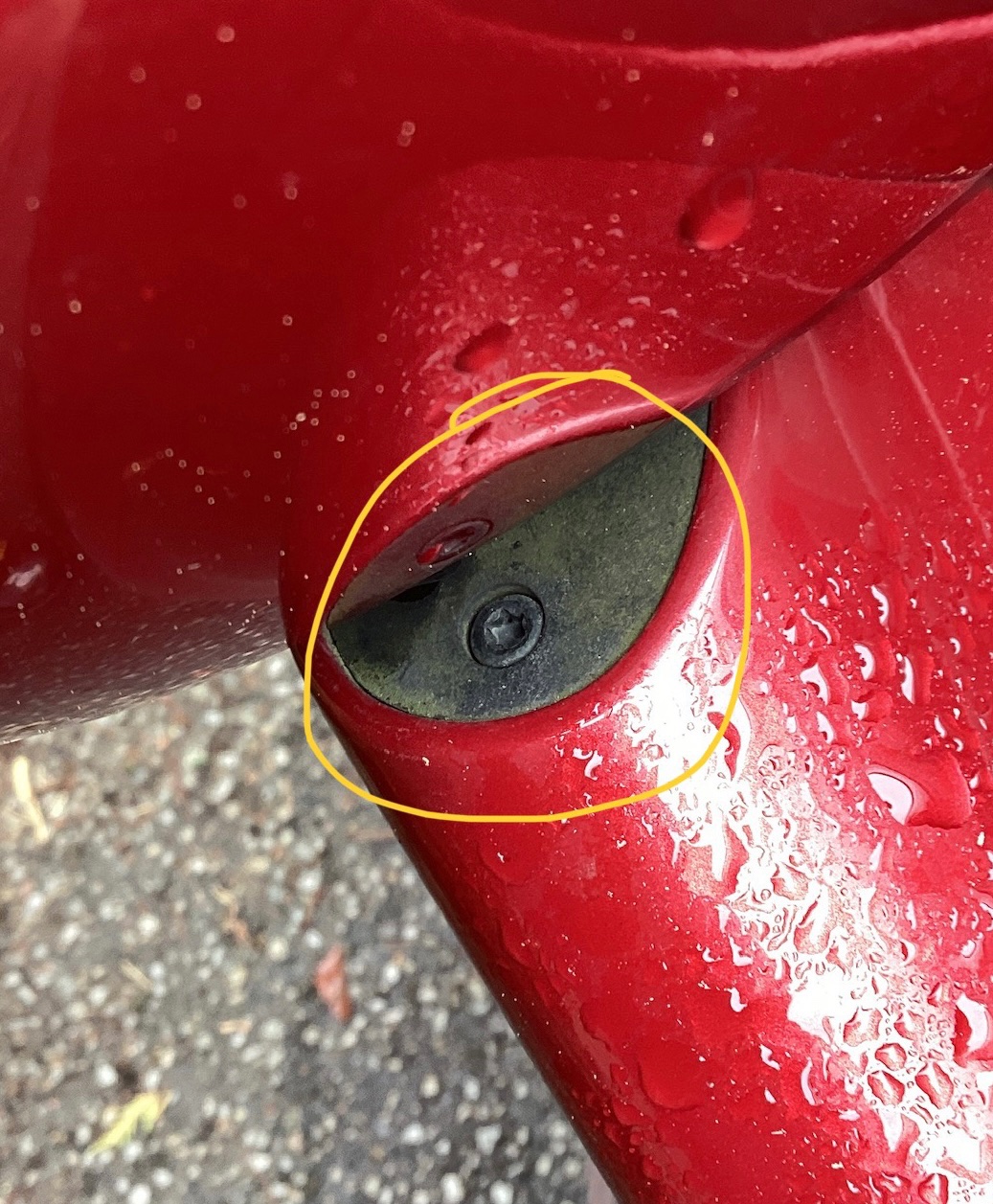

I found this thread very helpfull and I almost there, just a litte more help I. How do you get to the two torx that hold the mirror to the mirror mount? Im not used to working on cars so I am a bit cautious. After removing the mirror glas, the top, the mirror "ring" and the underside of the mirror I could only just get access to the one facing the rear of the car. The front torx was covered by one of the holders for the underside of the mirror. I couldnt see anything else too remove and the assembly didnt feel like if would give when pushed.
I have spotted two broken wires so Im confident this is the way to fix my indicator.

hi, welcome along!
Can you post a photo of what you are trying to get at?

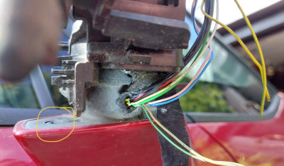

I didnt take any pictures from above while the mirror was disassembled, something to remember for next time. Ive added two pictures with the screws in question circled. The back one I could reach but the front one was covered by a clip for the screw holding the bottom where the guiding light sits. I think these screws have been removed in the pictures posted by robbie2015 and wiseguy. And I think these are the torx mentioned in zane2g2s description.
