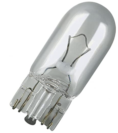

That's what I'm talking about Colin - internal lights. The stock bulbs are the filament capsule type W5W shown here:

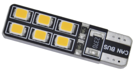

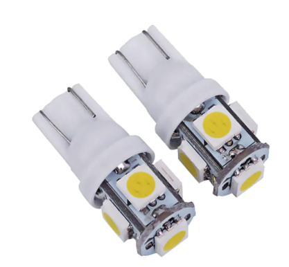

However, if you have replaced these with any of the following LED examples, then I'm suggesting you rotate them 180 ° horizontally as some of these only work with the correct polarity.
