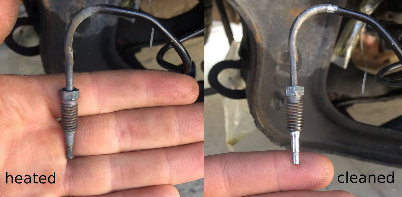

i heated and cleaned residue and polished the end of pipe to have better seal

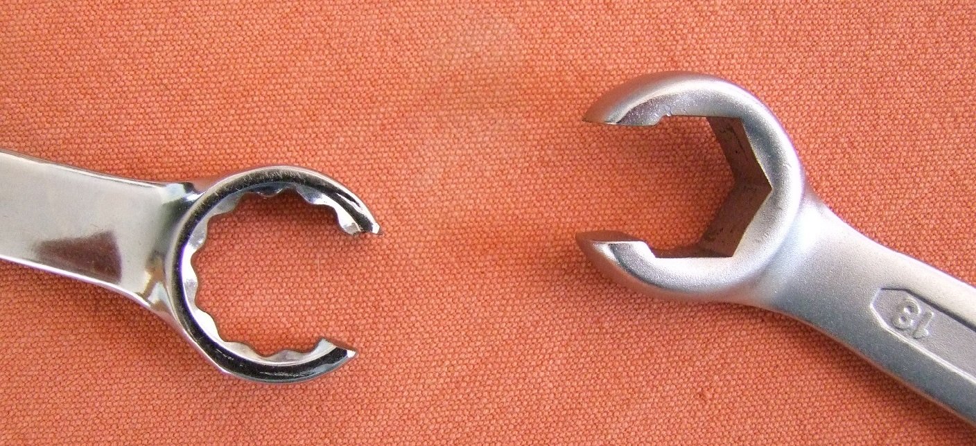

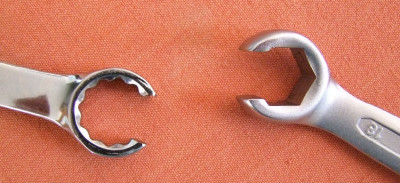

To avoid damage to these small soft steel unions by using an open-ended spanner, you can either buy a set of single-hex flare-nut spanners...
or make your own from a standard ring spanner, cut-out just large enough to fit over the pipe...

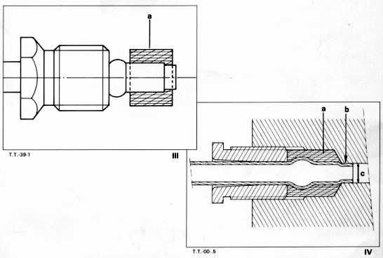

Datadogie, the type of joint above is unique to Citroen, and with its rubber sleeve is actually designed to seal even more firmly under pressure. The tool kit to create the "built-in" swage (in several sizes of pipe) is available from a few companies, but isn't cheap. Citroen have used this type of joint for around 50 years now.
Two varieties of it shown here:
In both cases, the nut pushes against the swage, pushes the pipe end (b) into the component, and forces the rubber sleeve (a) to firmly fill the space under the nut.

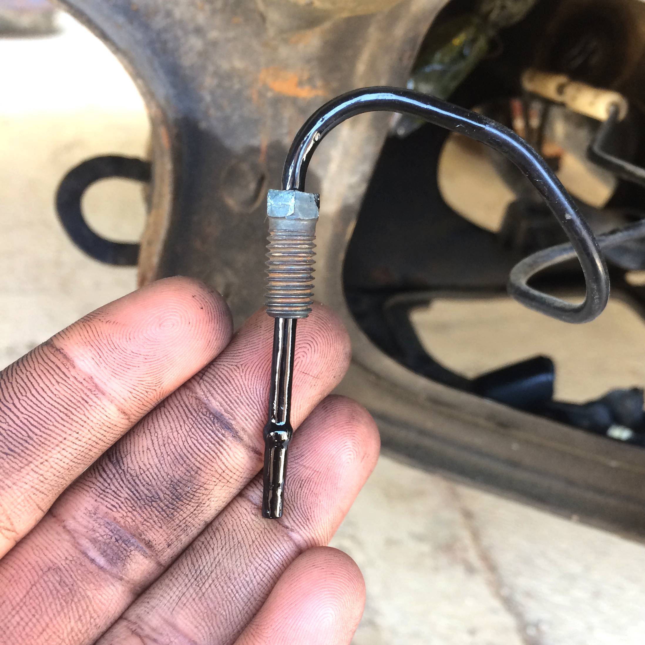

i painted that with epoxy paint. look how shiny it is!

saeedm wrote: 02 Oct 2021, 17:46 i painted that with epoxy paint. look how shiny it is!
WOW!
Did you spray that or brush it on? Impressive.
I am about to replace some pipes in cupro-nickel and want to make them look genuine. I did consider using heat shrink tubing as someone else has suggested.
With epoxy paint, I could actually buy cheaper pipe presumably and simply paint it. More labour though...

I would not put the seal end (forward of the bubble) in the hole with paint on it.

Stickyfinger wrote: 29 Mar 2023, 19:38 I would not put the seal end (forward of the bubble) in the hole with paint on it.
Agreed.
