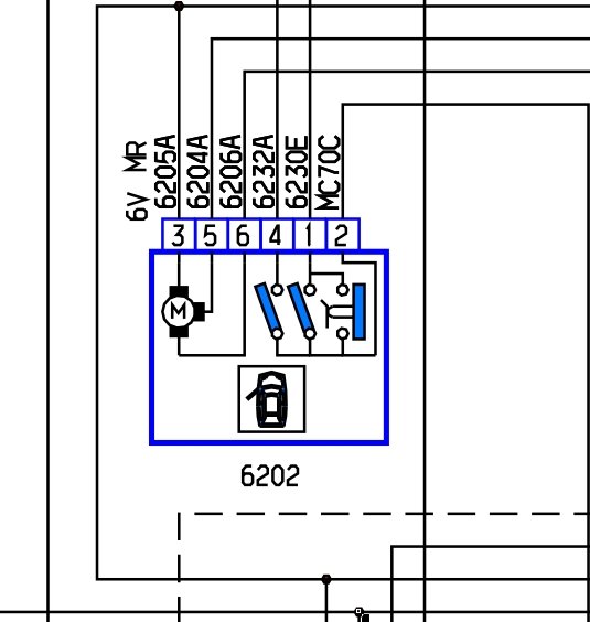

Hi,
Newbie. I have similar problems. My car is just Peugeot 307, 2004. Also with deadlocking.
Just fixing door locking. Reason of remote control never worked, I must use key. The lock and key are worn out. I had to disassemble the lock. A little sanding, grinding, adjusting.... One drawback of the lock was so worn out that it had to be remove. Now it work.
1. But. I bought this car many, many year ago, and remote control never work. I replace battery, of cource. Is it any way fix it? If it my remote is not broken... is it any way to register it to BSI?
2. (And... where BSI is? Backside fuse box?)
3. I read schematic.
How this work? Motor I understand. But switches are not clear. Look it is three switch: common is pin 2. One switch in pin 4. Second switch in pin 1. And pushbutton parallel with it. So... how this combination work? What happen when use key etc?
x 6954
