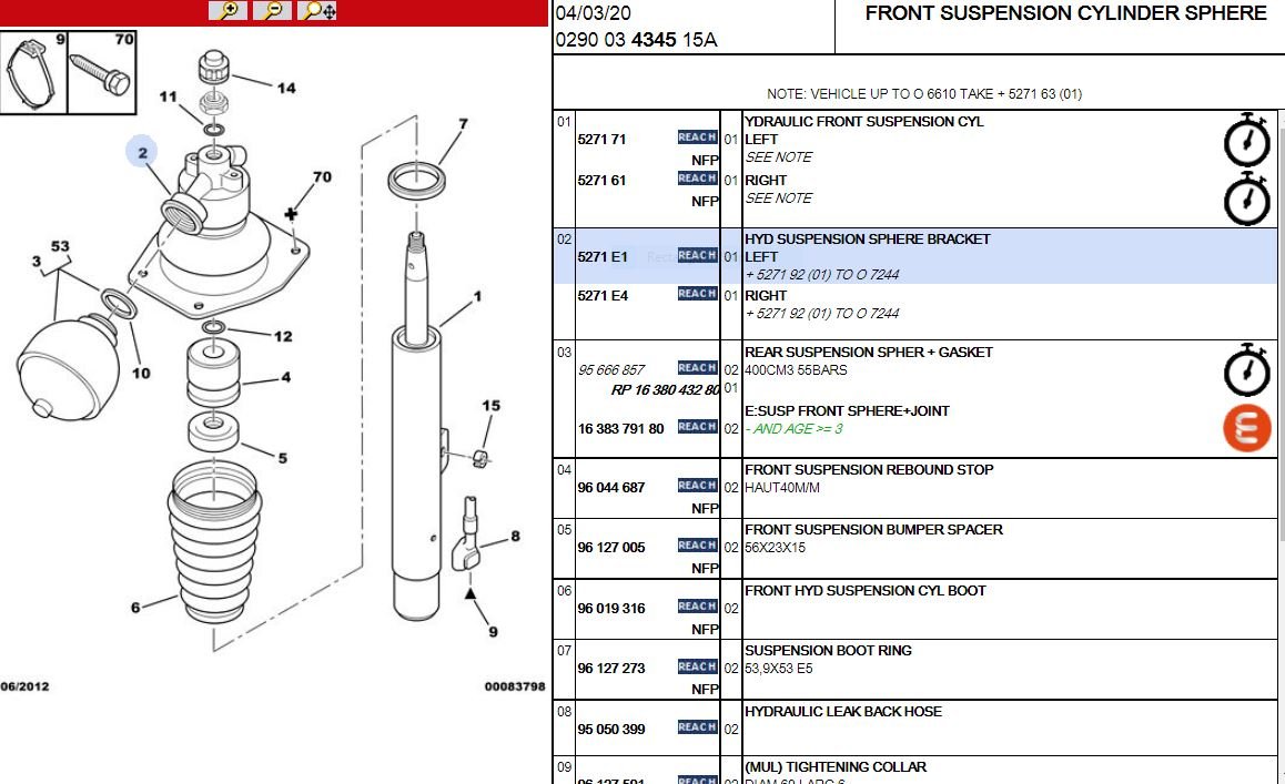

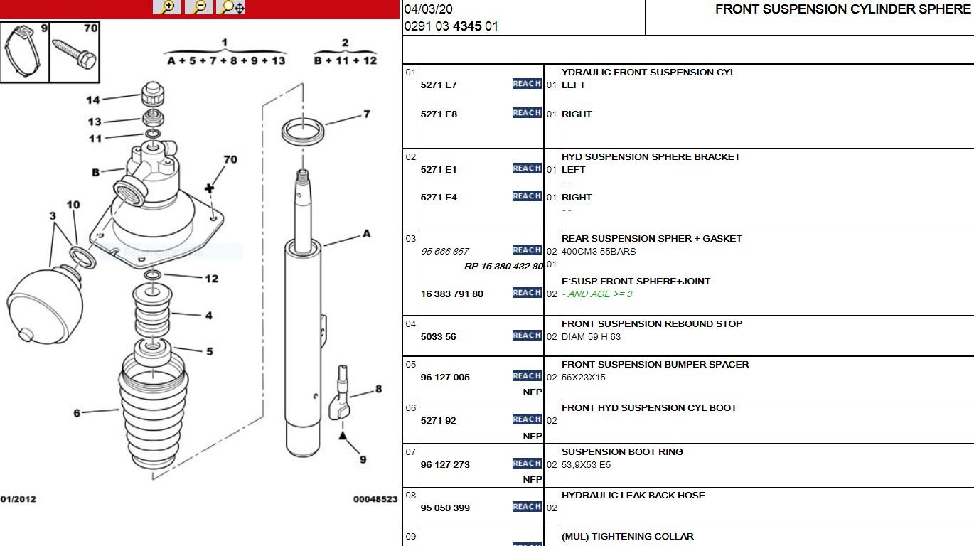

Hi Roger,Rhothgar wrote: 05 Aug 2021, 22:02 Do Citroen still sell top mounts?
If so, what price is 5271 E4 and 5271 F6 please? I’m assuming that right means offside in the strut mount table otherwise I need the left one.
My offside one looks ready to collapse. Lots of daylight when putting alternator back in S2.
From your VIN ending 7785 (=RP6463), Parts has both L & R strut tops still available, which is amazing.
Not quite the part numbers you quote, but this is the correct page for the VIN: Left and Right are always as seen from the driver's seat, not from the front.
Elastomer are the place to go for exchange/your own tops rebuilt. They do an excellent job. Full details on their website.

white exec wrote: 06 Aug 2021, 07:15Hi Roger,Rhothgar wrote: 05 Aug 2021, 22:02 Do Citroen still sell top mounts?

Re: Citroen 1.9TD Front Sphere Pressure
OK. Start again.
Both still available from Citroen...
Item #2 in the diagram
