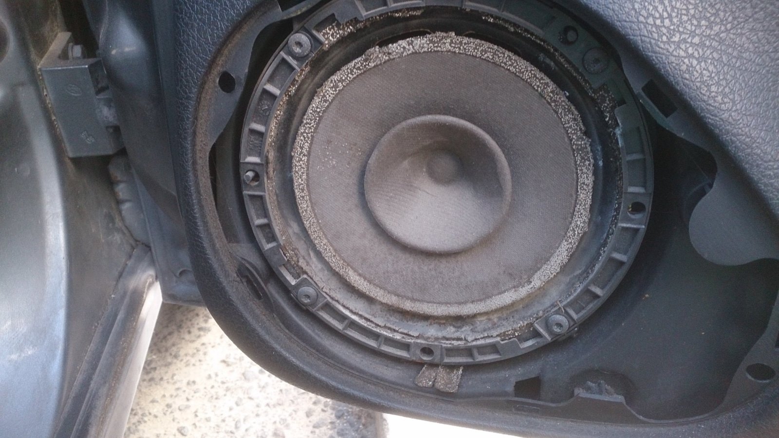

UPDATE:
- FIXED: bad sound from front speakers: the problem was easily identified when I took the grilles off: the speaker membrane had lost its rubber connection to the outside ring, look at the photo, I can't describe this better. It had simply rotten away
I don't think this is supposed to happen after only 24 years, but.... maybe this is even a known issue with these speakers for this car... anyways, I was lucky enough to have stored the original speakers of my previous car (in which I installed a better sound system, with 2-via speakers (installed little tweeters on mirror triangles), it only had these single full range speakers in the doors) and they were the right size! But: I had to cut off with a saw a lot of plastic on them and drill new holes so that they would fit. I eventually succeeded and got them installed. Success! Great sound, too. Much better than I expected, in my Lancer they didn't sound that good, but then again, it didn't have tweeters (and here the tweeters fortunately didn't suffer the same premature death as the speakers in the doors), so that might explain the better sound. So, I'm happy to have music back in my car, and this one I got fixed at zero cost!
Now, one day I have to order two small speakers for the rear, they have the same defect but even worse: they died completely, no sound at all. But that's no priority right now, have other more important stuff to do: A/C compressor arrived last week and was well installed by my trustworthy mecanic, now on Tuesday I have appointment with A/C garage to change the dryer filter and vacuum and charge the system. Hopefully then finally the A/C will be fine. Fingers crossed!
That's how the speakers looked...
