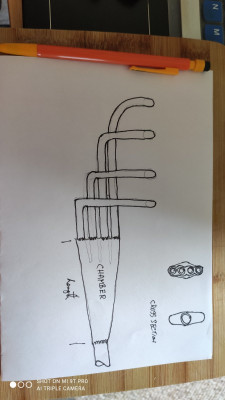

no. can't find a photo so will draw it instead.

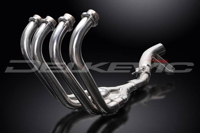

I think your describing something akin to most motorcycle manifolds?
Cool.

Try this and see if it might work.
The 4 pipes arrive at a collector box vertically in line ( or whatever angle to suit space available). Notice how the furthest away pipe goes straight to the chamber. The next one goes over the first pipe giving you a chance to get a matched length.
The third one goes over the first two giving you a chance to get a matched length.
The fourth one goes over the first three giving you a chance to get a matched length.
Pipe 1 is a tuned length and bore. Pipe 2 should be curved to fit and be the same length and bore. Pipe 3 should be curved back and forth more to give the same length and bore. Ditto pipe 4.

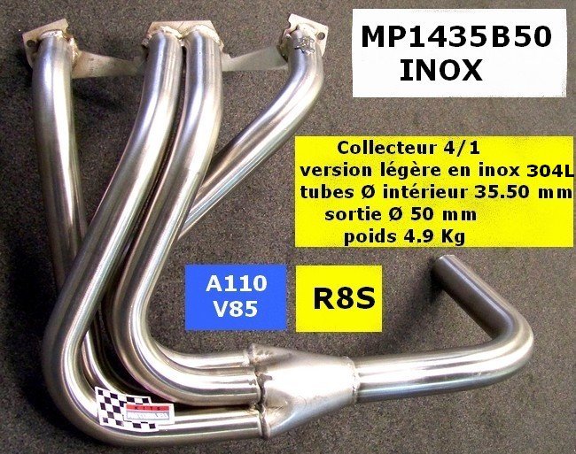

For a 4 stroke, 4 cyl engine the cross sectional area of the outlet pipe should be twice the area of the primary pipe to maintain gas flow speed ( like the 35.5 and 50 mm pipes in the photo you sent). They need to be calculated for your exact engine requirements. Normally you use the nearest diameter of standard pipe available unless you can seriously afford custom sized pipework.
The Chamber can be very short a la "square" 4 into 1 in the photos you have put up or you can take the opportunity to match the chamber volume/length as in 2 stroke exhaust technology. The fishtail could also curve and the outlet does not need to be in the same plane as the primaries/block side. What is important is to maintain tuned pulse lengths/volumes and gas flow speeds. Ideally the total length of the exhaust to the very end should be calculated to finish to aid pulse return waves.
I hope this makes a bit of sense. And, yes, it is a science in it's own. Good muffler/exhaust designer is a very clever person.

In this picture pipe 2 and 3 are obviously different lengths and ideally 3 should terminate where 2 goes into the 4 into 1 collector (and 2 for 3) to get equal tuned lengths and 1 and 4 should be shaped to match the tuned length if this was a perfectly designed manifold. Problem then would be space to get all the extra curves in. This one is the best, simplest manifold design that fits the Alpine without fouling issues but is slightly compromised in designed tuned length primaries.

Yes, sort of. This manifold is actually a 4 -2 -1. Look carefully and you will spot two "Y"s in the first part of the collector then into another "Y"bowie wrote: 08 Jun 2021, 15:27 I think your describing something akin to most motorcycle manifolds?
Cool.

And without being too picky, the collector looks like it is struggling to provide tuned lengths and gas flow speeds although it is the right kind of basic design. Time to pull my neck in now and put my tin hat on.
