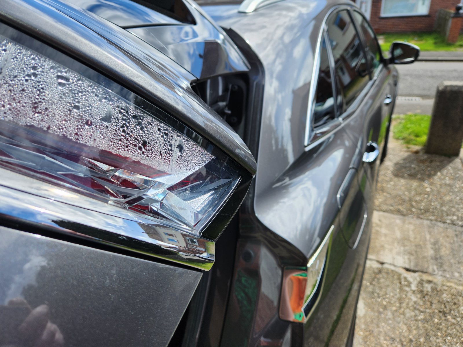

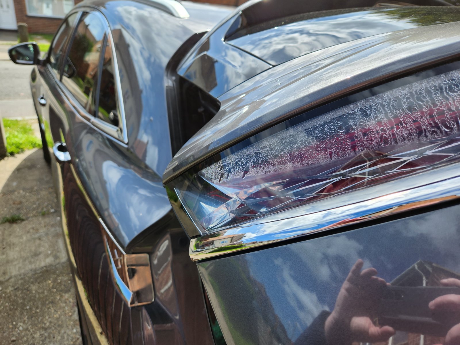

Heh, ok ask Give Me A Break (paid option) he can check in Servicebox if your vin number is flagged (lamp recall etc). Mine was flagged in Servicebox, but on ds website wasn't ))) Got a booked visit in DS Leicester on 9th May. After 2 years of having nice dry rear lights, now got a nice aquarium))))
