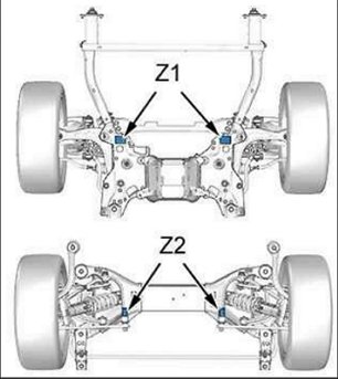

That all sounds cautious and sensible, and what any good mechanic would do if aiming not to damage sills or bodywork.
My only exception would be to initially jack up (trolley jack) either at Z1 in your drawing, or further back along the flat part (below Z1 in the diagram), and then also place the padded axle-stands there.
Placing heavy card (or wood) between jack pad/axle prop and a flat surface is a really good tip, not just to avoid damage, but also to provide extra 'grip', and something for the steel surfaces to bite into.
I think Citroen's cautions about jacking probably have roadside owner wheel-changing mostly in mind, rather than any serious attention to the underside.

I also have a jacking beam I made for the rear subframe,
Home made version of
Sits on the two aliminium 'Lands' Z2 on image supplied by coarist
https://www.ebay.co.uk/itm/284308183099 ... Swim9gpPNk

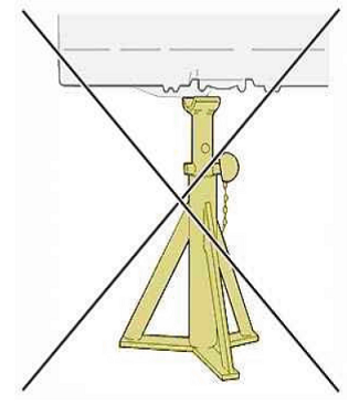

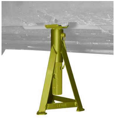

Hello everyone,GiveMeABreak wrote: 21 May 2021, 15:27
Incorrect position of the axle stand
Correct position of the axle stand
Just bought a (quite negleted) C5 X7 and I need to adress some things on it that will require jacking. I undestand that it is forbidded to put the jack stands under the jacking point but I cannot identify the correct location from the manual picture. Can anyone tell me where this is exactly or if you have a picture with the actual location on the car, it would be great.
Many thanks.
