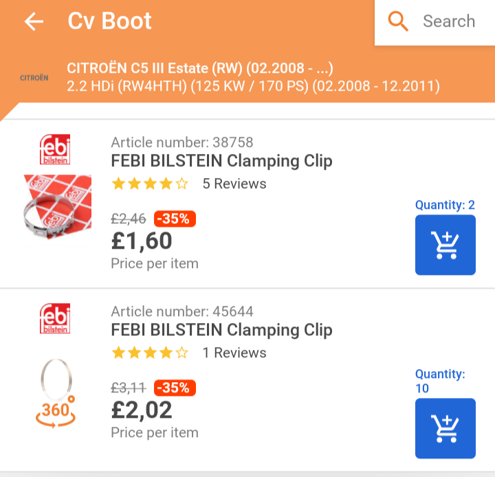

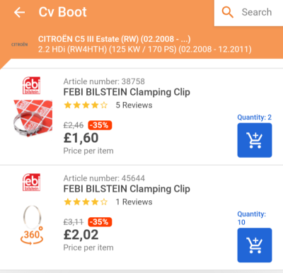

I have seen replacement bands on AutoDoc's site will see if I can find them.
The band's I have fitted (as part of CV boot kits variously) have all been steel or stainless steel. I've a thought the X7 bands might be aluminium - going from memory from the gearbox out job I did on mine, so interaction with the driveshaft was limited to getting them out the way.
- Posts: 5359
- Joined: 25 Apr 2022, 09:03
- x 2364
Re: C5 X7 - Drive Shaft Boot Clip - Take a look at yours!
Ahhhh, now I recall why I didn't buy any from AutoDoc
Good price, but pay attention to the order quantities on right side!
