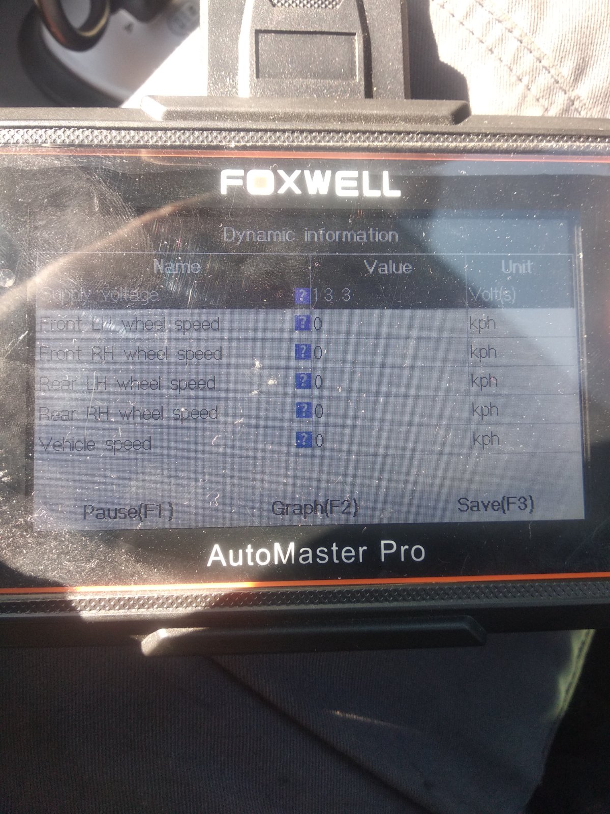

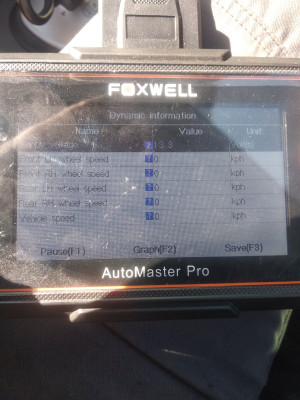

alex_alex wrote: 13 Feb 2022, 15:39 I have exactly this problem my car Citroen c2 1.6 vtr petrol. I can't not found problem. I chege abs sensor.
Abs pump and not resolved.
Did you change the pump and ECU or just the pump (or just the ECU)?
It is very unlikely for 3 of the 4 ABS sensors to fail at the same time! So I would look much closer at the electrical connector at the ABS ECU for corrosion or a bad contact.

So I find problems abs . :lol: :lol:
It's bee poor contact abs sensor and I repair contact abs. And now it's work abs.

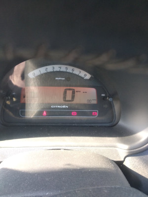

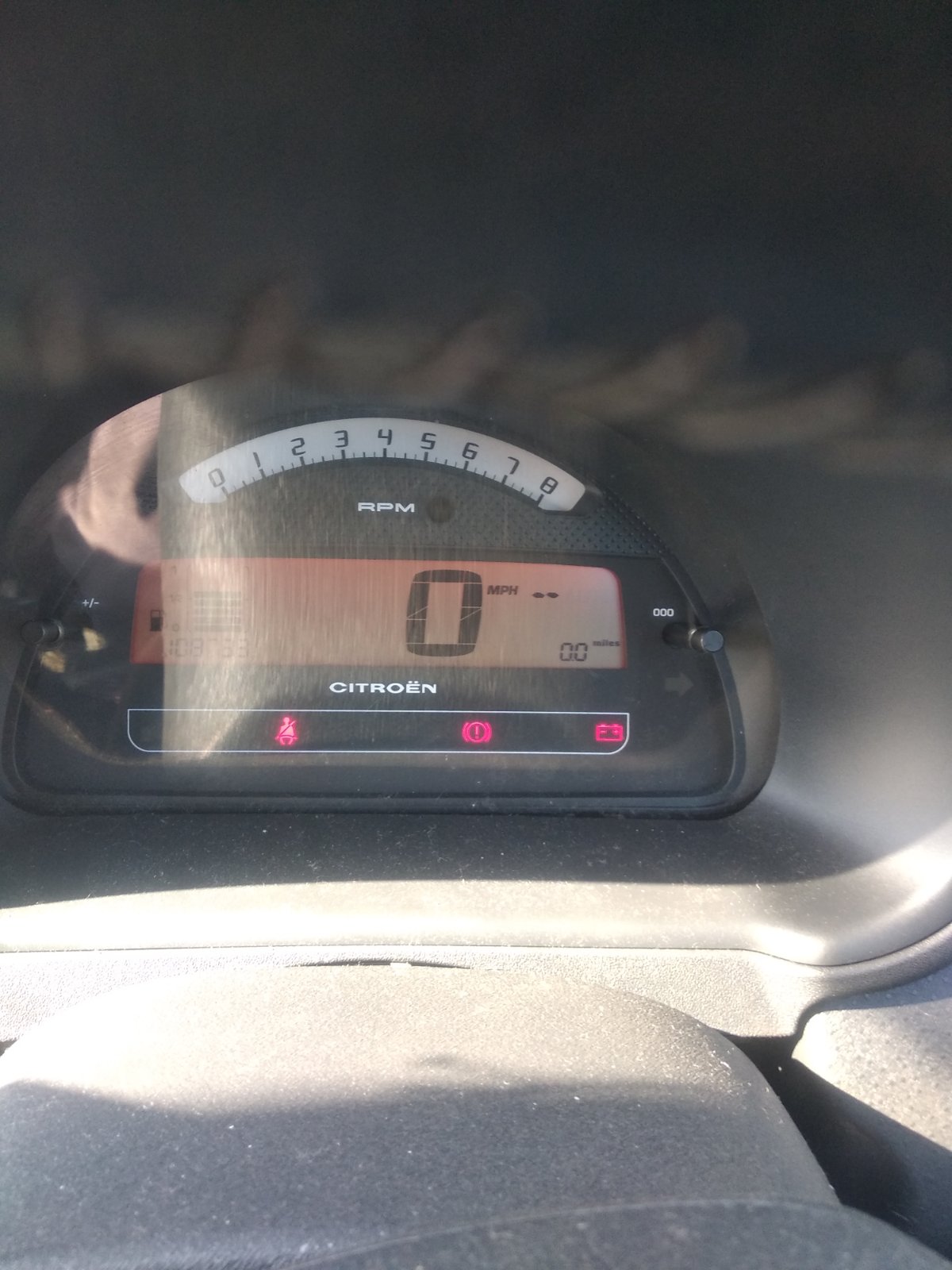

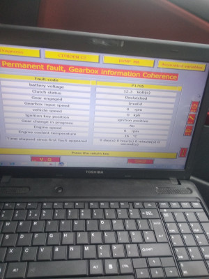

Hi Guys.
Please need help cod error P1795.
Stuck in ""Auto"" not can't put in ""N""
Last error cod.
Thanks
P1795
P1795

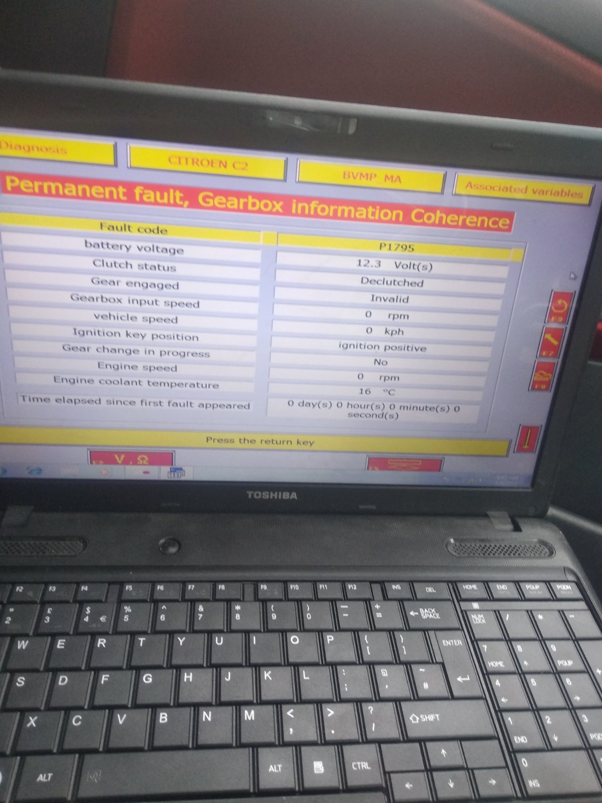

Re: 09 Citroen C2 1.4 Electrical Issues
Looks like you need a new gearbox actuator as it's reached the end of service life. According to the fault it has reached over 1 million cycles. A new one is just under ยฃ1200 excluding fitting.
Fault Code: P1795
Description of Fault: Gearbox counter information: Coherence. The number of engagements and disengagements of gears has exceeded 1000000 cycles.
Conditions for Fault to clear: Following replacement of the gear engagement actuator.
Downgrade Modes whilst Fault is active: -
Symptoms: -
Suspect Areas:
  • Gear engagement actuator
  • Piloted manual gearbox ECU

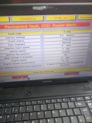

I another problems after I tried update gearbox after it's show me this Fault code P1702. Please ๐Ÿ™๐Ÿ™๐Ÿ™๐Ÿ™๐Ÿ™

Exactly in manual following instructions and nothing chenge. no click. No clakt. No krik. nothing . Battery 14.3 V
Flashing ""Auto""". Not ""N"". Just tow ""- - "" and that's it.

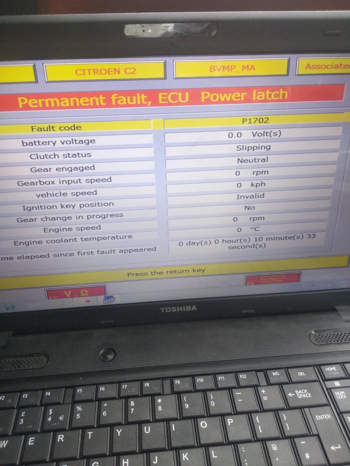

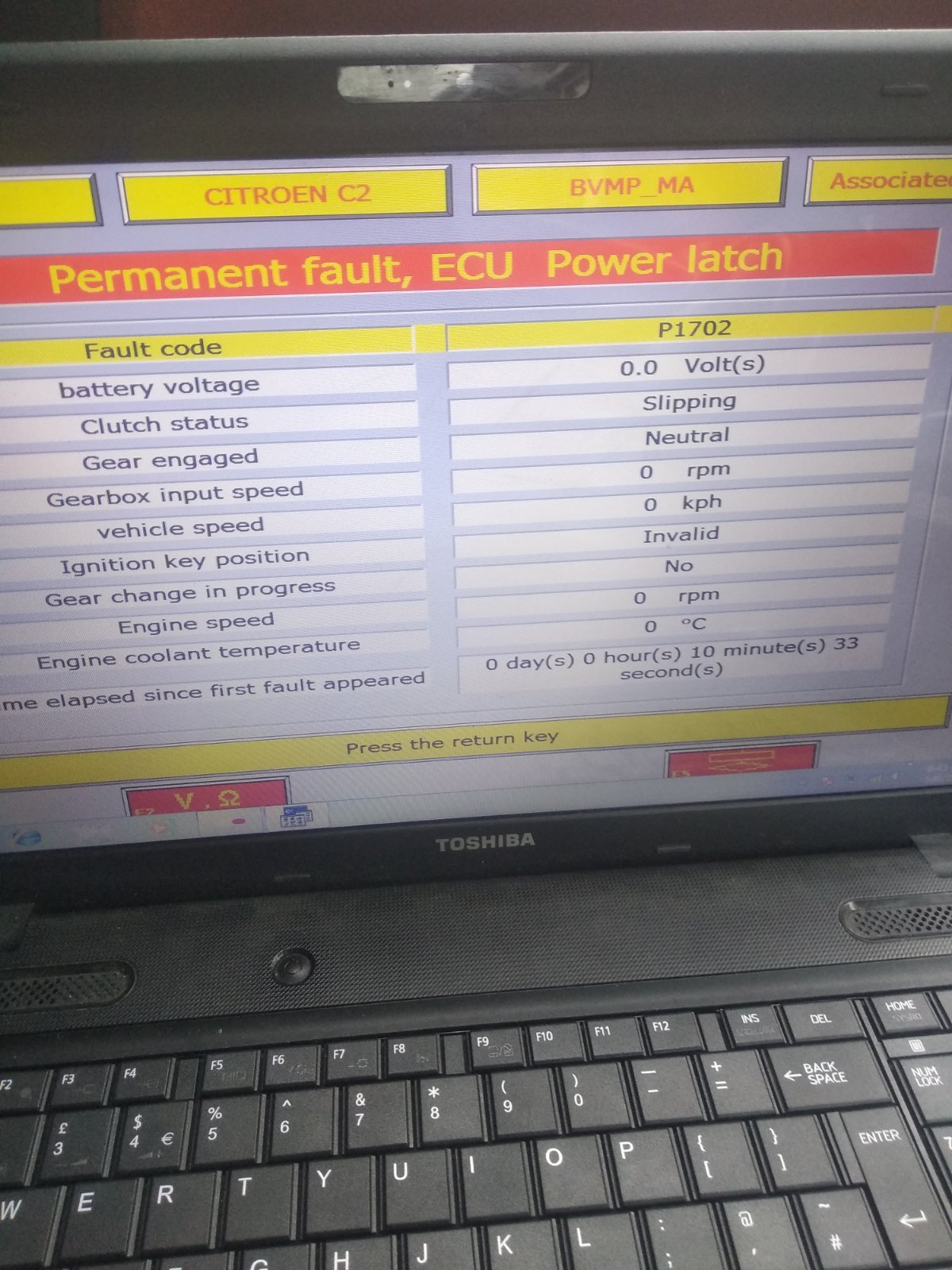

Exactly following procedure but not hellp. But i tried programming clutch acurator and gear box after did me error 1702. ECU Power Latch

You have no main battery voltage to the gearbox.
There is a fuse in the gearbox harness on the gearbox, labeled BMF1. It supplies power to the gearbox ECU directly from the battery. It might be blown. Or there is some problem in that main battery cable connection from the battery to the ECU. If the fuse is blown it is probably an overload from one of the actuators. Possibly a stuck motor or an actuator is jammed.
You have some other odd things there too. Like the ignition key position is invalid and the coolant temperature is 0'C?
The rest of the stuff just shows that the engine was not running at the time.

I have 12 v to ECU GEARBOX. But not have voltage to
GEARBOX acurator.
When I reprogramming Lexia after did my error P1702.
Thanks

LEXIA is reporting that there is no BATTERY voltage at the ECU. And you are not getting any voltage at the actuators.
There are a number of sources of power to the gearbox ECU but there is only 1 source that comes directly from the battery for the high current required by the actuators.
Power to the actuators comes through the ECU. I doubt that the ECU would be capable of cutting power to the actuators. So I would say that the ECU is not getting battery power in the first place.
What fuse are you checking? Have you traced THAT fuse to the battery and to the gearbox ECU connector?
On the 48 pin "green" connector at the gearbox ECU, there should be 1 thick green and yellow wire going to 3 pins of the connector. There should be another similar gauge (but different colour) wire going to another 3 pins of the same connector. That is battery power and ground. You should have 12V between those pins on that connector AT ALL TIMES.
If you do have power at the pins of the connector then check the pins in the receptacle of the ECU. Look for corrosion.
If you do not get 12V between those sets of pins then the fuse is blown or there is a wiring problem.
