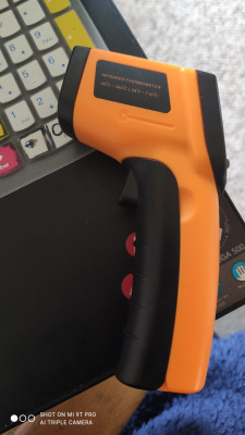

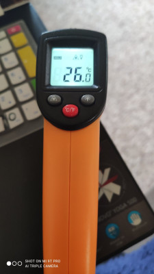

Remember to flush out the radiator and header tank as much as you can. Ideally off the car but as thoroughly as possible. If reaching for the heater hoses is difficult then I would use an infrared spot temperature gun - like the airport temperature readings for covid shown on the telly. These are very localised and accurate. I bought mine to thermal map our house to plan insulation but I have used it on radiators and water pipes. They read the surface temperature of the spot they are aimed at and are not influenced by air temp or other sources of heat

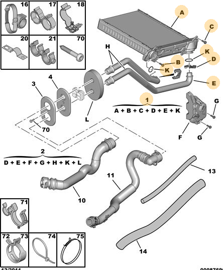

Thanks!GiveMeABreak wrote: 02 May 2021, 20:05Hi DanDanCD wrote: 02 May 2021, 17:00 Hi,
Could anyone give me the part number for the heater matrix of my car? CITROËN C4 II Hatchback 1.6 VTi 120, 2011 reg.
Cheers,
Dan
Part for the Heater Matrix on your C4 is 6448W8. Item (1). It is priced today at £226.21 inc. VAT from Citroen and includes all the items highlighted.
