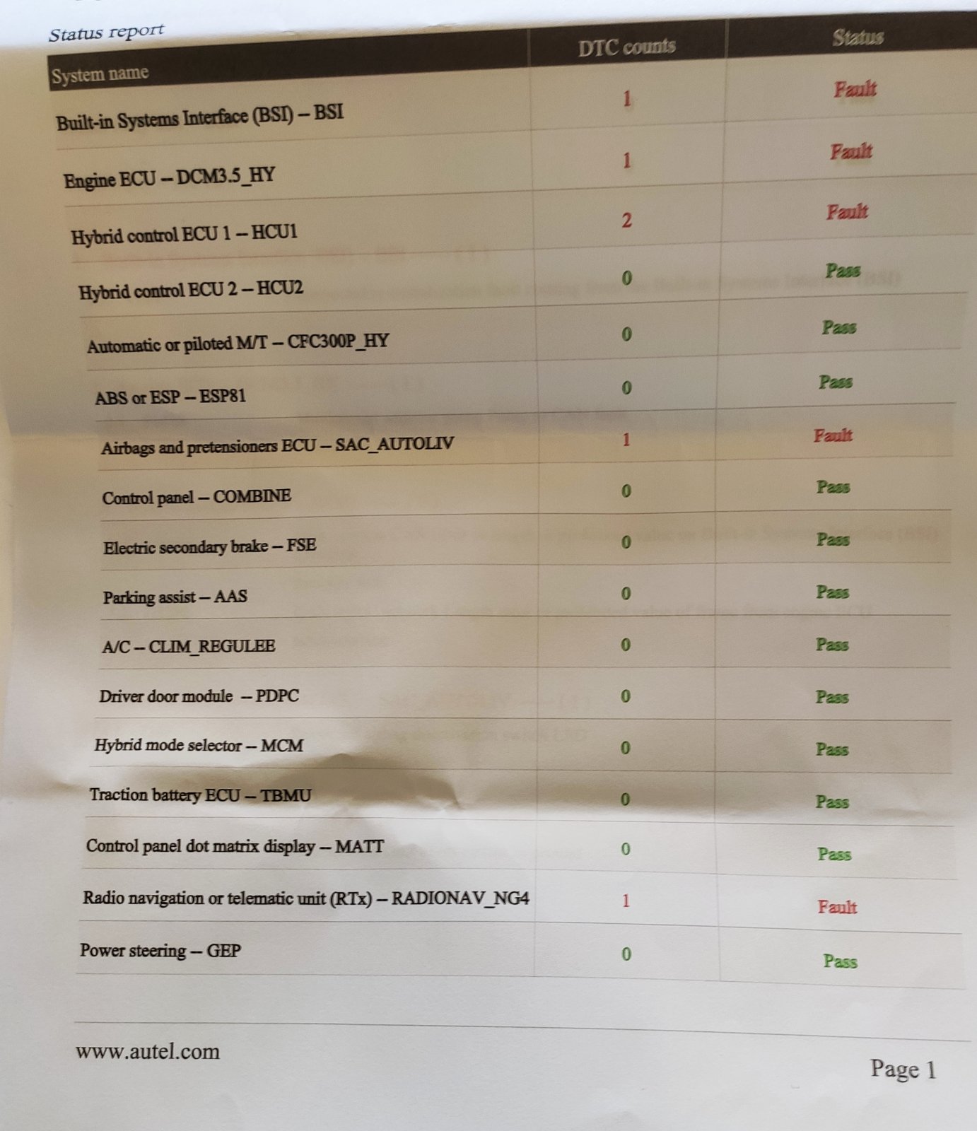

So F5FF is a pretty normal fault to see, more or less comes up every time you disconnect the battery and it does no harm.
The CAN error codes to the HCU are more noteworthy - although I don't have a Hybrid4 myself so I don't know if this is a "known" thing on these cars (in general terms, some PSA CAN/system related codes are ghost codes because of random bugs in the network from time to time).

exactly what I am doing. So far not found any obvious issues. I have had the 12v battery disconnected for over 3 weeks now. I fully charged it then and left it sitting. It had a surface charge voltage of 12.7 v which dropped to 12.55 v when I did the first of two current draw checks. This produced the following - 2.7 a >1.2a > 0.8 a >0.04 a over 85 seconds. After 10 mins it was still drawing 0.04 a at 12.55 v. There were no obvious dash lights. I disconnected the battery again, left it 10 mins and did the current draw at reconnection again for 10 mins. Results - 3.6 a > 2.6 a > 1.3 a > 0.07 a over 95 secs and stayed there for 10 mins, voltage remained at 12.55 v. No obvious dash lights. waited 20 mins and then did a BSI reset making sure the key fob was kept well away from the car until needed. After that the battery was still 12.55 v and went to 14.25 v once engine went into Ready. Took the car to the garage to blow up tyres and air bag light came on and then amber Engine Repair light. Switched off at the garage. On the way home the air bag light came on then the amber Engine Repair light and then the red Engine Repair light followed by limp mode all in 1 1/2 miles (5 mins ). The battery was at 12.6 v when I stopped at home and remained there for an hour. Now I am trying to work my way through the car bit by bit.

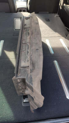

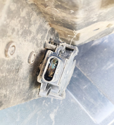

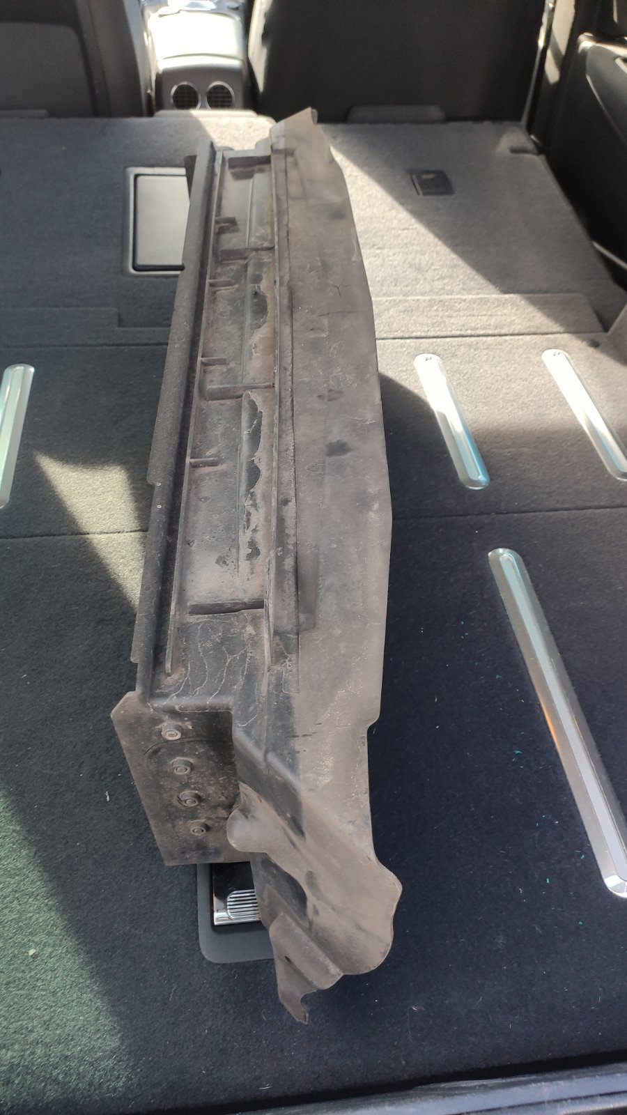

Good news. We have finally tracked a fault on the LIN network to a shutter valve at the front of the engine. Hurrah! Parts on back order - bummer! And to add insult to injury, half the bolts on the front bumper are just spinning and there is NO WAY of getting access without all the gubbins out of the way! Will get the valve fitted and report on progress. Fingers crossed that this gets the Engine Repair/ battery drain sorted in one go.

Here we go! I am going to put up some pictures and update this thread as I run the car to check it is ok.
