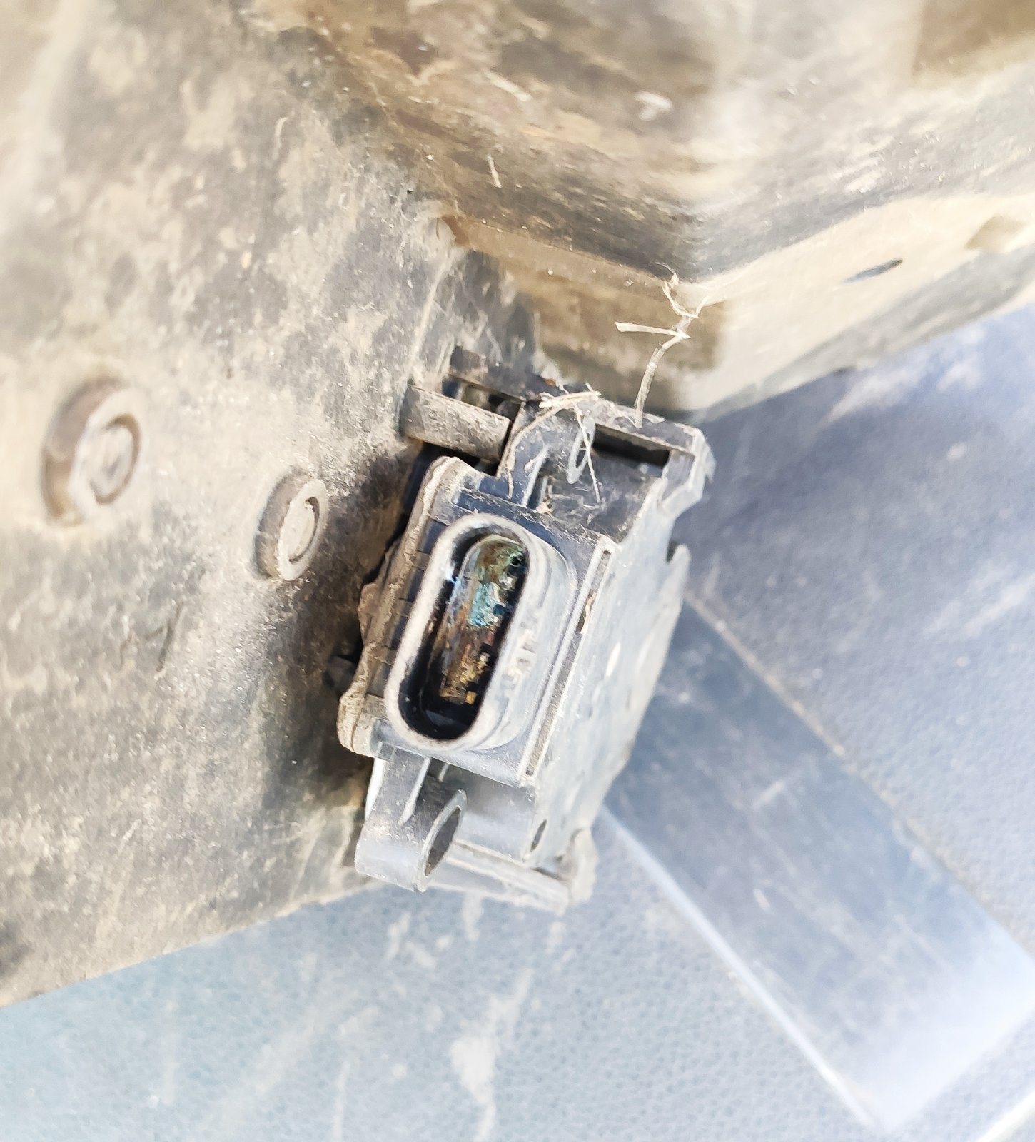

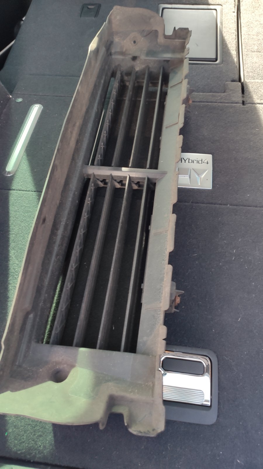

Good news. We have finally tracked a fault on the LIN network to a shutter valve at the front of the engine. Hurrah! Parts on back order - bummer! And to add insult to injury, half the bolts on the front bumper are just spinning and there is NO WAY of getting access without all the gubbins out of the way! Will get the valve fitted and report on progress. Fingers crossed that this gets the Engine Repair/ battery drain sorted in one go.

Just an update on progress. Still no sign of parts from Peugeot and, speaking to others, I am not alone in waiting for parts. Couldn't find any bad earths at the Hybrid Controller but tested, cleaned and retightened it. Same up front. So far I haven't found anything else but until it is all reassembled and check run we won't know. Ho. Hum.

Here we go! I am going to put up some pictures and update this thread as I run the car to check it is ok.
