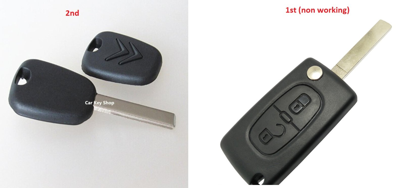

Yes indeed wheeler and ozvtr ... thanks for trying to resolve this, i have no separate electronic within the key shell / housing / case.... everything is soldered on the remote car key.... :/
I didn't try to open the non remote car key that works. And not sure they can clone from a different type of key and also if with all information about the car (car registration documents) a locksmith can re-programmed the transponder.
I have attached a picture of my board and googled ID46 transponder on the web, the kind of tranponder that shows up seems a bit different.
So if I order a virgin clean board to program i would have the same issue regarding programming it.... yeah i will try to go next week to a locksmith and see what they think ... but in my mind a locksmith does key for your appartment, any locking doors or whatever... i was miles away to think that a simple locksmith would have the appropriate tools for car key issue

ozvtr wrote: 17 Apr 2021, 13:42 That's not the coil that I was talking about. That's the antenna (coil) for a PCB transponder. I don't want to make this thread more complicated but you can get keys that have the transponder as part of the circuit board or the transponder is separate.
To my knowledge the genuine keys have a circuit board for the transmitter and a separate ID46 transponder 'chip'. I have only seen the Chinese knock-off keys use the "on PCB" type transponders with the discrete coil. So I don't think your key is original, but....I could be wrong.
Seeing as the second key works (which would have made this thread much shorter if you had mentioned that in the first place :-D ) you can get a new transponder "cloned" and replace the transponder that doesn't work.
A locksmith or auto locksmith can clone a transponder but they need an original transponder (or whole key) that works with your car.
Or you could just take the transponder out of the working key and put it in the non working key. Of course, that wont work if the transponder is soldered onto the circuit board.
I am not sure but I think there is something strange going on here.
I would recommend taking both keys to a locksmith and see if they can sort it out for you.
And no ozvtr i don't think it is a chinese car key copy... my car key seems pretty genuine.... the picture i took is the one that is the closest match to my current board the difference being that I have the chip represented here near the two buttons on top of the board and another smaller chip instead (so two chip on the board) and the quartz is not at the vertical but horizontal.... lol

bebu190 wrote: 17 Apr 2021, 20:26 I didn't try to open the non remote car key that works. And not sure they can clone from a different type of key and also if with all information about the car (car registration documents) a locksmith can re-programmed the transponder.
"different type"? What do you mean by different?
No, the Locksmith reads the (good) key electronically and then makes a copy of that key's transponder. You don't need any documentation, you just need the key that works. Hence the term "cloning" (copy). They should be able to tell you if the transponder is working and if it can be re-programed. Either way, they should be able to give you some sort of solution.
bebu190 wrote: 17 Apr 2021, 20:26 So if I order a virgin clean board to program i would have the same issue regarding programming it.... yeah i will try to go next week to a locksmith and see what they think ... but in my mind a locksmith does key for your appartment, any locking doors or whatever... i was miles away to think that a simple locksmith would have the appropriate tools for car key issue
There is a big difference between a "locksmith" and the guy who cuts keys in the shopping center. You are probably thinking of the people who fix soles of shoes and cut keys, that's not what I'm talking about. Typically a locksmith will have a stand alone store and they only deal with locks and keys, including electronic locks.

Yes I said different type as i have two types of keys see attached (one remote and on non remote) so i don't know if "copying" ones on the chip would work as wheeler also mentioned.
